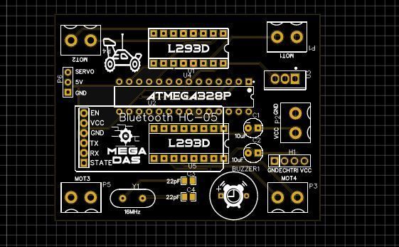

As always guys, I try to pick up some easy projects for the audience so everyone can try it and today’s project is easy as well, based on the 3D printed parts of the SMARS robot which is a small vehicle with two micro motors and there is lots of designs that you can follow to make your own robot, and also about the accessories that you can add to your robot they are many but for our project we will start with the basic design so no much accessories in it, but we will post in the coming videos how to add more features to our small robot.
Moving to the control part, as it show the circuit diagram above, we will use an ATmega328 MCU that you can have from the Arduino UNO board, this MCU is driving the two micro motors through L293 H-bridge driver and as you can see I added two motor drivers so you can use this circuit diagram in case your robot is a four motors robot, also we have a buzzer output a servo motor output control, the Bluetooth connection pins and a ultrasonic sensor input, all these are features that you can play with when you produce the same circuit diagram.
Just one last component is the 5V voltage regulator which is required in here since we are using a 9V battery to power the robot and we need to dorp down the voltage to 5V for the power supply of the MCU and the motors.

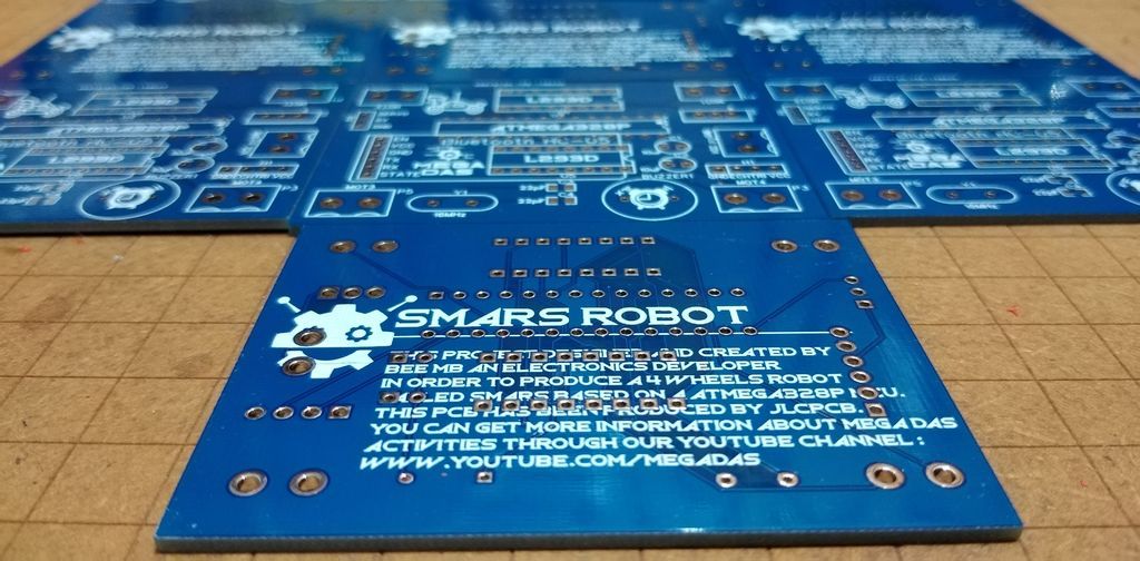

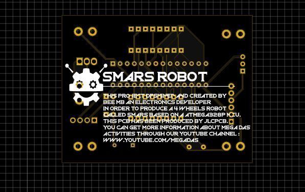

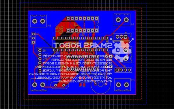

Step 2: PCB Making
PCB Making
PCB Making
PCB Making
PCB Making
PCB Making
PCB Making
About JLCPCB
JLCPCB (Shenzhen JIALICHUANG Electronic Technology Development Co., Ltd.), is the largest PCB prototype enterprise in China and a high-tech manufacturer specializing in quick PCB prototype and small-batch PCB production. With over 10 years of experience in PCB manufacturing, JLCPCB has more than 200,000 customers at home and abroad, with over 8,000 online orders of PCB prototyping and small quantity PCB production per day. The annual production capacity is 200,000 sq.m. for various of 1-layer, 2-layer or multi-layer PCBs. JLC is a professional PCB manufacturer featured of large scale, well equipment, strict management and superior quality.
Talking electronics
After preparing the circuit ,I transformed it into a customized PCB design and the easiest task now is to place the order for the PCBs so I need is to move to JLCPCB the best PCB supplier in order to get the best PCB manufacturing service, as always just some simple clicks that’s all what you need to uploaded the GERBER files of the circuit design then I moved to set some parameters and this time we...
