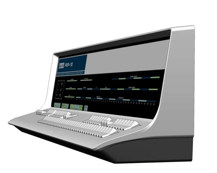

PiDP-10
A replica of the PDP-10 (KA10) mainframe computer
32 bits is not enough, but 64 bits is just silly. The PDP-10 was DEC's fabulous exactly-right 36-bit mainframe (or superultramini, because - definitions). This was the machine that Gates & Allen used to write Basic for the 8080, before they had even touched a real 8080. It was where Hacker Culture grew, emacs was born, and where the debugger could be the CLI. User interface things only went downhill from there.
After the PDP-8 & -11, this will complete my DEC trilogy. It uses the same approach: inside is a Raspberry Pi with simh. Run TOPS-10, TOPS-20 (yes, but), ITS. Play spacewar on the GT340 display; log in over simulated Knight TV terminals, or over the internet thanks to the IMP interface. All work already done by a band of PDP-10 aficionados, I should add: this is just putting a physical form to it: a 36-bit laptop, 21 inches wide, with all the original Blinkenlights.
Project status: the injection mold is being produced now and the kit is planned for August...
This has been a three-year project, as Real Life Interference played up. But it is close to getting done now, and the world really needs more 36-bit mainframe class computers for home use.
But the injection mold design is done, the circuit boards work, and the software, of course, was already working: this has a Raspberry Pi running simh inside.
Before you get interested in the physical machine, have a look at [Lars]'s ITS project and [RCornwell]'s PDP-10 simulators. That's the most interesting bit ;)

    Today the final prototype went through evaluation with the injection mold maker. There are some imperfections in this CNC-cut prototype, but they will be taken care of in the mold. I can't wait for the first samples to come back from the manufacturer. Alas, that will take 8 weeks or so.
    Isn't she pretty? And just wait what this machine can do running ITS!
    So - today was a good day!

    Although I promised myself never, ever, to do an injection mold again, that proved to be inevitable. So here is the CNC-cut prototype that will go into production in the coming weeks:
    Two molds, actually. A bottom, and a top part. To get all of the curves of the original properly made, I ended up needing professional help. The risk of cutting expensive injection molds with mistakes was too high, and 3D modeling the slight oddities of the 1966 original was also a bit beyond my skills.
    New PCBs have been spun to fit precisely in this case:
    126 LEDs, and...
    ... 74 switches. This is a big beast!
