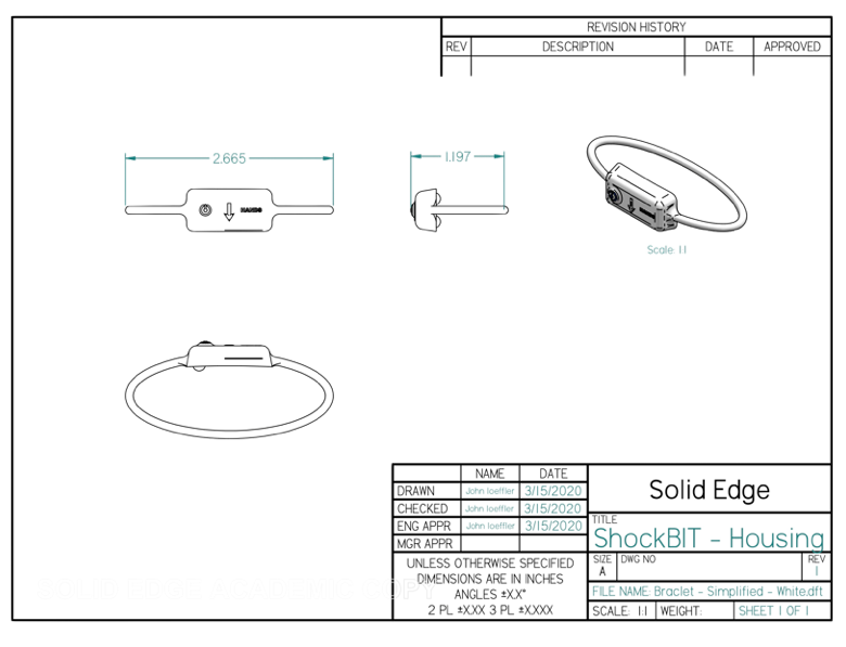

ShockBIT is (2) small disposable electronic devices that attaches to a users wrists and will monitor hand motion and when the hand position is close to face (Above the shoulders) will emit a small, harmless electrical pulses (no more than 1 Second) to that wrist or Vibrational Stimulus.  This electrical pulse or small vibration is intended to silently alert user that their hands are in close proximity to the face.  ShockBIT is design for easy to use user experience to lightly remind users to refrain from unnecessarily touching their mouth, nose, and eyes.
What is ShockBIT:

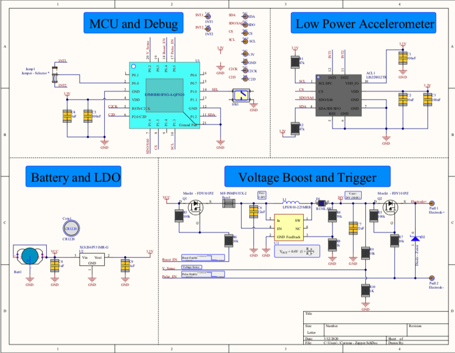

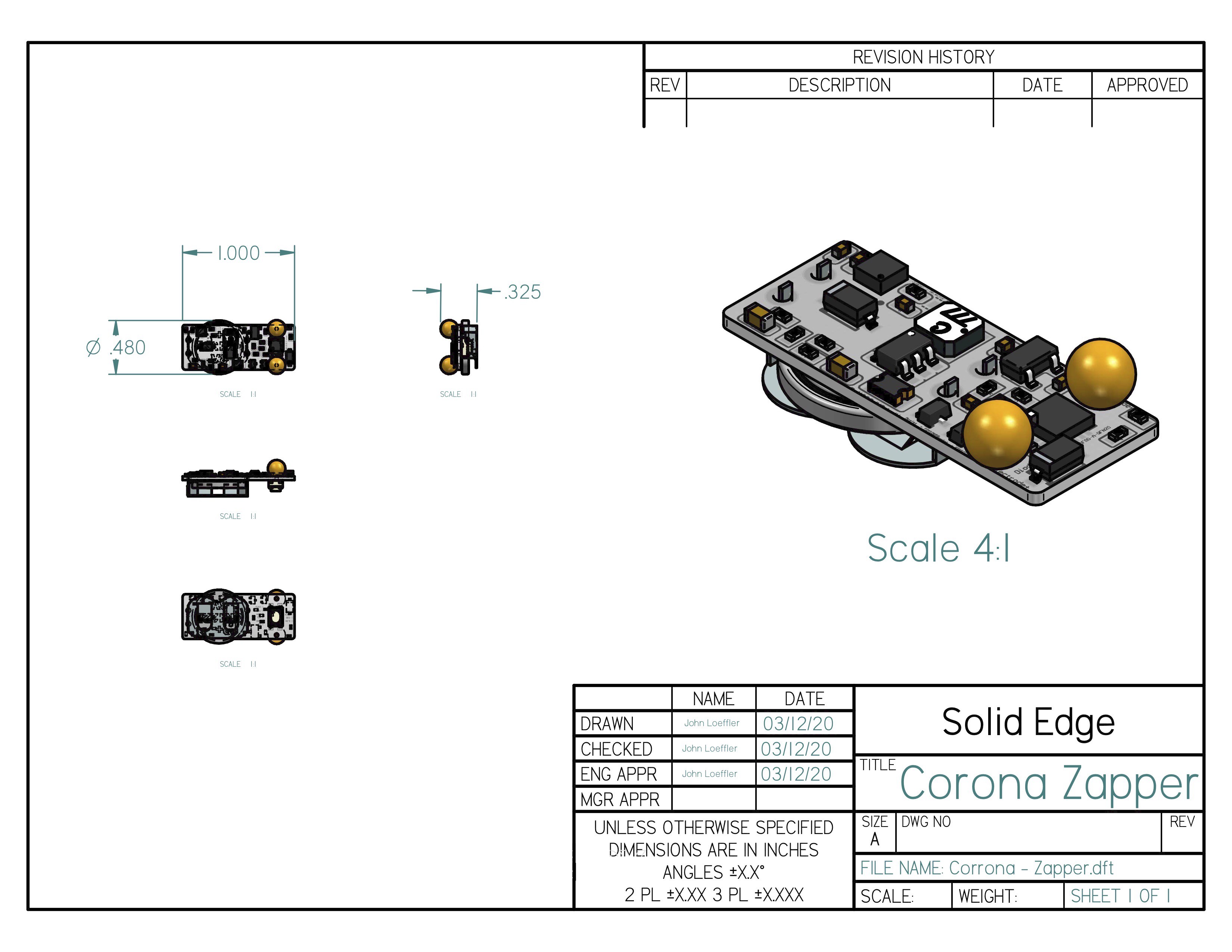

ShockBIT consists of a Silicone band with a pocket that houses the electronic components.  The Electronics are a simple Microcontroller, Coin cell Battery, Button, low power Accelerometer do detect an inversion of the board, and a Boost controller with Copper Electrodes or Vibrational Motor to make contact with the users skin.

ciplionej wrote 04/22/2020 at 22:55 point
Hi John, congrats, very interesting project.
Couple of questions for the uninitiated:
1. Why zap and not vibrate or just beep?
2. From the ST website, it looks like the LIS2DH12TR has programmable features that might allow you to ditch the microcontroller altogether and trip the "alarm" directly from the sensor. Could you trigger the alarm using the programmable decision trees in the IC?
3. Do you think it could be possible to make a thinner, lighter, textile armband with fewer components if 1 and 2 were feasible?
John Loeffler wrote 04/23/2020 at 00:34 point
Hey Fernando,
1) we have tried to us a vibrate,  The thing is it can do this but we would have to use LIR Batteries (Lithium). Normal coin cell battery can only provide 30mA current before the voltage gets to low the MCU shuts down.  Using an electrical pulse draws significantly less current in the 1-2mA range for the same Effect
2)Thanks for that I didn't realize we could use the accelerometer to drive alone by seeing the bits.
3) The goal is to get the components down as much as possible (if we are to scale up this is a giant bottleneck)  so thank you for your suggestion I am looking into it tonight.

amd_athlonxp wrote 04/10/2020 at 23:08 point
What type of microcontroller do you use?
What will be happen if a student pull up his arm to sign to the teacher that he know something?
Are there cases in movement possible where the device makes an error?
John Loeffler wrote 04/16/2020 at 01:05 point
Right now we are using an atmega168. but will migrate to the Attiny
The device will vibrate/electrically pulse when in upward position for a duration of 20ms (Filters out jerks of the hand). it will trigger once when in the upright position and will be less than 200ms vibrational/pulse and will reset when returns to neutral position.
It will trigger if you raise your hand (it will vibrate pulse once). That being said it is early noticeable.  it is no more then the tactile feedback you feel with you cellphone when using twitter or instagram.  It will not prevent you from touching your face,  it is simply there to alert you to unintentional face touching.
