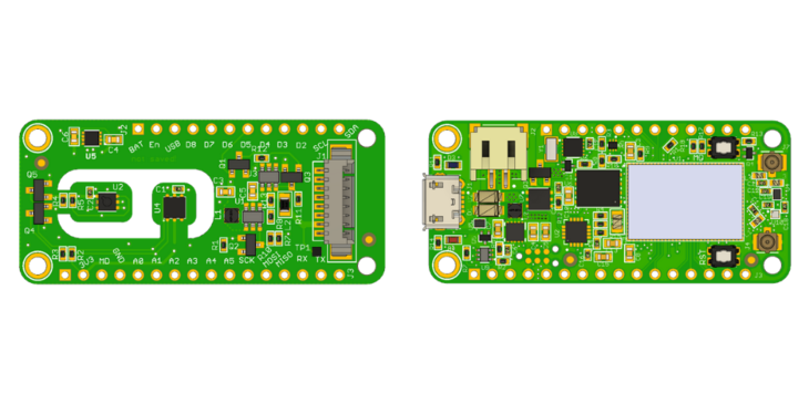

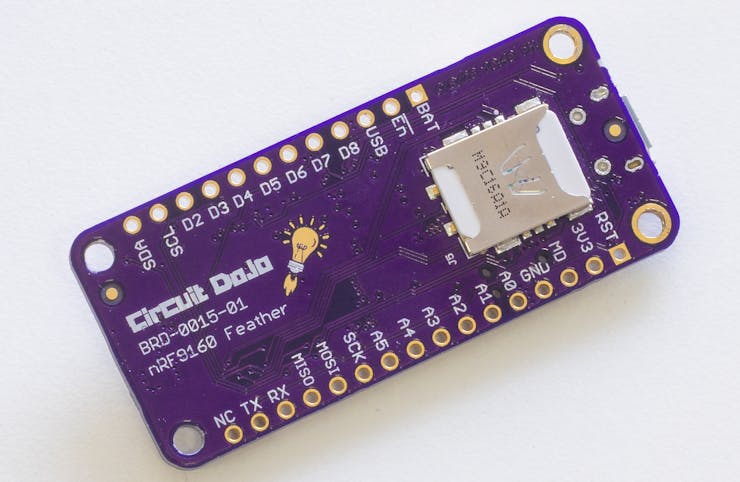

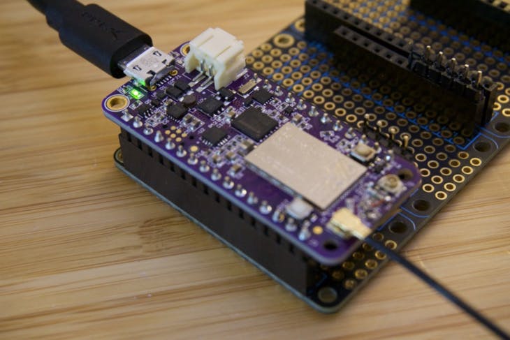

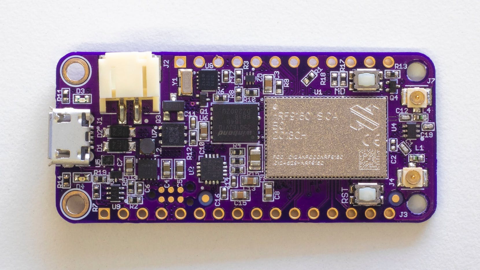

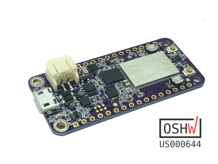

This is The nRF9160 Feather! It's open source and ready for your project!
It's a 4 layer board with some added capabilities built in like:
- Low power RTC mode for extreme sleep
- Onboard NOR Flash
- D7 and charge status LEDs
- Oh, and an onboard linear Li-poly charger as well!
This version supports an external nano SIM. It features a U.FL connector for an external antenna. It's also capable of supporting an active GPS antenna as well!
Diagram
This board can be powered several ways. The most popular way to power Feather boards is by using the USB port. This board is no exception. It works well across both USB and LiPoly batteries.
The board is designed from the ground up to be power efficient at the most used power state: standby. That's right, if you're developing something that's battery powered, your most used state will usually be standby mode. As of this writing the estimated current draw in this state should be about 2µA. That's approximately 8.5 years on a 150mAH cell!
Speaking of power, this board also has a fully fledged DC/DC Buck Boost. That whether your input voltage is 5.5 or 2.8V you'll get a nice stable 3.3V at the output.
This board also sports some external flash for storing your application data. Use it with the built in support for LittleFS in Zephyr. Or, use one of your choice! What ever tickles your fancy.
Finally, but not least, the nRF9160. I've been watching this part very carefully since the CEO had it locked in a mysterious black case years back. It's here and it's real and the module is half the price of other modules. I won't bore you with all the technical details. (Technical details get you excited? Go here.) Needless to say, it's awesome.

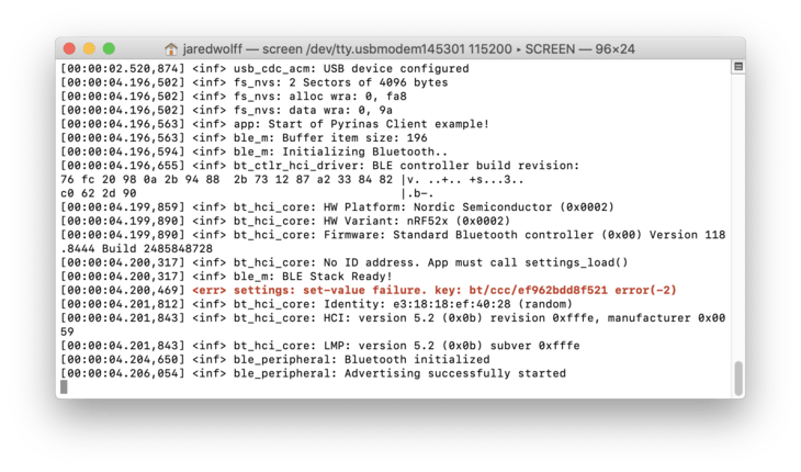

    Does you project have USB? Add a few lines in your prj.conf and voilà, presto change-o, and you have a USB Console!
    Don’t believe me?
    I took a Particle Xenon I was using and got searching through the Zephyr repository. I searched for maybe a minute or two until I found the correct definitions. Fortunately. there were a few other samples in the Zephyr repo that use the same features. That made the search much easier!
    You can add this to nearly any project. Just make sure that your device has USB and that it’s definied in the Device Tree. For now we’ll assume you’re using a nRF52840.
    CONFIG_CONSOLE=y
    CONFIG_USB=y
    CONFIG_USB_DEVICE_STACK=y
    CONFIG_USB_DEVICE_PRODUCT="Xenon"
    CONFIG_USB_UART_CONSOLE=y
    CONFIG_UART_INTERRUPT_DRIVEN=y
    CONFIG_UART_LINE_CTRL=y
    CONFIG_UART_CONSOLE_ON_DEV_NAME="CDC_ACM_0"
    CONFIG_USB_UART_DTR_WAIT=y
    Compiling and flashing is done with these guys:
    west build -b particle_xenon
    west flash
    Then, when I plug in and start the session using screen I get some nice output:
    Things don’t always go as planned though.
    The CONFIG_USB_UART_DTR_WAIT does lock the processor from executing until the shell session has been opened. The peripheral doesn’t show up otherwise. (not exactly sure why…)
    With the above being said, the Zephyr stack is fraught with hidden APIs and documentation that is sorely lacking in some areas. Even the features I found above area not in the official Zephyr documention. You should be prepared to hit some potholes as you go along. (I’ve been hitting them for the past few weeks if that gives you any indication!)
    Fortunately, Nordic has been leading the charge in making sure that anything related to Nordic devices is as stable as possible.

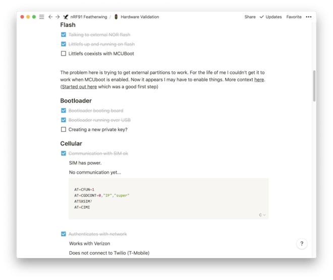

    The most important sample that I had found in the nrf directory was the at_client firmware. (under ncs/nrf/samples/nrf9160/at_client)Along with nRF Connect (for Desktop), it makes a potent combo for debugging. Plus it’s a great tool for surveying your current area for M1/NB1 service.
    For me, it was a great tool to make sure that the nRF9160 Feather was working a-ok. The only change I had to make was to the prj.conf file. I added a section that allows you to set the PDP context (i.e. set the APN)
    # Set the PDP context
    CONFIG_LTE_LINK_CONTROL=y
    CONFIG_LTE_PDP_CMD=y
    CONFIG_LTE_PDP_CONTEXT="0,\"IP\",\"hologram\""
    In my case, I was testing holigram. Their APN is also named holigram. For other providers, like Twilio, theirs is different. Twillio’s “Super” SIM uses super. Their standard wireless service is wireless.twilio.com. In some cases, like AT&T and Verizon, you do not have to set the APN. It’s set for you by the modem firmware.
    Building and flashing the firmware is a breeze. Here’s what it looked like on my end:
    west build -b circuitdojo_feather_nrf9160_ns
    west flash && nrfjprog -r
    Then opening up the serial console, as I talked about previously and typing in AT. You should get an OK back. Disconnect from the terminal though, the LTE Link Monitor will need it!
    Nordic’s LTE Link Monitor
    You use the Link Monitor to connect directly to the at_client firmware. You can either enter AT codes manually or have the Link Monitor run through them. As of this writing though, the LTE Monitor does not support connections that do not have flow control!
    Oh but I didn’t know that going into it. After a few hours of debugging, and posting to Devzone I found my answer. The ModemPort library, used in LTE Link Monitor, initializes with rtscts support always on.
    Not great for non-flow control boards, right?
    Fortunately, rebuilding with rstcts to false fixed things. That wasn’t a piece of cake though.
    There was yet another set of problemsthat turned me intro a giant stress ball. Fortunately changing some of the dependencies in package.json seemed to fix it!
    After that, I was off to the races!

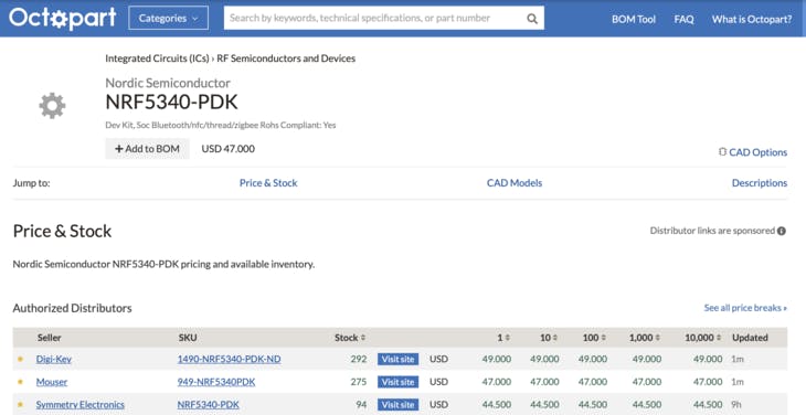

    Nordic nRF53-PDK or nRF9160-DK. I recommend the nRF53-PDK as it’s significantly cheaper! Plus, if you’re only using it as a programmer you don’t need all the extra functionality the nRF9160 board has.
    Here’s a list of all the places you can get one from.
    Digikey, Mouser and Symmetry are good choices if you’re in the USA. Digikey hands down will ship the fastest but they’re usually the most expensive!
    I ordered mine from Symmetry and it took about a week to arrive via First Class Mail.

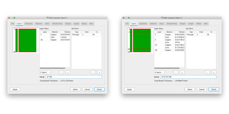

    Thanks to OSH Park’s fab design constraints, I didn’t have to think much about the stack up. The important thing is that you’ll want to use what ever your board house deems “standard”. Don’t thinking about it too much though, or you may get lost in the list of what they can do. (OSH Park has a similar list but it’s much more concise. We’re not building rockets here.. or are we?)
    Here’s what a standard stack up looks like for both OSH Parks 4 and 2 layer .ulp files. You can get them here if you’re interested in a good starting point for your own designs!
    images/Stackup_Side_by_Side.png
