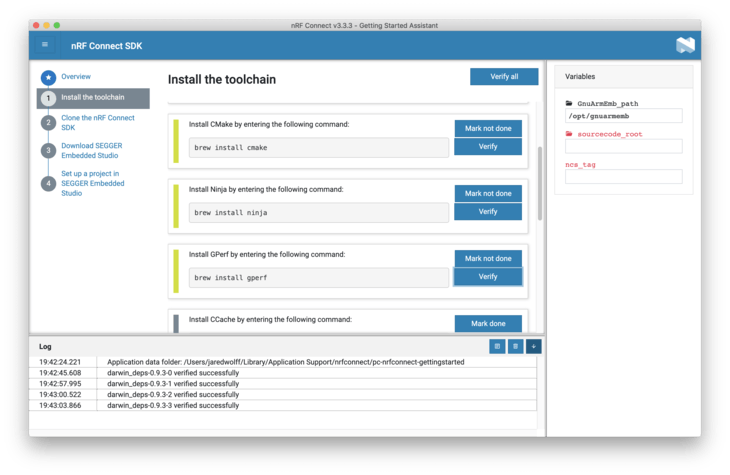

Setting up the environment
To get started, Nordic has documentation located here. I’m on OSX so Nordic recommends to use the “Getting Started Assistant” in nRF Connect for Desktop.
The advantage of the Getting Started Assistant is that it’s more interactive. You’ll likely need it since there are a ton of 3rd party tools to install. So the original Nordic SDK still wins in that department for sure!
Slowly making my way through the steps..
Most of it is painless. In many cases if you’re an active firmware dev you’ll have these tools installed already.

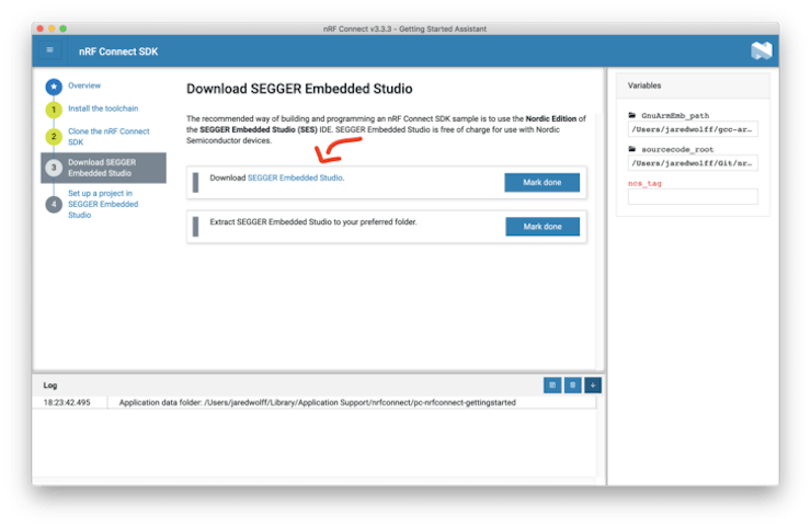

Installing the IDE (Don’t hurt your eyes)

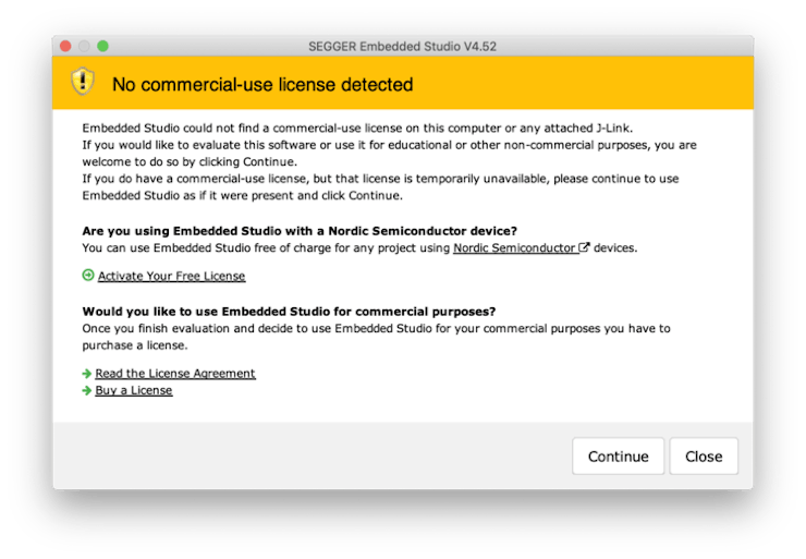

As a getting started step, Nordic states that Segger Embedded Studio is “required”. I’m not a big fan of these types of IDEs. It locks you into yet another development environment you need to learn etc. I’m big on Visual Studio Code and use it for all the coding I do whether it’s C/C++/Rust/Go/Javascript etc.
You can download from the link they provide in the Getting Started Assistant:
Once downloaded, you can unzip and then copy arm_segger_embedded_studio_v452_macos_x64_nordic (or similar) to your Applications folder. (Or wherever you want!)
Then navigate to it and and run SEGGER Embedded Studio for Arm. The instructions have some more info about how to handle the warning below. As long as you follow the instructions you’ll be golden!
After navigating the interface though, all I wanted to do was barf on my keyboard. The interface is atrocious. (Sorry Segger/Arm!) I’ll be focusing on using Visual Code and the command line for the rest of this tutorial. Nordic only supports Segger so don’t expect any help if you go outside the box!

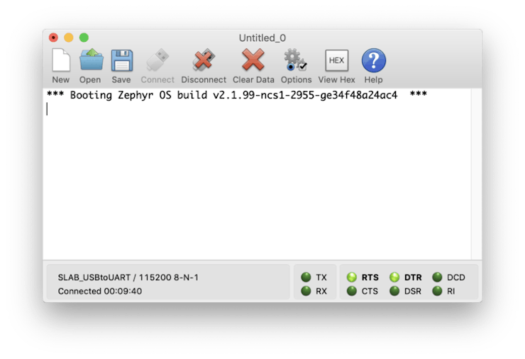

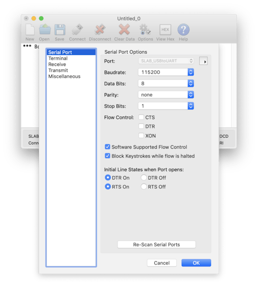

The nRF9160 Feather also comes with a USB to Serial chip by Silicon Labs. On OSX it shows up as SLAB_USBtoUART. (You may need to install drivers for your operating system.)
Here’s an example of what it looks like using Cool Term.
After running nrfjprog -r i also checked to make sure that there was UART output.
Success a blinking LED and a boot message coming over UART to the Silicon Labs chip!

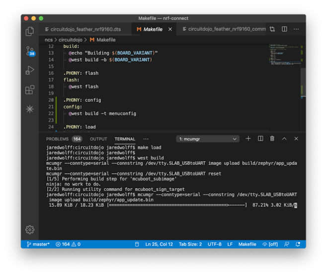

Then to update over serial you can run mcumgr with similar arguments.
west build
mcumgr --conntype=serial --connstring /dev/tty.SLAB_USBtoUART image upload build/zephyr/app_update.bin
mcumgr --conntype=serial --connstring /dev/tty.SLAB_USBtoUART reset
Remember to replace /dev/tty.SLAB_USBtoUART with your serial port. build/zephyr/app_update.bin should stay the same.
Shortly after I got a blinking LED and a Hello World message over serial (after I reconnected using Cool Term). Now we’re cooking with gas!

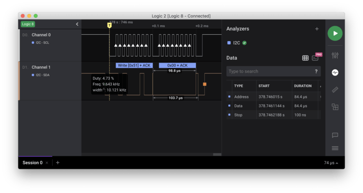

One thing I like to do is make sure that all peripherals are working as expected. Some things can be tested without firmware (like the charger). Some require some firmware intervention. For example, setting up I2C + the RTC looks something like this in Zephyr:
	 * Set up I2C
	struct device *i2c_dev;
	i2c_dev = device_get_binding("I2C_2");
	if (!i2c_dev)
		printk("I2C: Device driver not found.\n");
		return;
	// Configuration
	u32_t i2c_cfg = I2C_SPEED_SET(I2C_SPEED_STANDARD) | I2C_MODE_MASTER;
	if (i2c_configure(i2c_dev, i2c_cfg))
		printk("I2C: config failed\n");
		return;
	// Write a test command and check for ACK
	uint8_t buf[] = {0};
	ret = i2c_write(i2c_dev, buf, sizeof(buf), PCF8506_I2C_ADDR);
	if (ret < 0)
		printk("I2C: Unable to communicate with RTC.\n");
		return;
In order to use I2C, make sure that this is in your prj.conf:
CONFIG_I2C=y
CONFIG_I2C_2=y
The nRF9160 uses “I2C2” peripheral as this is default for the development kit. You should keep this the same for now.
I ran another west build and loaded the app over using mcumgr.
Hooking up my Saleae, I got a nice result after loading and resetting the device:
For some reason 0 byte transfers don’t work. But that’s ok. Sending some dummy data works just as well!
