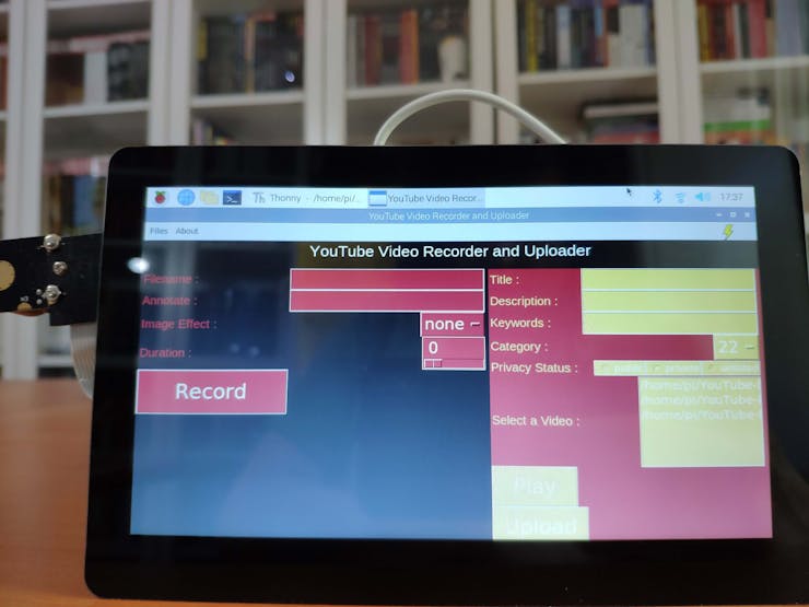

Thus, I contemplated a GUI by which I could adjust the video recording settings and define the parameters to upload videos to YouTube without signing to my YouTube channel on the browser every time. After some research, I decided to use the Google APIs Client Library for Python to communicate with my YouTube channel through the YouTube Data API. In the end, I developed a GUI (YouTube Video Recorder and Uploader) in Python, including two interfaces - Record menu and Upload menu.
In the Record menu:
You can define filename (timestamp included automatically), annotation text (if required), the video duration, and select an image effect (predefined by the GUI, for instance, negative).
In the Upload menu:
You can upload the selected video to YouTube via the YouTube Data API without any further steps by merely entering the required parameters by YouTube - Title, Description, Keywords, Category, and Privacy Status.
You can find detailed information about the features of the GUI (YouTube Video Recorder and Uploader) in the Features.

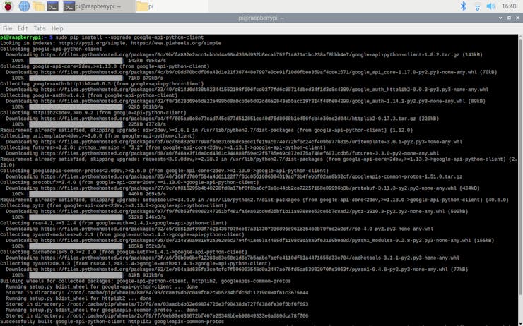

Step 2: Installing the Google APIs Client Library for Python on Raspberry Pi
Open the terminal and enter the command below (it will take some time to install all packages):
$ sudo pip install --upgrade google-api-python-client
