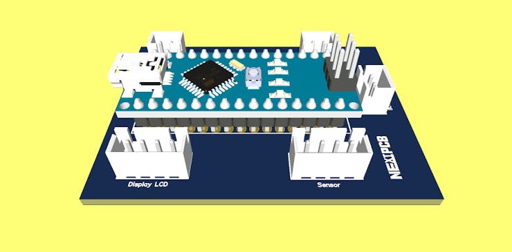

Based on this, you will develop a NEXTPCB Thermometer using an MLX 90614 infrared sensor with an Arduino Nano. This system will consist of an OLED display to show the temperature value and a button to activate or not the sensor reading.
In addition, we will have a blue led to indicate when the system is on and a red led to indicate when the temperature is above 39 ºC.

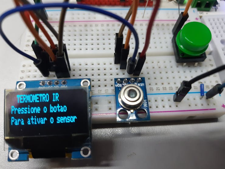

In figure 1, it is possible to see the circuit mounted on the protoboard to perform the system tests.
Figure 1 - Screen to start reading the temperature value.
The following message appears in Portuguese on the screen "IR Thermometer - Press the button to activate the sensor".
To activate the temperature reading, you need to press the green button.

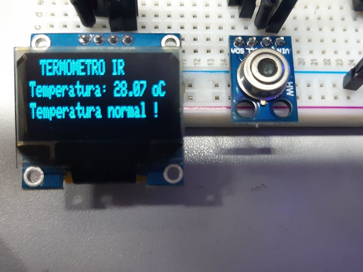

After pressing, the system is activated and the blue LED lights up as shown in figure 2.
1 / 2
In the OLED display in figure 2, the following message appears in Portuguese "IR Thermometer - Temperature: 28.07 and Normal Temperature!".
In addition to displaying the temperature value, this system displays a message indicating whether the temperature is normal or if she needs to see a doctor. This can be seen in figure 3.

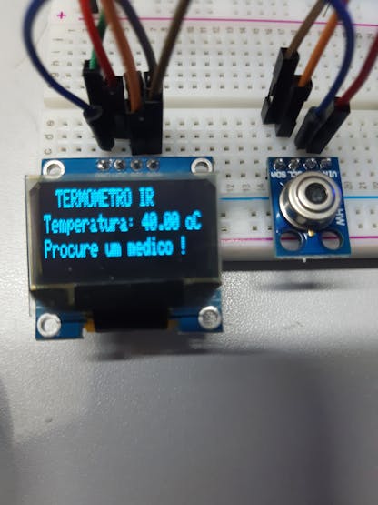

Figure 3 - System on and temperature above 39º C.
1 / 2 • Figure 3 - System on and temperature above 39º C.
The figure above shows the following message in Portuguese "IR Thermometer - Temperature: 40.00oC and Find a doctor!"
In the figure, the system detected a temperature above 39 ºC and therefore displayed the message: Look for a doctor and switched on the red alert LED.

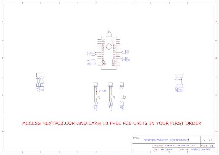

Below, we present the electronic schematic for you to assemble this project on the protoboard.

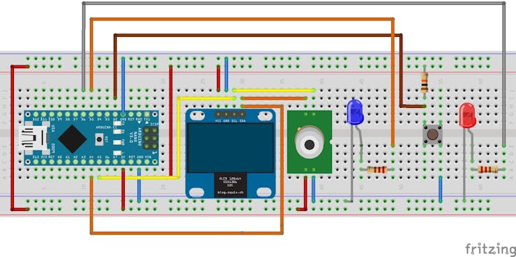

To assemble the device, we need to assemble the circuit on the protoboard as shown in figure 4.
Both the OLED display and the MLX 90614 temperature sensor uses I2C communication to communicate with the Arduino Nano.
I2C Communication
I2C communication - is a communication protocol developed by the company Philips that uses only two wires to carry out the communication between devices (SDA- Serial data line and SCL - Serial clock line).
In our project, two components use this communication: the OLED display and the MLX 90614 sensor.
The Arduino Nano has two specific pins to use this communication, which are the A4 - SDA pins and the A5 SCL pin.
Therefore, we must connect the SDA pins of the OLED display and the sensor to the A4 pin of the Arduino Nano and the SCL pin of both components to the A5 pin of the Arduino Nano.
On the VCC pin of the display and the MLX sensor, we supply 5 V of the Arduino Nano.
And the GND pin of the display and the MLX sensor to the Arduino GND.
To activate the MLX 90614 sensor, we are using a button connected to Arduino digital input 2, this button will be activated at logic level 0.
Thus, we need to place a 10 KΩ pull-up resistor on digital input 2 so that this input does not float when the button is not pressed.
To signal when the sensor is making measurements, we use a blue LED connected to digital output 5 of the Arduino Nano.
To limit the current of the led, a 220 Ω resistor was used.
When the temperature is above 39 ºC, a message will appear on the display and the red LED (connected to digital output 6 of the Arduino Nano) will be accessed to indicate an alert.
To limit the current of the red led, a 220 Ω resistor was used.

First, we check if the button was pressed or not, if it is not pressed we display the following message:
display.clearDisplay();
display.setCursor(10, 0); // Posiciona o cursor
display.setTextSize(1); // Define tamanho da fonte
display.print("TERMOMETRO IR ");
display.setCursor(0, 10); // Posiciona o cursor
display.print("Pressione o botao");
display.setCursor(0, 20);
display.print("Para ativar o sensor");
display.display();
display.clearDisplay(); - função para limpar o display
Whenever we write something on the display we must use the command display.display (); to update the display.
Pressing the button activates the flag en_sensor with the value 1. Thus, if en_sensor is equal at 1, the program will enter the condition below.

The temperature.object () command reads the temperature of the object. The temperature.ambient command reads the ambient temperature.
After taking the temperature measurement, we check if the value is greater than 39ºC. If it is true, we will activate the red LED. The code is presented below.
if(media_temp >39 )
display.setCursor(0, 20); // Posiciona o cursor
display.print("Procure um medico !" );
digitalWrite(led_vermelho,1);
else
display.print("Temperatura normal !" );
digitalWrite(led_vermelho,0);
display.display();
In addition, we have developed an electronic board with NEXTPCB Printed Circuit Board. This board will allow you to assemble this prototype and use it in your projects.
NEXTPCB Printed Circuit Board Project
In the figure below we present the project's prototype in its 3D version.
This project was developed from the following electronic schematic.
Finally, we finish this project and you can download the Gerber files and obtain your 10 PCBs in NEXTPCB.COM. The link to download is: Gerber files download
