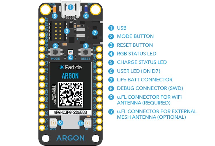

1. The Handheld Device:
This is the main part of the whole project as this is the component that will connect the user and the whole system. This is powered by a Particle Xenon, a mesh device that has the capability of creating local mesh networks to which a Xenon can connect.
Particle Argon.
Now this small but powerful board will have several peripherals connected to it, which will include :

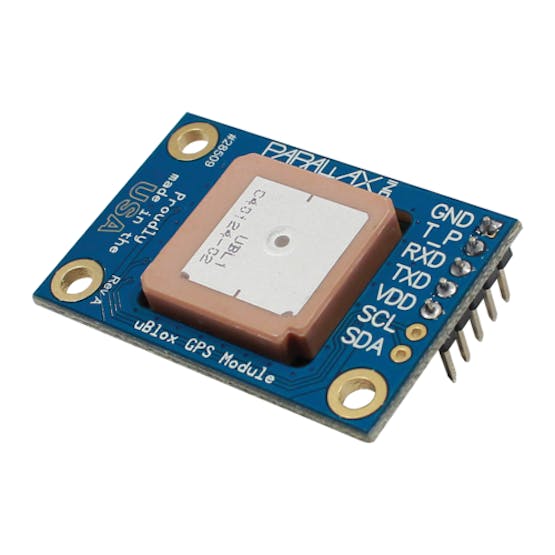

- A GPS module for the real-time location for the android app

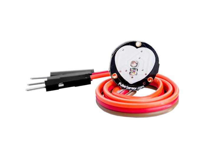

- An optional Heart Rate sensor for constant Heart rate monitoring of the user along with blood oxygen levels of the user.

Image 2 - GPS Module
Image 3 - Heart Rate Sensor

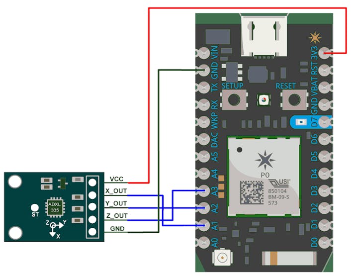

1. For Accelerometer Interfacing: This is the generic or normal sensor interfacing code.
This is for photon, but connections are same for an argon device too.
Code:
#include <math.h>
const int x_out = A1; /* connect x_out of module to A1 of Particle Photon board */
const int y_out = A2; /* connect y_out of module to A2 of Particle Photon board */
const int z_out = A3; /* connect z_out of module to A3 of Particle Photon board */
void setup()
Serial.begin(9600);
void loop()
int x_adc_value, y_adc_value, z_adc_value;
double x_g_value, y_g_value, z_g_value;
double roll, pitch, yaw;
x_adc_value = analogRead(x_out); /* Digital value of voltage on x_out pin */
y_adc_value = analogRead(y_out); /* Digital value of voltage on y_out pin */
z_adc_value = analogRead(z_out); /* Digital value of voltage on z_out pin */
Serial.print("x = ");
Serial.print(x_adc_value);
Serial.print("\t\t");
Serial.print("y = ");
Serial.print(y_adc_value);
Serial.print("z = ");
Serial.print(z_adc_value);
Serial.print("\t\t"); //delay(100);
x_g_value = ( ( ( (double)(x_adc_value * 3.3)/4095) - 1.65 ) / 0.330 ); /* Acceleration in x-direction in g units */
y_g_value = ( ( ( (double)(y_adc_value * 3.3)/4095) - 1.65 ) / 0.330 ); /* Acceleration in y-direction in g units */
z_g_value = ( ( ( (double)(z_adc_value * 3.3)/4095) - 1.80 ) / 0.330 ); /* Acceleration in z-direction in g units */
roll = ( ( (atan2(y_g_value,z_g_value) * 180) / 3.14 ) + 180 ); /* Formula for roll */ pitch = ( ( (atan2(z_g_value,x_g_value) * 180) / 3.14 ) + 180 ); /* Formula for pitch */
Serial.print("Roll = ");
Serial.print(roll);
Serial.print("\t");
Serial.print("Pitch = ");
Serial.print(pitch);
Serial.print("\n\n");
delay(1000);
2.GPS Module Interfacing
Here, is the interfacing diagram and code for connecting a GPS module to the Argon.
Code:

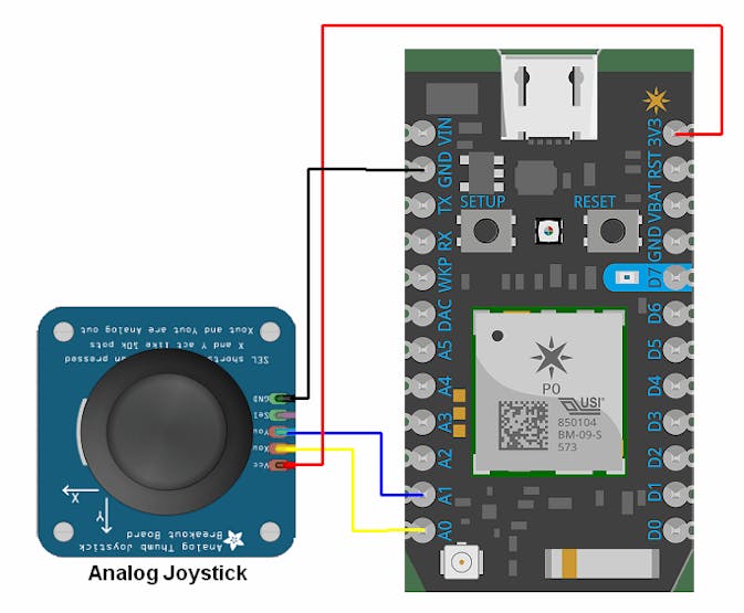

3.Analog Joystick Interfacing
This can be used to control the movement of the medicine table during the motion mode of the device as an alternative to the accelerometer.
Code:
const int joystick_x_pin = A0;
const int joystick_y_pin = A1;
void setup()
Serial.begin(9600); /* Define baud rate for serial communication */
void loop()
int x_adc_val, y_adc_val;
float x_volt, y_volt;
x_adc_val = analogRead(joystick_x_pin);
y_adc_val = analogRead(joystick_y_pin);
x_volt = ( ( x_adc_val * 3.3 ) / 4095); /*Convert digital value to voltage */
y_volt = ( ( y_adc_val * 3.3 ) / 4095 ); /*Convert digital value to voltage */ Serial.print("X_Voltage = ");
Serial.print(x_volt);
Serial.print("\t");
Serial.print("Y_Voltage = ");
Serial.println(y_volt);
delay(100);

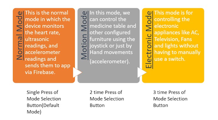

Now, we will discuss the modes of operation that the device will be programmed for. There will be 3 basic modes and the control will be possible using the various buttons given on the Handheld device.
The Operating Modes:
These are the operating modes
1. Normal Mode:
- This is the normal mode in which the device monitors the heart rate, ultrasonic readings, and accelerometer readings and sends them to the app via Firebase.
- This is the default mode.
- In this mode, all the sensors are operational and we can view the data on the Display.
- It can be activated by a single press of the dedicated Mode Selection Button.
2. Motion Mode:
- This Mode can be activated a pressing the mode selection button 2 times.
- In this mode, we can control the medicine table and other configured furniture using the joystick or just by Hand movements using the readings of the on-chip accelerometer.
- This is basically for controlling the "smart furniture" equipped with wheels and a system controlled by the Particle Xenon.
3. Electronic Mode:
- This Mode can be activated a pressing the mode selection button 3 times.
- This mode is for controlling the electronic appliances like AC, Television, Fans, and lights without having to manually use a switch.
- The controlling part is done a system of relays connected to the Particle Xenon, which is the brain of this sub-system.
Hence, this is the Handheld system, the main component of the system which will help the person with the disability to gain control of the devices and equipment around him.

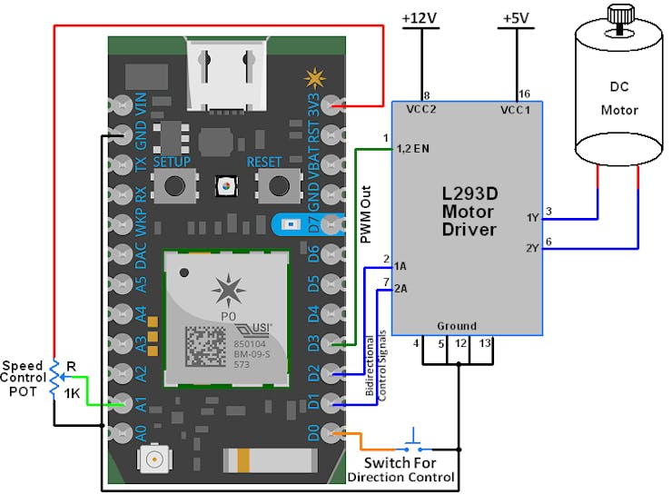

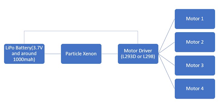

So, here is a schematic diagram of the system.
Flow Diagram Schematic
This system takes in the input from the Argon on the user's hand via the mesh network, converts it to movement codes using the Xenon and controls the motors accordingly using the motor driver board.
Now, let's get into some interfacing and coding, the fun part!!
Coding and Interfacing
Please note that all the interfacing diagrams are shown for photon as the Fritzing software doesn't have the Argon board for schematic drawings. But, the procedure would be the same for Argon or Xenon.
Motor Driver interfacing
Code:
const int pot_input = A1;
bool d1 = HIGH;
bool d2 = LOW;
void setup()
pinMode(1, OUTPUT); /* Motor control pin 1 */
pinMode(2, OUTPUT); /* Motor control pin 2 */
pinMode(3, OUTPUT); /* PWM pin for Speed Control */
pinMode(0, INPUT_PULLUP); /* Interrupt pin for direction control */
attachInterrupt(2, motor, FALLING); /* Interrupt on falling edge on pin 2 */
void loop()
int pwm_adc;
pwm_adc = analogRead(A1); /* Input from Potentiometer for speed control */
digitalWrite(1,d1);
digitalWrite(2,d2);
analogWrite(3, pwm_adc / 16);
void motor()
d1 = !d1;
d2 = !d2;
delay(200);
This code will control the speed and rotational direction of the DC motor using Particle Xenon. We can implement the same, the only change will be that we will take the analog input data of the joystick and change the direction accordingly.

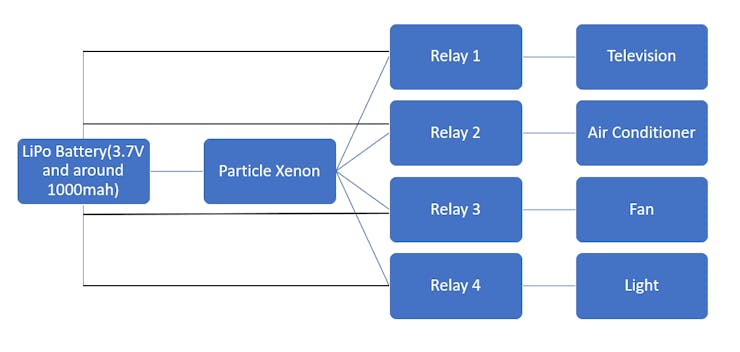

3. The Electronic Appliance Control System
This is the 3rd sub-system which will be controlling all the electronic AC equipment in the system. This will be deployed on each house switchboard so that we can control the devices with the help of our handheld device.
For this, we will have a Xenon in this system too, which will be connected to our Argon via the mesh network. To know more about the particle mesh networks, just visit this Hackster project made by Arduino "Having 11" guy.
This will have a very similar schematic flow chart to the above system.
System Schematic Flow Chart
Now, this system works as follows:
1. When the handheld device goes to electronic mode, it is connected to this system via the mesh network.
2. Now, the display on the handheld device shows the status of certain devices that are a part of the network, along with their current status.
3. There are 2 buttons on the handheld device, one for appliance selection and the other for status change. So, just using 3-4 buttons on the device, we can control a number of devices.
To know more about relay and relay control, just follow this article which explains the interfacing of relays with particle devices.

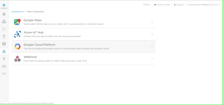

Integrations through the Particle console
The only thing to do is to create a simple web hook that will help you connect to firebase easily through MQTT.
Full step by step tutorial for particle device connection to firebase is given here, which is developed by rickkas7, an active particle community member and a particle device expert.

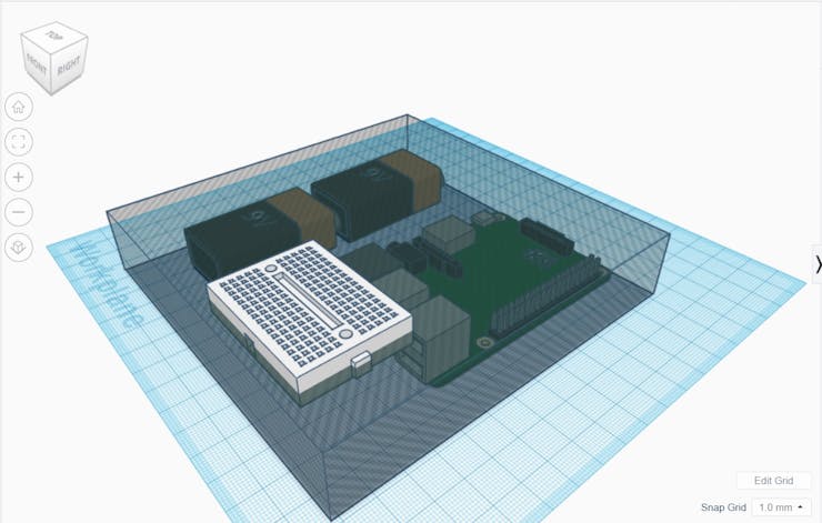

Design
Now, this is a very important aspect of any complete project. Now, designing is a rather difficult job for me as I have very little experience in that field. But, I will give some rough designs for all the sub-systems. So, for the Electronic and Furniture sub-systems, I will be using a Block design, which will be something like this:
only a lot smaller in size, like a cube
Now, coming to the handheld device, I have already developed a similar type of device for Blind people so I will just make some modifications in it and use the same design.
Now, in this device itself, I will add a module similar to the Home Manager, a project developed by one of my fellow Hacksterer, Balaz Simon. Thank you to him for that wonderful and compact design. The only change would be the use of Particle Argon (probably headless) instead of the Maxim board that he used.
I am currently working on this design only so that I can fit the whole system in this enclosure itself.
So, this wraps us the Design part too!
Please view the final design prototype images in the top section.
