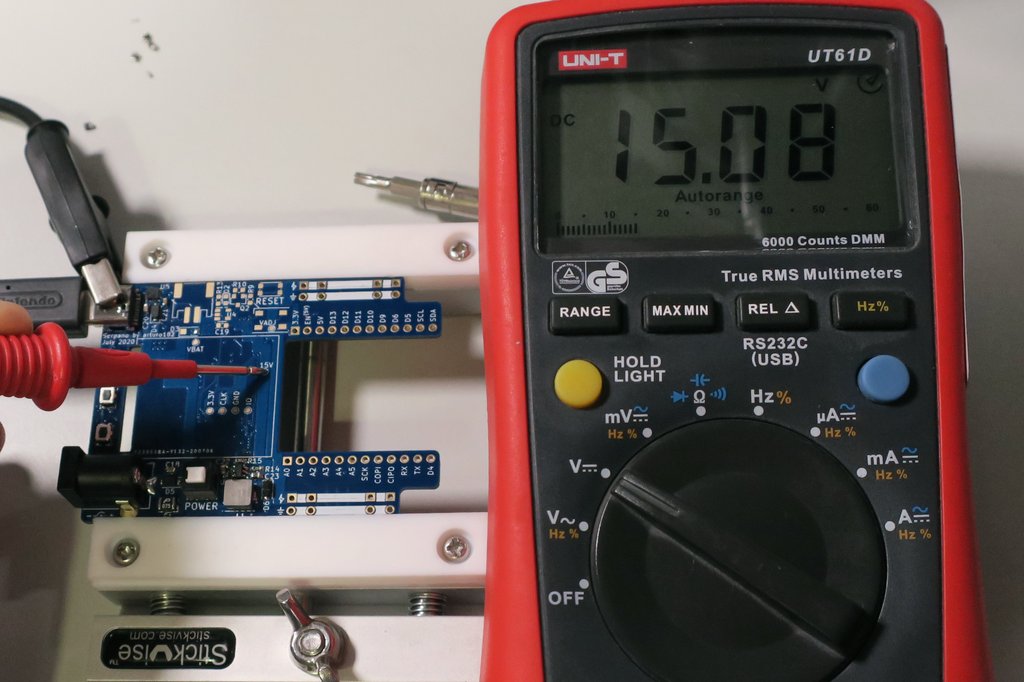

So during the second stream I soldered and tried to get the DC-DC Buck working, but no luck, I was getting strange voltages and it was all over the place, I'm still not 100% sure what went wrong, I will have to debug it a bit more.
However, after the stream I went ahead and soldered another board with minimum components, just the ones that were required to get the circuit going, then I started measuring and comparing to the reference designs and came to the conclusion that I might've missed some important components, mainly capacitors. I also put in different inductors I had laying around.
As things are right now, I have the second board working with voltage levels close to where they are supposed to be, however I double-checked my math and they should be more on point, so still something seems off, but I think it's good enough to test the rest of the board.
