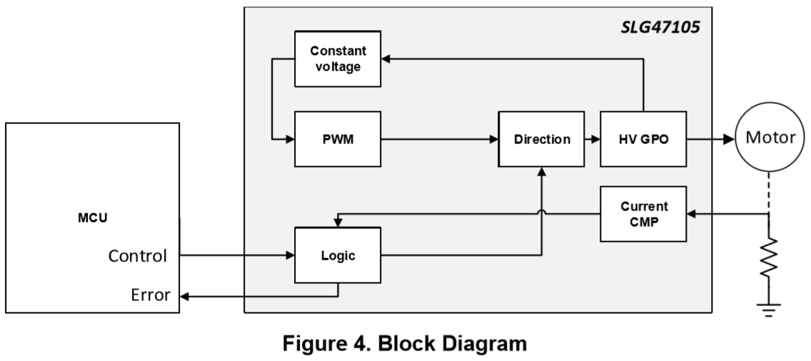

This typical Application circuit requires only one external component – a current sense resistor.
The design has one input for driver control and another one for fault monitor:
PIN#2 – a Button for close/open the smart lock deadbolt.
PIN#14 – Error output. When the closing time is less than 1 Second (can’t close smart lock), this output goes HIGH.
The general block diagram is shown in Figure 4.

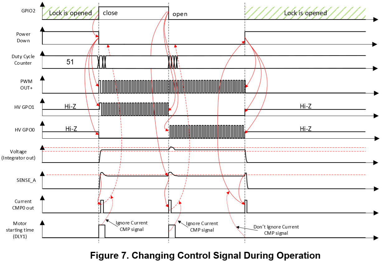

Changing of the Control Signal During Operation
In addition, this design permits changing deadbolt direction during the opening or closing process. This can be useful in the case when the user changes his mind and wants to open the door after pressing the close button, see Figure 7.
Error Closing
The Error Output can be used to detect an event when the door can’t be closed. In our case the closing time is equal to 1 second and can be changed in a wide range.
When the closing time is less than 1 second, the Error Output goes HIGH. It will be reset after the next falling edge at PIN2.
