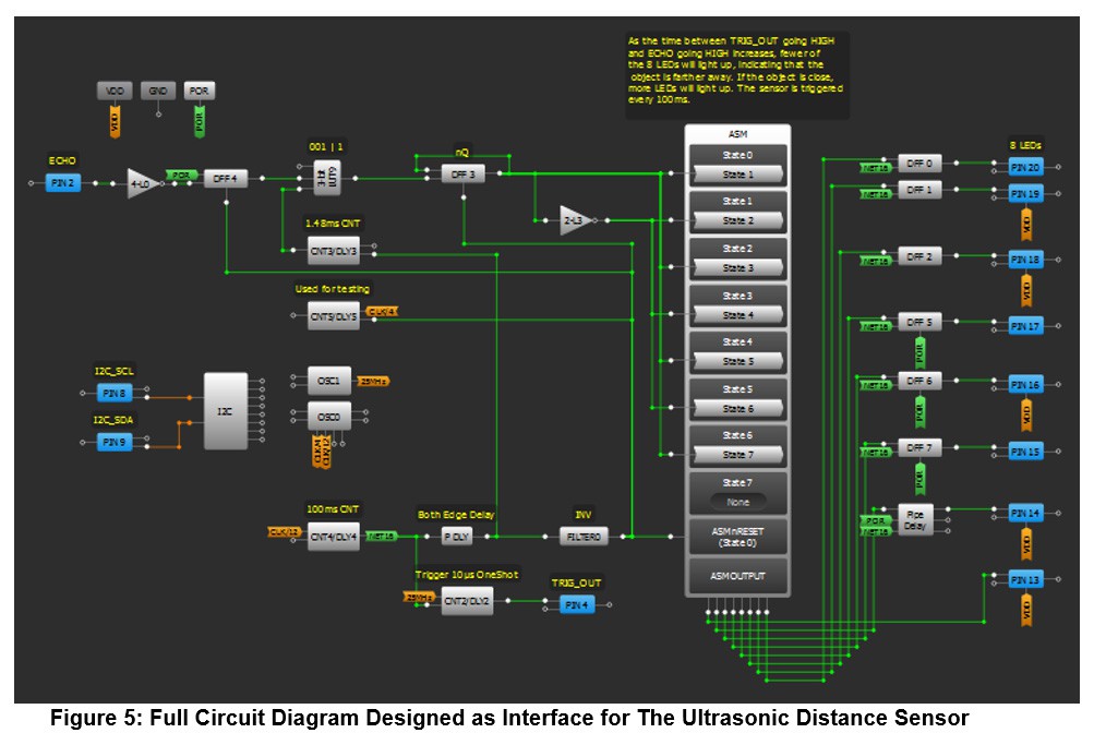

The system designed sends trigger pulses to the ultrasonic sensor every 100 ms. The GreenPAK internal components, together with the ASM, oversee the classification of the returning echo signal from the sensor. The ASM designed uses 8 states (states 0 to 7) to classify the echo from the ultrasonic sensor using the technique of iteratively transitioning through the states as the system waits for the echoed signal. In this way, the further the ASM goes through the states, the fewer LEDs light up.
As the system keeps measuring every 100 ms (10 times per second) it becomes easy to see the increase or decrease on the distances measured with the sensor.

 The input trigger requested by the sensor is an output generated by the GreenPAK, and the echo output of the sensor is used to measure the distance by the GreenPAK. The internal signals of the system will drive a one-shot component to generate the required pulse to trigger the sensor and the returning echo will be classified, using D flip-flops, logic blocks (LUT and inverter), and a counter block, into the 8 distance zones. The D flip-flops at the end will hold the classification on the output LEDs until the next measure is done (10 measures per second).

This design will demonstrate the state machine functionality of the GreenPAK. Since there are eight states within the proposed state machine, the GreenPAK SLG46537 is appropriate for the application. The machine was designed on the GreenPAK Designer software as shown in Figure 3, and the outputs definitions are set on the RAM diagram of Figure 4.
The full diagram of the circuit designed for the application can be seen in Figure 5. The blocks and their functionalities are described after the Figure 5.
As can be seen in Figure 3, Figure 4 and Figure 5, the system is designed to work in sequential-state order to generate a 10 us trigger pulse...
