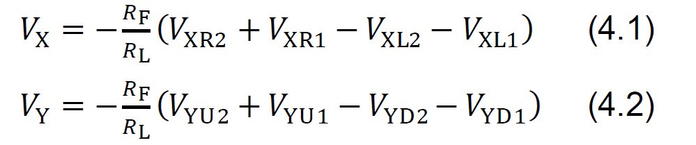

where E is the solar irradiance. The output voltages VX and VY are given as:
where RF is the feedback resistor resistance. Equations (2), (3), and (4) give:
In the first approximation the output voltage signals VX and VY are directly proportional to the pitch and roll angles with sensor sensitivity S. As the output signals are independent of the solar irradiance the circuitry has an inherent automatic gain control.
