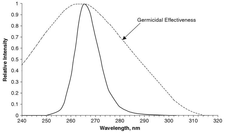

Ultraviolet germicidal irradiation (UVGI) is a disinfection method that uses short-wavelength ultraviolet (ultraviolet C or UV-C) light to kill or inactivate microorganisms by destroying nucleic acids and disrupting their DNA, leaving them unable to perform vital cellular functions. UVGI is used in a variety of applications, such as food, air, and water purification, or treat biologically contaminated surfaces.
Recent studies have shown that UV short-wave radiation is capable of eliminating COVID-19, MERS, and SARS viruses at the hospital level, thus improving the cleanliness of the intensive care area, general medicine rooms and individual rooms.

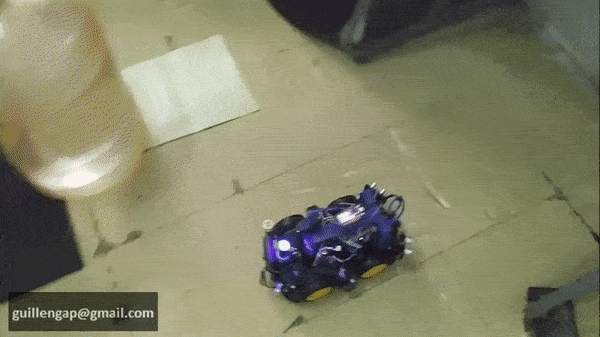

THIS AUTONOMOUS CAR HAS THE MAIN GOAL OF DESINFECTING THE ROOMS OF A HOUSE.
The effectiveness of germicidal UV depends on the length of time a microorganism is exposed to UV, the intensity and wavelength of the UV radiation, the presence of particles that can protect the microorganisms from UV, and a microorganism's ability to withstand UV during its exposure. https://en.wikipedia.org/wiki/Ultraviolet_germicidal_irradiation
THE PARTICULAR GOALS OF THIS PROJECT ARE:
  • 3D printing of the list of parts that will be used to assemble the Autonomous Robot;
  • Mounting the Chassis: "4WD Robot Car";
  • "Alexa Echo Dot" connection with the ESP32-WROOM-32 board, to transmit voice commands to the Autonomous Robot;
  • Calculation of Neural Networks with Python to be used on the Arduino UNO board, and to control the Autonomous Robot;
  • Use of a PID Controller to control the speed of the Autonomous Robot; and
  • Use of the Tesla coil to turn on an UV lamp.
