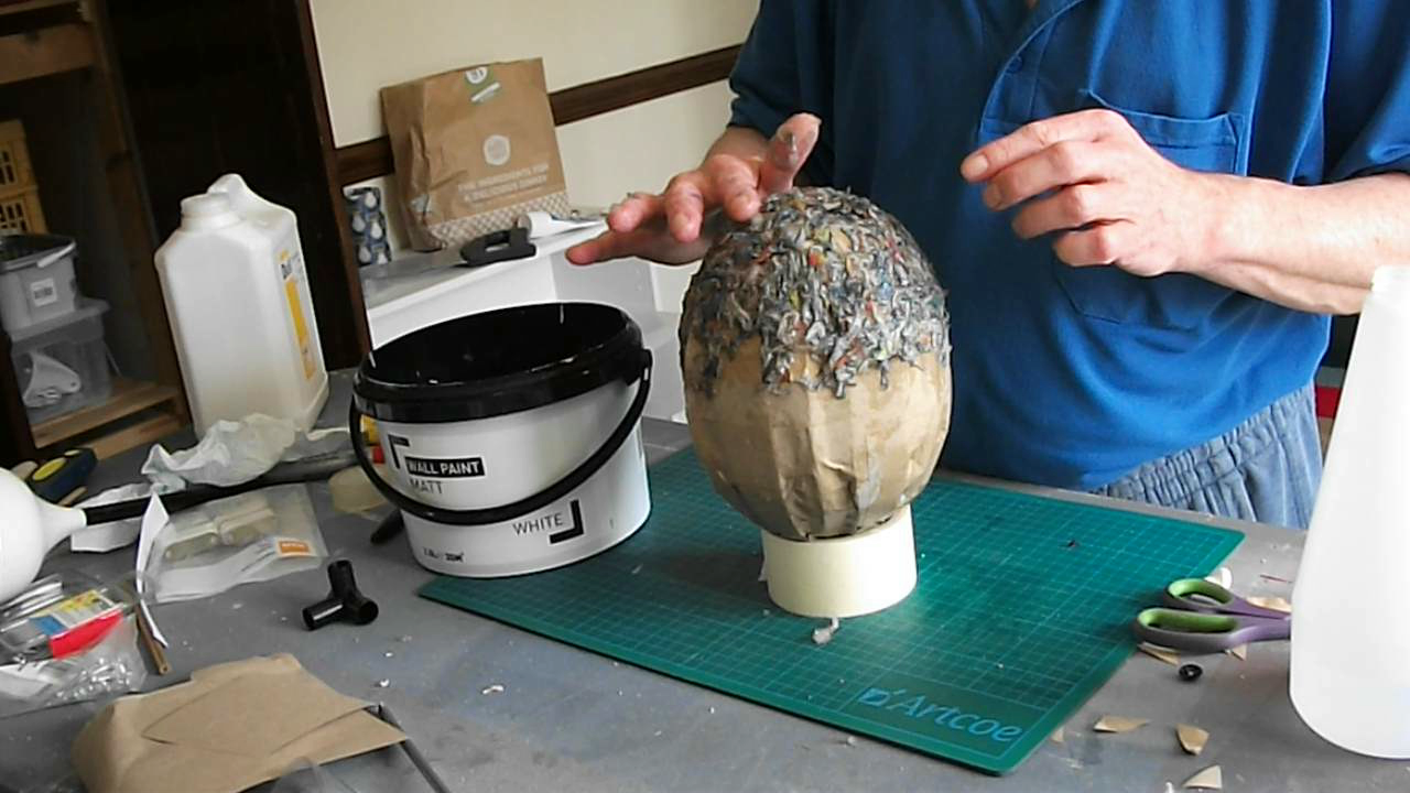

The next step was to put a layer of paper over the entire surface of the egg once I’d glued all the segments on, to give it a smooth, even surface. Then, to glue the narrower segments over the top.
Papier-mâché
After I’d started the step of papering the egg, I realised that it wasn’t going work well, so I decided to cover the whole thing in papier-mâché. Because of this, I could have skipped the step of sticking the paper layer over the cardboard, but oh well. It's a learning process.

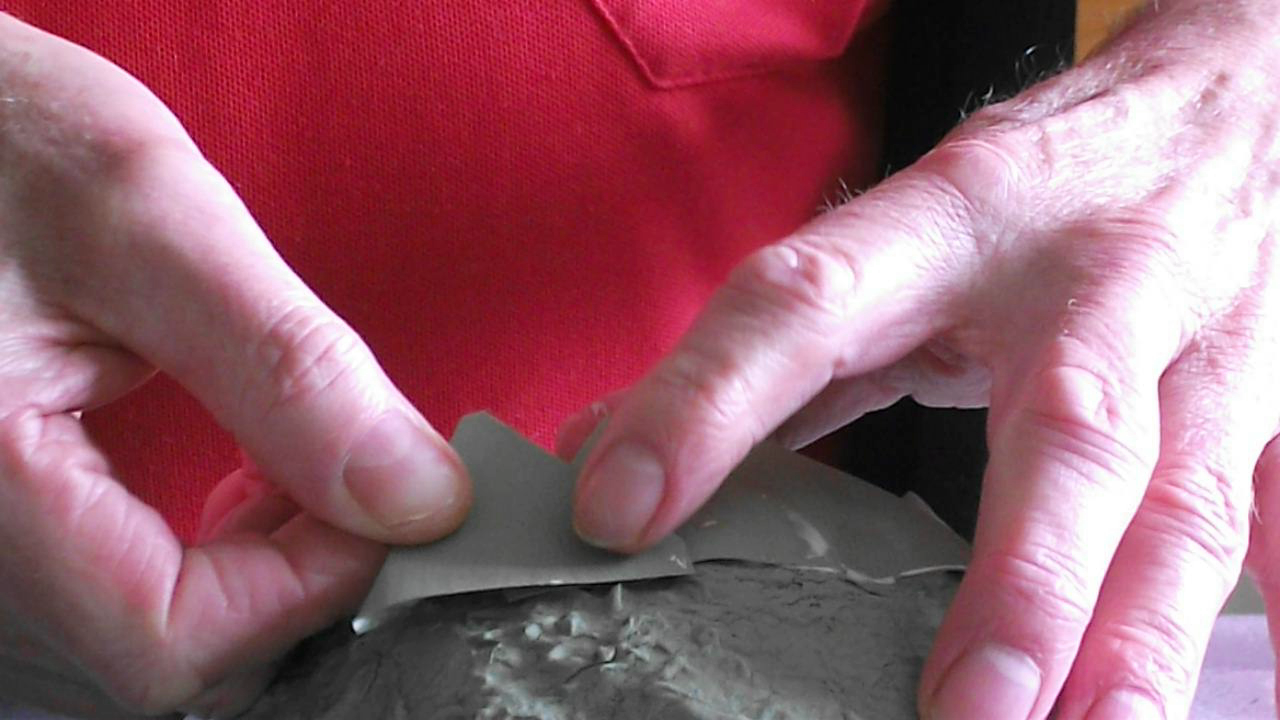

I started making the scales out of this paper tape. The tape is paper jointing tape, normally used for joining sheets of plasterboard or drywall. I used it because it's a fairly heavy paper, giving body to the scales. Unfortunately, the paper tape didn't work very well. It was okay for the very bottom scales, which tend to merge into the body of the egg, but further up the scales need more body to them. So I needed to find some other medium. After several tests, using cardboard and other types of paper, the only thing I found which provides the necessary thickness, and doesn't curl and warp while it dries is this fabric. I think it's called chenille. It's the wrongest application for it, but these were offcuts that probably would have been thrown away, and as I stated earlier, we're still in lockdown, and I have no EVA foam. So begins the tedious process of creating the scales. Since the fabric has a texture to it, I wanted to conceal this as much as I could, so I glued paper to the back. The back, in fact, will be the outside face of the scales.

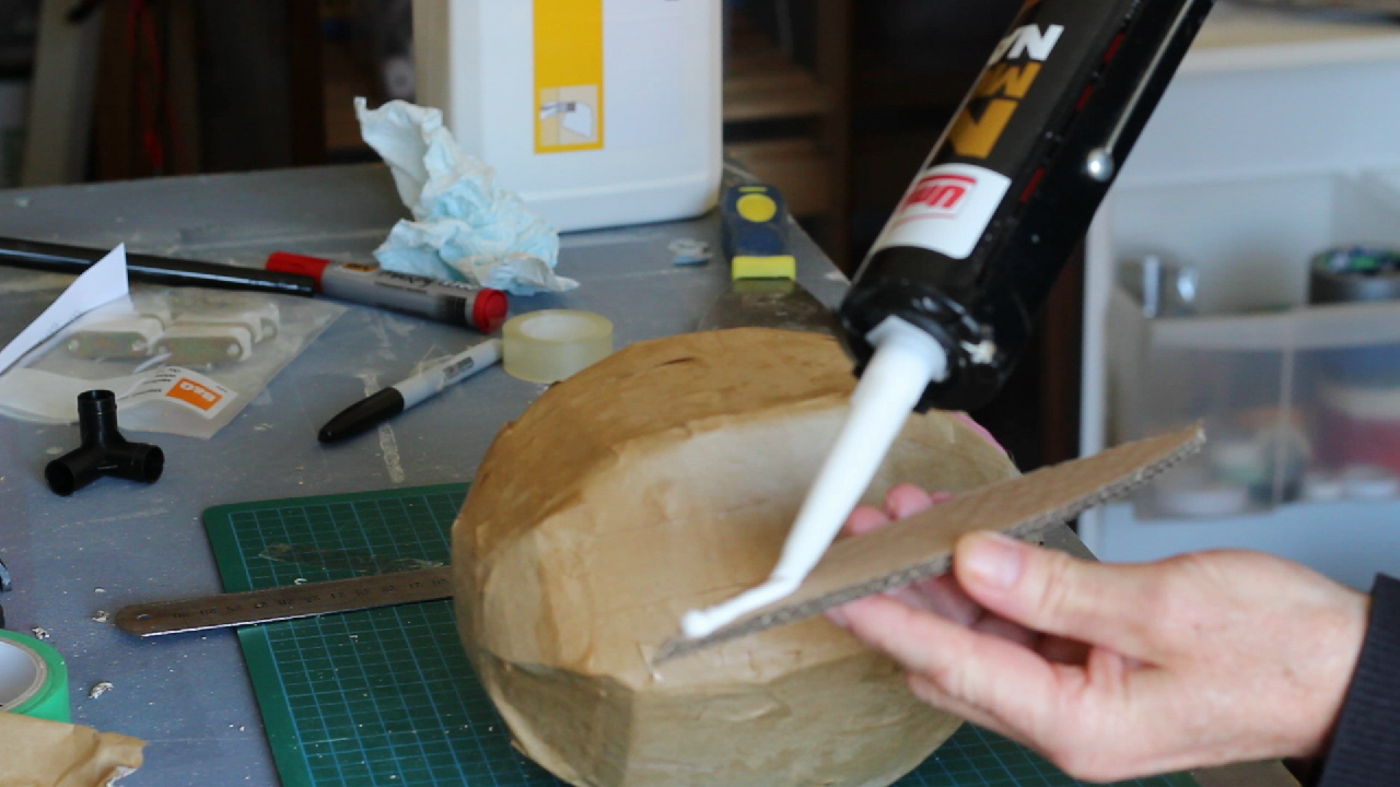

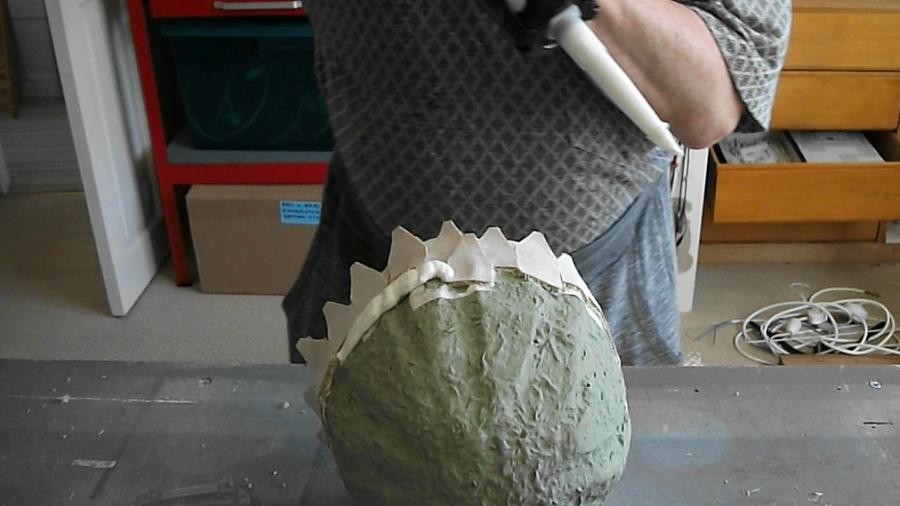

Sticking the Scales On
For the step of sticking the scales on, I decided to once again use the grab adhesive. This adhesive is like a paste, and so doesn't drip or run. Using ordinary PVA didn't work on the scales as they tended to just fall off again.

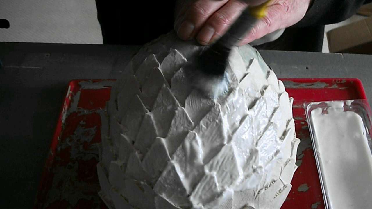

Once all the scales had been attached, and the glue was dry, I painted over the whole egg with a paste I'd made with PVA glue and flour. The flour thickened the PVA just a little and the idea was to help cover up the tufts of the fabric, which were showing on the edges of the scales. I didn't want the scales to look like they were made of fabric.
