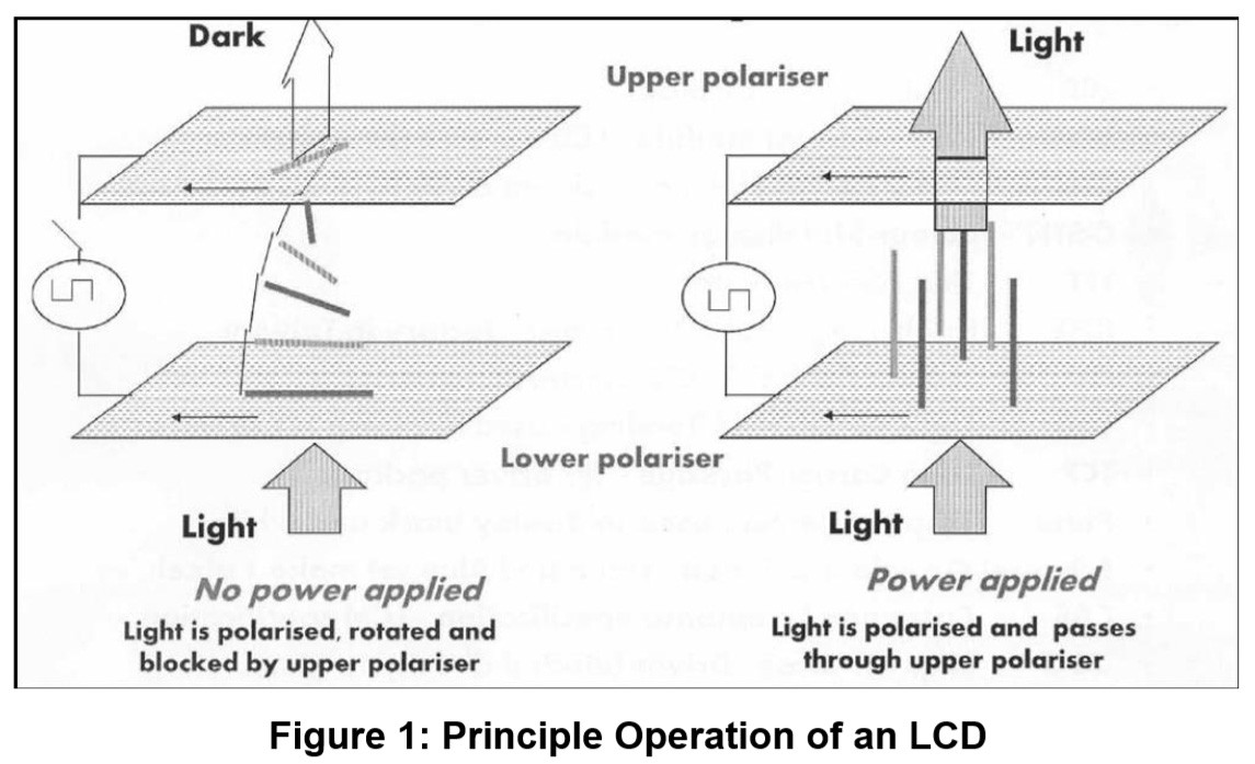

LCDs are constructed with two plates of glass (upper and bottom), a thin layer of liquid crystal (LC) between them and two light polarizers. The polarizer is a light filter for the light electromagnetic field. Only the light components in the right electromagnetic field direction pass through the polarizer, while the other components are blocked. The liquid crystal is an organic material that rotates the electromagnetic field of the light 90 degrees or more. However, when an electrical field is applied to the LC it does not rotate the light anymore. With the addition of transparent electrodes in the upper and bottom display glass, it's possible to control when the light passes through, and when not, with an external source of the electrical field.  Figure 1 below illustrates this operation control. In Figure 1, the display is dark when there isn’t an electrical field. This is because both polarizers filter the light in the same direction. If the polarizers are orthogonal, then the display will be dark when the electrical field is present. This is the most common situation for reflective displays.
The minimum electrical field, or voltage, to control the LCD is called the ON threshold. The LC is only affected by the voltage, and there is hardly any current in LC material. The electrodes in LCD forms a small capacitance and this is the only load for a driver. This is the reason for an LCD being a low-power device to show visual information.
However, it's important to note that the LCD can’t operate with a direct current (DC) voltage source for too long. The application of a DC voltage will cause chemical reactions in LC material, permanently damaging it. The solution is to apply an alternate voltage (AC) in LCDs electrodes.
