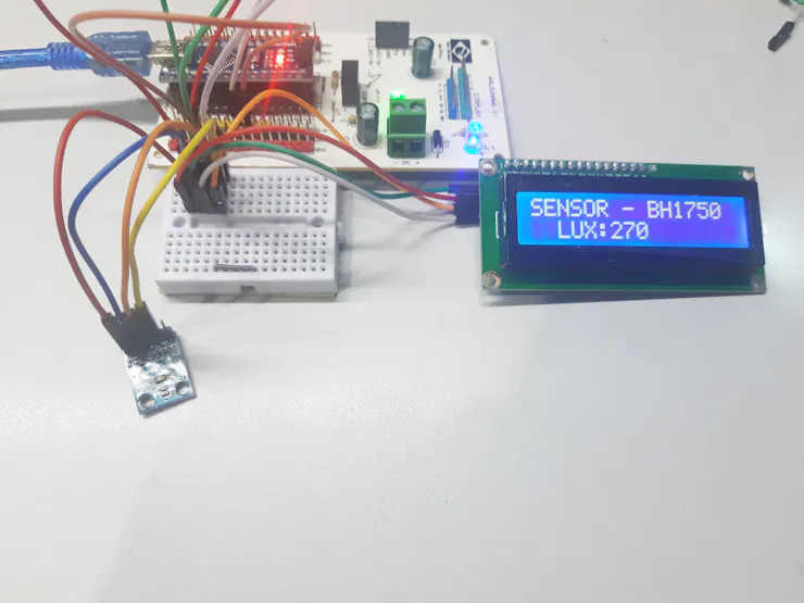

After programming the Arduino Nano, we can view the measurements shown on the display as shown in figure 3.
Figure 3 - Project constructed with Arduino, 16x2 LCD, and sensor BH1750.

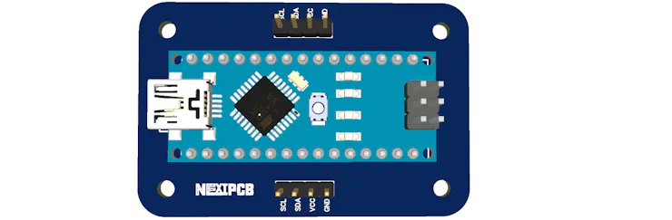

Now, you'll learn how to create a NEXTPCB printed circuit board for this project.
Figure 3 - 3D View of the Printed Circuit Board.
This printed Circuit Board was developed from of electronic schematic presented below.
Figure 4 - Electronic Schematic of the circuit.
After this, was developed a layout of the Printed Circuit Board. Finally, we'll develop an enclosure to put a printed circuit board, install the sensor, and buttons for future new projects.
