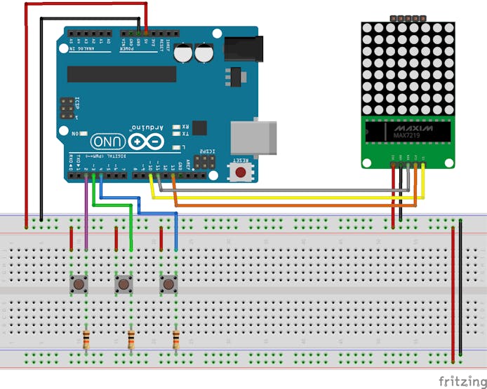

For this project, we will have a 64 position square map. This map will be represented by an 8x8 LED matrix. Through this map, the Arduino will choose a random position to hide the treasure.

This game can be played with one or several participants. Each participant has an attempt to find the position in which the treasure is hidden.
Initially, when turning on the system, the Arduino will randomly choose a position to hide the treasure. Then, each player must use the buttons shown in the Figure below.
Figure 1 - Circuit of thetreasure hunt game with Arduino.
In this game, there are 3 buttons. One button will be used to scroll through the lines, the second will be used to scroll through the columns and the third will be used to select the position desired by the user.
After the user selects the position, the system will check if the chosen coordinate is the same as the coordinate where the treasure is hidden.
If it is wrong, the system will have a circle on the screen.
Otherwise, the system will display a circle to indicate that the user was correct.
