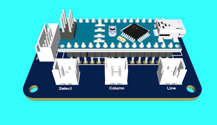

Next, we will present the printed circuit board structure for you to assemble and build your project.
Printed Circuit Board NEXTPCB for hunt treasure game with Arduino
Was developed a Printed Circuit Board for this project. The figure below presented the 3D View of the PCB. You can download the files in this link.
This NEXTPCB Printed Circuit Board was developed through the following electronic schematic presented in the figure below.
From this schematic, you can create your project through the files presented above and obtain your 10 Free PCBs in NEXTPCB PCB Factory.
