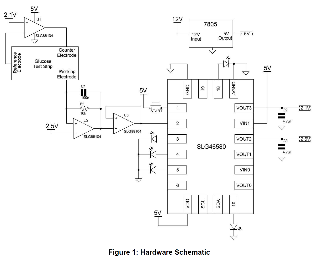

Hardware Schematic
The hardware schematic is shown in Figure 1.
The external 7805 voltage regulator is used to generate +5 V from the +12 V DC Adapter.
When a blood droplet is placed on the glucometer strip, a short circuit is created between the reference electrode and the counter electrode. This allows U1 (SLG88104V) to act as a unity gain amplifier. The output voltage is equal to the input voltage applied at the ‘+’ terminal, i.e., 2.1 V.
This short results in current flow between the counter electrode (now at 2.1 V) and the working electrode. The magnitude of the current flow is proportional to the glucose level of the blood drop.
The op-amp U2 (SLG88104V) acts as transimpedance amplifier. The output voltage of this amplifier can be calculated with the following formula:
VOUT = [Current flow between the Counter and Working electrodes] * R1
The 100 nF capacitor C1 is used to maintain smooth voltage.
Op-amp U3 is another unity gain amplifier that maintains a constant voltage at its output. The purpose of using 2.5 V and 2.1 V in this circuit is to maintain a voltage difference of 400 mV across two of the test strip electrodes. This is necessary for the glucometer to function properly.
The output voltage of op-amp U3 is then fed to the SLG46580V’s Pin6, which is configured as an analog input/output.

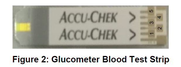

Glucometer Blood Test Strip
A typical glucometer strip is shown in Figure 2. The connections of the test strip are:
● 1 - Reference electrode
● 2 - Counter electrode
● 3 - Working electrode
● 4 and 5 - Test electrodes. These two electrodes are used to detect that the strip is inserted in the slot reserved for the strip. These two electrodes are not necessary for the functioning of the glucometer.
The connections may vary for different vendor strips; however, there should always be a reference, counter, and working electrode.
In each test strip, there is an enzyme called glucose oxidase. This enzyme reacts with the glucose in the blood sample and creates gluconic acid.
The gluconic acid then reacts with another chemical in the testing strip, called ferricyanide. The ferricyanide and the gluconic acid combine to create ferrocyanide.
Once the ferrocyanide has been created, the current moves through the blood sample on the strip. The level of current allows the GreenPAK to read the level of ferrocyanide and determine...
