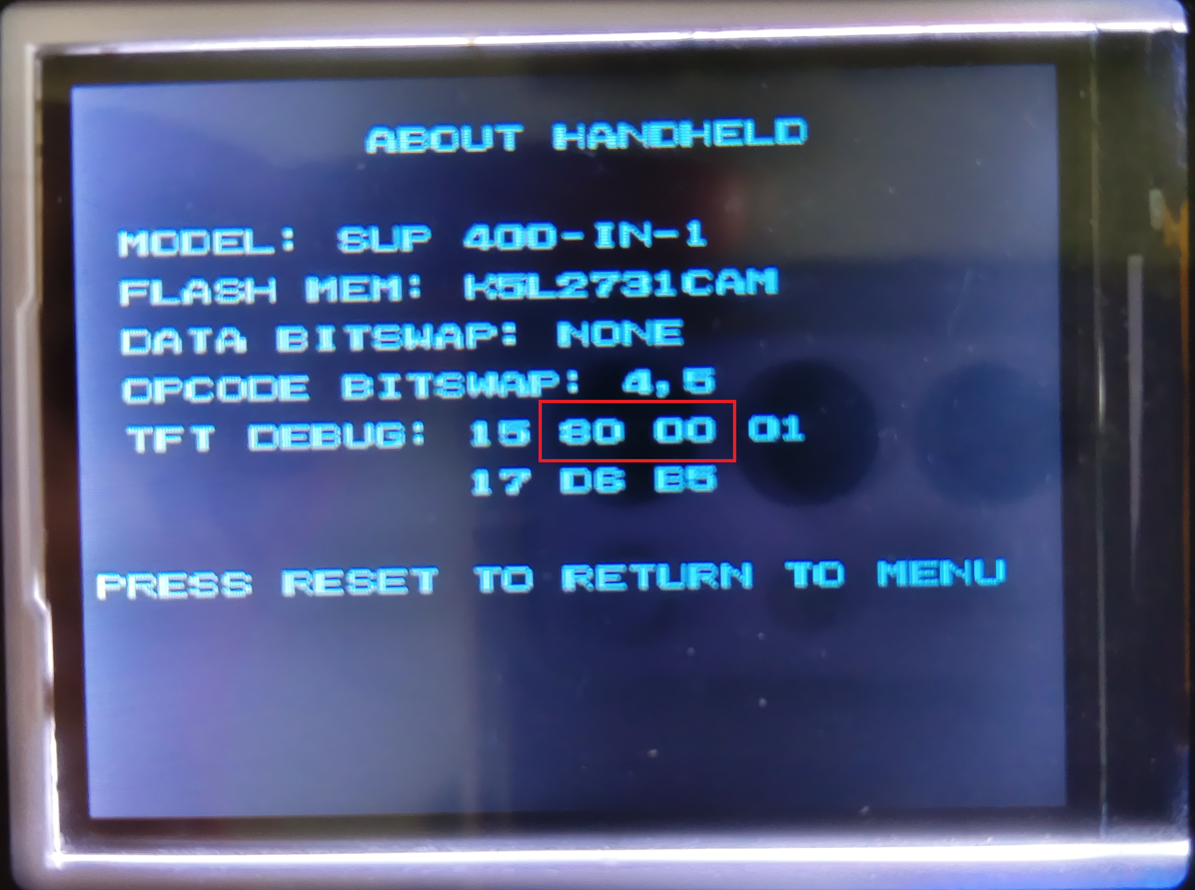

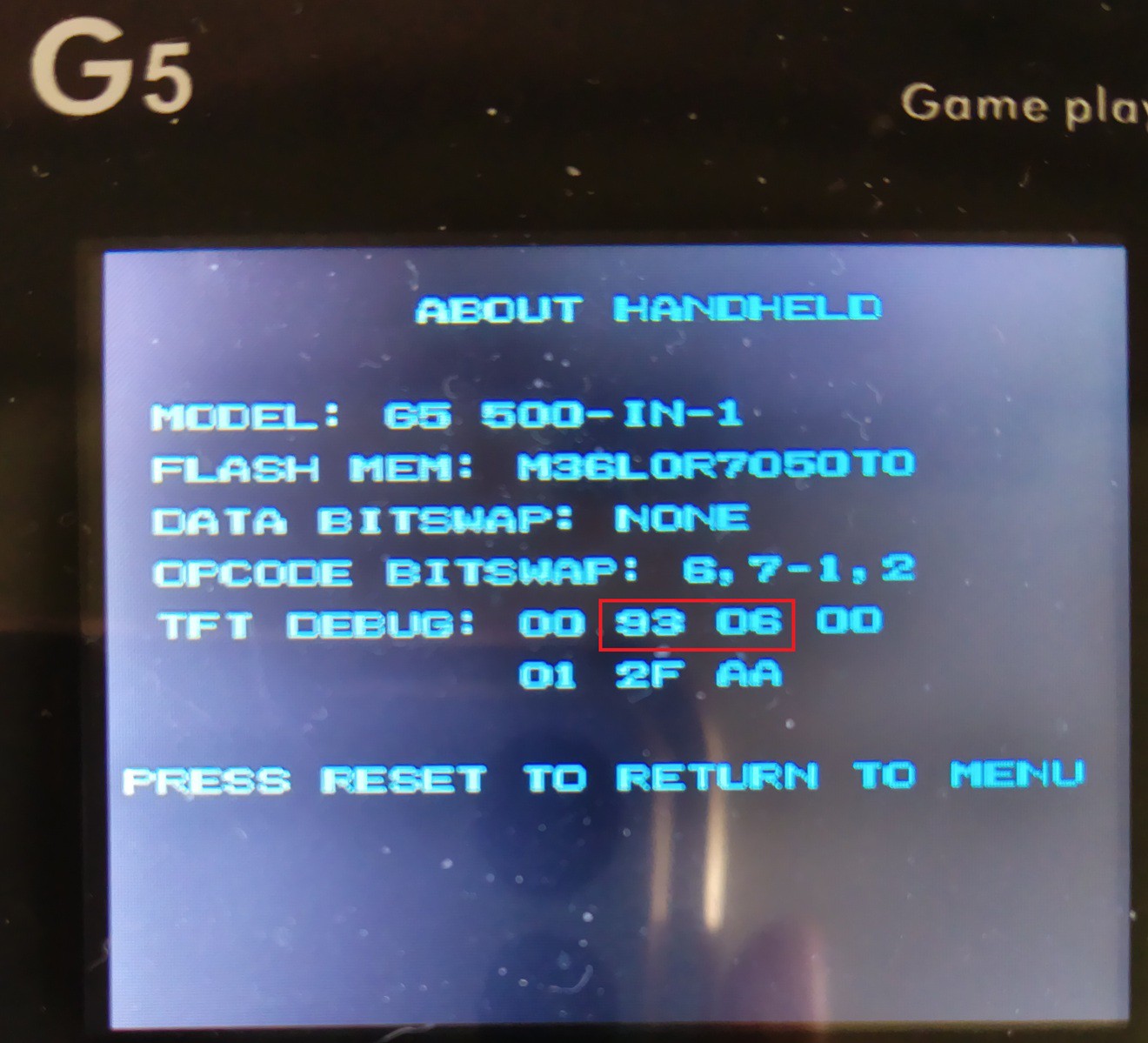

    Running this in the actual handheld, I got this:
    G5 (GC9306) - the 9306 is pretty obvious if you look into the decompiled code snippet earlier:
    Sup 400 in 1 (Renesas 61505?) - The '505' can be easily searched around Google too:
    By its read Device ID value that are in the TFT modules and then checking the disassembled code, we can easily get the TFT model. :D
