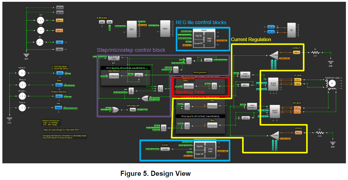

2. GreenPAK Design
2.1. PWM Frequency and Blanking Time
DLY1 block is used for blanking time generation and determining PWM frequency.
Blanking time signal is generated by DLY1, as shown in Figure 6. The output frequency is 125 kHz (8us). Blanking time (minimum HIGH-level duration) is 0.8us (10% of PWM period).
PWM Chopper function is used to chop PWM Duty Cycle by Current Comparator signal. PWM chopper ignores Current CMP signal during blanking time. Any active signal from Current CMP after Blanking time causes PWM Duty Cycle chopping end the current Period.
In this use case the PWM period is equal to blanking time signal frequency, and PWM duty cycle depends on a signal from Current CMP, but not less than blanking time.
2.2. RegFile Usage
The driver has a 16-byte RegFile, which allows creating an arbitrary current waveform. The driver has 64 values of Vref in the range from 0.032 V to 2.016 V with 0.032 V step, which can be used to fill 16 points of RegFile. They are used for creating a 1/4 of sine, as shown on Figure 8. Another sine part is created by moving through RegFile up and down and by operating with H-Bridge logic, see Figure 9. It is possible to write a half period or full period of the signal, but in this case, the signal will not be so smooth.
Max Vref value for sine depends on the sense resistor value:
Vref_max = IMAX * GAINCCMP * Rsense = 1 A * 8 * 0.11 Ohm = 0.88 V
where:
IMAX – maximum current per motor phase.
GAINCCMP – gain of current CMP. Should be set in GreenPAK designer in CCMP block.
RSENSE – value of external resistor for current measuring.
Four signals are used to generate two shifted sine waves. Two signals (“reg_file_up/down” and inverted) are used to select the direction of moving through RegFile (Up or Down) for each sine wave and another two signals (DFF1 OUT and DFF2 OUT) are used to select the polarity of generated sine wave (positive or negative).

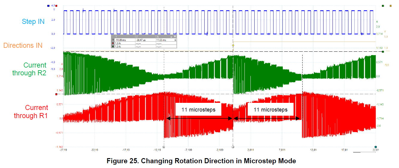

2.3. Changing Rotation Direction
The direction of rotation depends on what sine wave lags.
ϕ(A) - ϕ(B) = 90 deg
corresponds to clockwise rotation.
ϕ(B) - ϕ(A) = 90 deg
corresponds to counterclockwise rotation.
When the ‘Rotary Direction’ input (GPIO4) level is changed, for example from LOW to HIGH, the sine current phase will be changed by 180 degrees (from -90 to 90 degrees), see Figure 10. If the signal is changed from HIGH to LOW level, the sine current phase on the windings will be changed to -90 degrees.

3.2. Microstep
3.2.1. Changing Rotation Direction
3.2.2. Motor Turn-On in Microstep Mode
