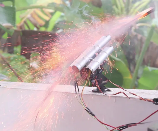

Making the Rocket Mount
Now we need something like a stand that can be rotated to control the direction and to place the rocket. For that, I’ll be using this tiny camera mount. The good thing is it already has two servo motors in it.
I placed a metal piece on top of this mount, on top of which I’ll be mounting the rocket holders.
So let’s glue the rocket holders. Rocket holders are nothing but aluminum pipes. Since we have 4 relays in our circuit we can launch a maximum of 4 rockets at a time. I’ll be going with 3 rockets. So we need 3 rocket holders.
Our rocket mount is now ready.

3, 2, 1 … LIFT OFF !!
Now all I had to do was, fix the rocket launcher somewhere outside. I had to make sure it won’t fall off during the launch. Looks good right? Then I fixed the PCB a little bit far from this rocket launcher. That’s because I had to make sure that the flame from the rocket would not burn the PCB.
Everything is all set guys. We just have to power on the circuit and let’s see what happens. Once it’s all powered up, I tried controlling the rocket launcher from our mobile phone, which I did.
Now I aim the rocket somewhere safe and we will launch our first rocket. Okay, this looks fine and three, two, one and GO!!
