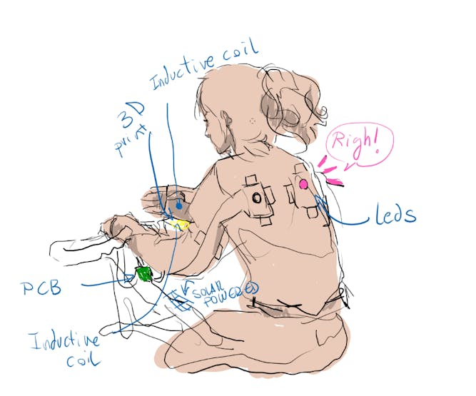

The concept The idea is quite simple. A single board controls blinking leds, but instead of directly connect the pin with the led, I'm attaching a wireless conductive charger to the blinking pin in the ATmega328 (for testing and prototyping you could use UNO or NANO) so it will pass the information (blinking) to the led as long as the other coil, the one connected to the led, is close to the one connected to the PCB. This way, battery and circuit (the heavier parts) are in the bike and not in the fabric, and it's more comfortable and convenient. Also, I decided to suggest a sewing pattern for using the leds in a detachable pocket.

The idea is quite simple. A single board controls blinking leds, but instead of directly connect the pin with the led, I'm attaching a wireless conductive charger to the blinking pin in the ATmega328 (for testing and prototyping you could use UNO or NANO) so it will pass the information (blinking) to the led as long as the other coil, the one connected to the led, is close to the one connected to the PCB. This way, battery and circuit (the heavier parts) are in the bike and not in the fabric, and it's more comfortable and convenient. Also, I decided to suggest a sewing pattern for using the leds in a detachable pocket so the biker can do the laundry without worrying about the components. The whole project is protected under SGPLv3, so anyone who uses it has to handle the code to the user and make it clear is open.

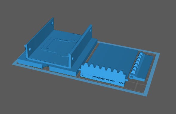

3D design
I used this wonderful 3D design for making a strap-held for the bike coils. Check it here:

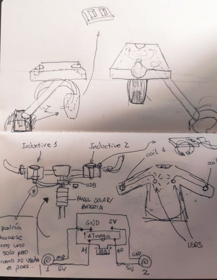

Sketches before the design:

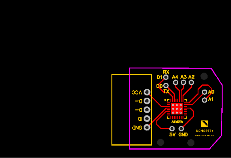

The code is quite simple, and adjusted to the PCB design. Let's take a look at the PCB first:
The board uses a ATmega328, connected to a mini USB module (only using power). Additionally, I added two power and GND pins in case an alternate power source is needed. Main pins are A0 and A1, wich will be left and right leds, but in case you want to add more leds A2, A3 and A4 are ready to blink leds as well. All the leds blink with a 1 sec timing, in case the biker wanna changes this, I added a RX-TX so you can read the current timing and set a new one using an extra Arduino that sends the data to the board (through TX). As the PCB uses a mini USB for powering up, feel free to attach it to a solar powered battery in your bike! or any other fair powered. Let's explore the code to better understand:
