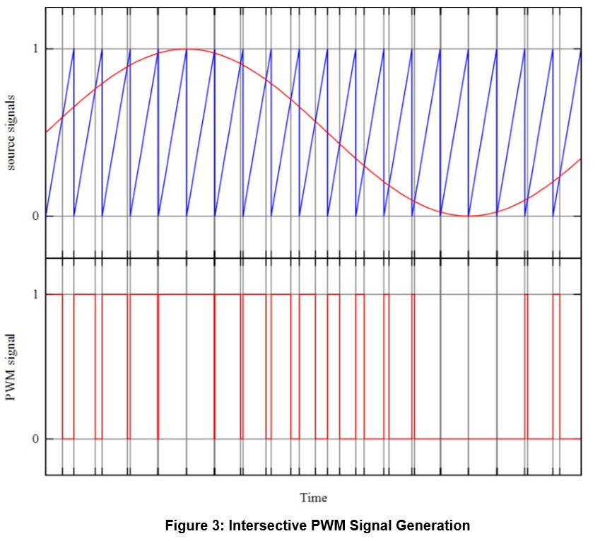

Figure 3 shows a simple method to generate the PWM pulse train corresponding to a given signal is by using the intersective PWM method: the signal (here the red sine wave) is compared with a sawtooth waveform (blue). When the latter is less than the former, the PWM signal (bottom) is in a high state (1). Otherwise, it is in the low state (0). We do all this digitally, with a counter for the sawtooth, and an updating SPI voice value for the signal.
