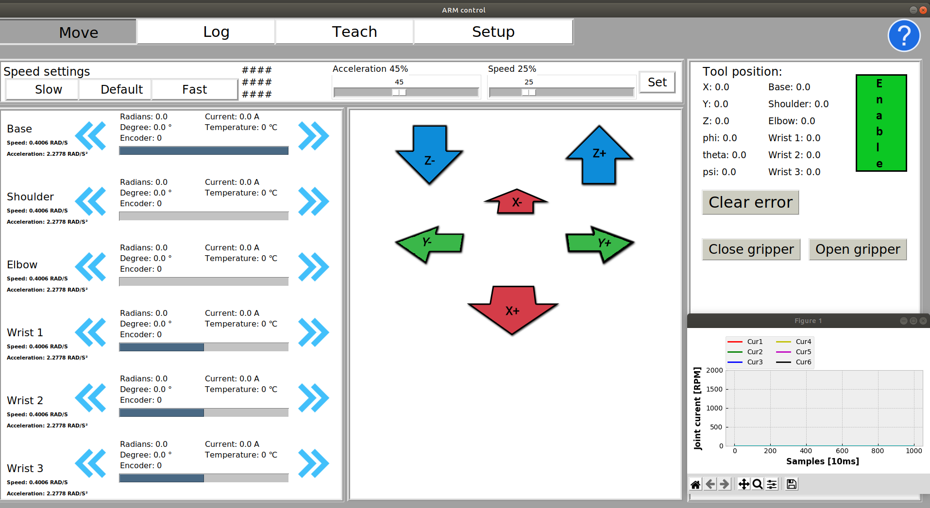

Easy to use software
Another important part of this project was to have software that makes programing robots "easy". GUI software was written in python and heavily relies on Petar Corke's robotic toolbox for python! It was tested on Linux virtual machine, laptop running Linux, and raspberry pi 4!
The software offers real-time monitoring of robots:
  • Motor position, current, speed, temperature
  • End effector position
  • Operating modes, errors...
Available modes at this moment are:
  • Individual motor jogging
  • freehand teach
  • move from point to point
Each of these modes of movement can be recorded and replayed!
  • This is an image of Teach menu. Here you can program your robot by writing code in "gray window" or by freehand movements.
  • This is Move menu of the GUI. It allows you to jog individual motors and in near future jog robot by xyz.
