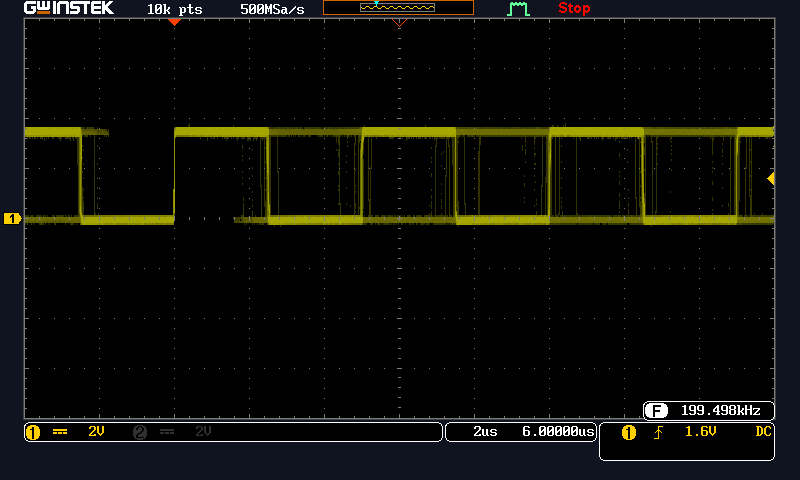

    • Let's try making a 200kHz square wave on DO7 (digital out).
    void setup() {
      // put your setup code here, to run once:
    tone(7, 200000);
    That's an unstable mess.  There's over 500ns of jitter.

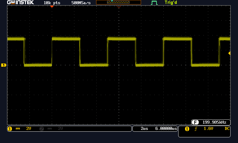

    • Let's try unplugging the USB cable and run the board on battery power
    OK.  That's better.  The USB port firmware must be interrupting the tone() function.  Lesson learned: Disconnect the computer for a stable output.  Let's try using the USB A port on the oscilloscope for power.  No, the output is unstable again.  Let's try power from a cheap charger.  That's stable again.  I'm going to use battery power since it gives the cleanest results.
    Try tone(7, 250000);   Output was stable 250.0 kHz.
    Try tone(7, 300000);    Output was stable 300 kHz, without much jitter.

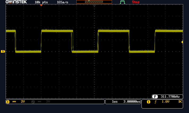

    tone(7, 301000) generated 303.8 kHz.  Setting 302000 or 303000 also generated 303.8 kHz.  The tone() function is likely using an integer divider from the peripheral clock.  The divider resolution is not fine at these higher output frequencies.  This causes coarse steps in output frequency.  Maybe the tone() function can be improved, but this isn't going to replace an analog signal generator at 455 kHz.
    Setting 304000, 305000 or 307000 all generated 307.7 kHz.
    Setting tone(7, 308000); generated 311.7 kHz with some edge jitter.
