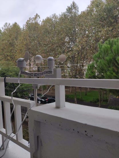

Before building and testing my neural network model, I had collected weather data at my balcony and backyard in three kilometers radius for more than three months to create a local weather data set showing weather information in my neighborhood. To be able to elicit weather information even in extreme weather conditions, I used a Weather Station Kit with Anemometer, Wind Vane, and Rain Bucket by DFRobot with two different development boards:
Thus, I could transfer weather data via WiFi at my balcony or GPRS if the distance between my router and the weather station is too far away.

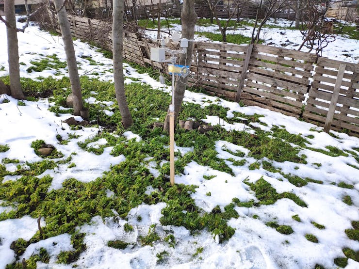

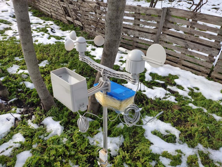

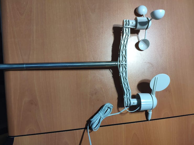

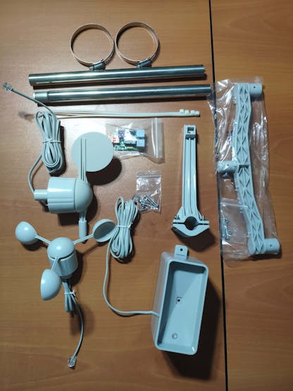

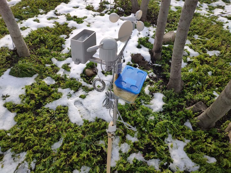

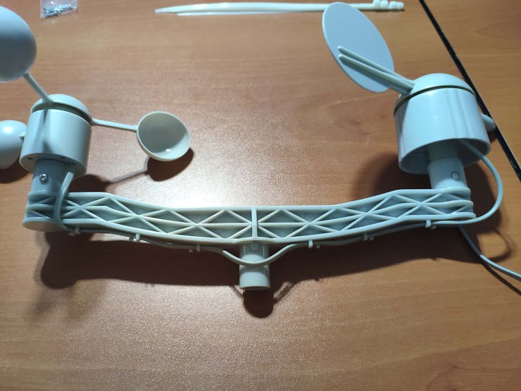

Step 1: Assembling the weather station kit with an anemometer, wind vane, and rain bucket
This weather station kit includes an anemometer, wind vine, rain bucket, and a sensor board to send weather data via the serial communication protocol. Thus, it is easy-to-use with development boards to collect local weather data.
It outputs 37 bytes per second, including the end CR/LF.
c000s000g000t086r000p000h53b10020
Data Parser:

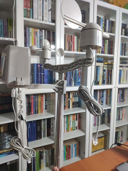

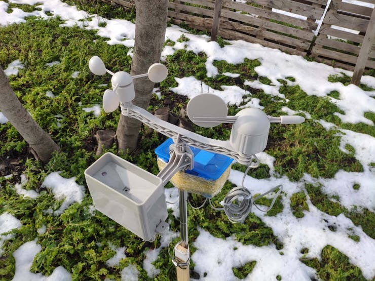

⭐ First of all, attach the anemometer and the wind vane to the bridge by using screws and nuts.
⭐ Connect the wind vane to the anemometer by using the RJ11 phone cord and tighten it under the bridge.
⭐ Then, mount the stainless steel stick to the bridge with screws.

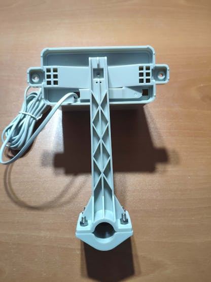

⭐ Install the rain bucket joint under the rain bucket with screws.
⭐ Lastly, place the rain bucket on the stainless steel stick by using screws and nuts.
⭐ Now, it is ready to collect weather data even in extreme weather conditions. However, the sensor (converter) board is not weather-proof, so I added a plastic box to the weather station to protect the sensor board and the SIM808 shield outdoors.

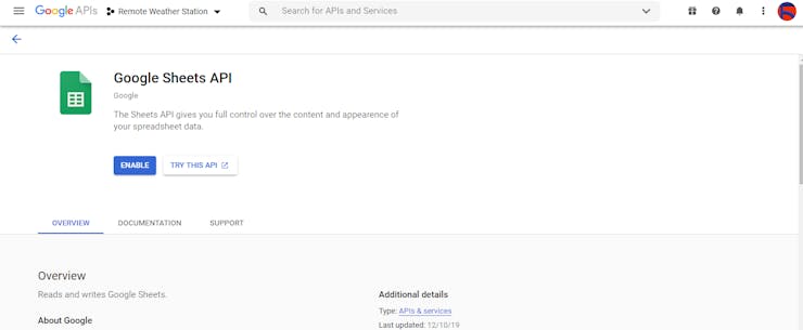

Step 2: Collecting weather data on Google Sheets

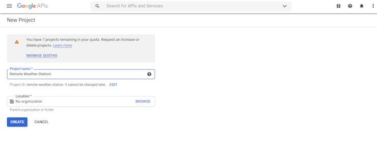

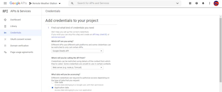

To be able to send information to a spreadsheet on Google Sheets, you need to create a new application in the Google Developer Console and get verification credentials to utilize the Google Sheets API. If you are a novice in creating applications with the Google Developer Console, follow the instructions below.

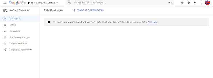

⭐ Go to Google Developer Console and click the 'NEW PROJECT' button. Enter the project name as Remote Weather Station.
⭐ Go to the APIs & Services and click to the API library to enable the Google Sheets API.

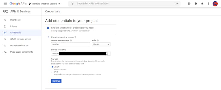

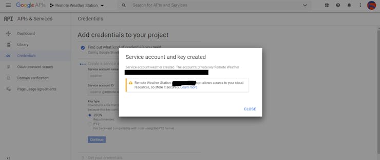

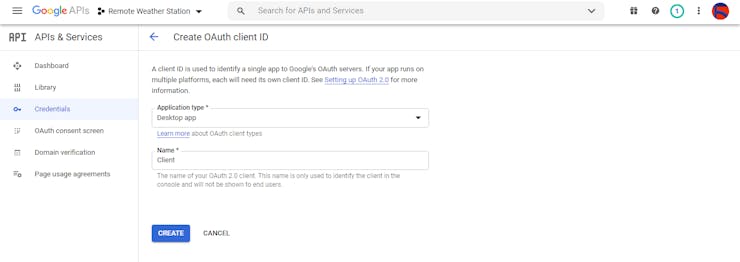

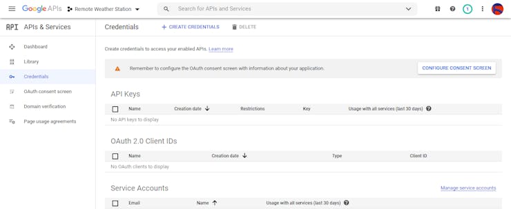

Step 2.1: Getting credentials to use the Google Sheets API

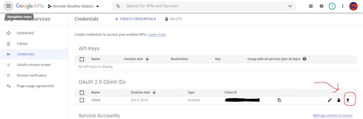

⭐ Open the project dashboard and click the Credentials button. Then, fill the form as depicted below to create the service account and key.

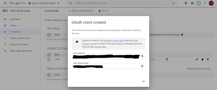

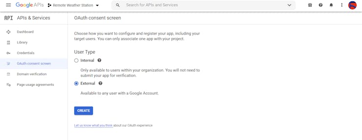

⭐ Click the CREATE CREDENTIALS button and configure the consent screen to be able to create an OAuth client ID.
⭐ Then, create a new OAuth client ID named Client under Desktop app (application type).
⭐ After creating the OAuth client ID (Client) download the credentials (ID and Secret) and name the file as credentials.json.

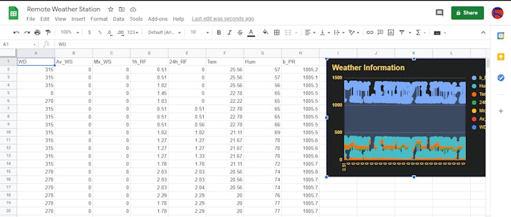

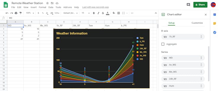

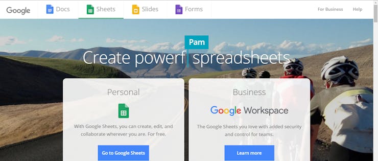

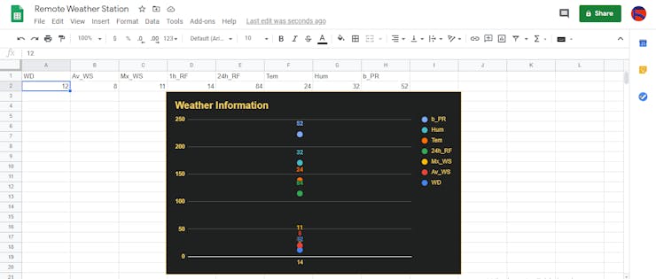

Step 2.2: Creating a spreadsheet on Google Sheets
⭐ Go to Google Sheets and select Personal.
⭐ Create a Blank spreadsheet and name it Remote Weather Station.

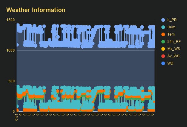

⭐ Then, define the column names as the first row:
⭐ If needed, modify a chart to inspect the collected data, as did I.

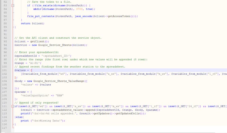

Step 3: Developing a web application in PHP to append weather data to the spreadsheet
This PHP web application is for getting weather data transferred by the development boards (ESP8266 and SIM808) via an HTTP Get request and appending that data to a given spreadsheet (by ID) on Google Sheets with verified credentials and token.
The web application requires the Google Client Library for PHP to append weather data to a given spreadsheet on Google Sheets.
⭐ So, first of all, create a folder named remote_weather_station in your server and install the Google Client Library for PHP in it.
The remote_weather_station folder should include these four files in addition to the Google Client Library to work:
In this step, I will discuss the first two files - index.php and account_verification_token.php:
💻 index.php
⭐ Get local weather data from the weather station via a Get request:
// Wind Direction (wd), Average Wind Speed (a_ws), Max Wind Speed (m_ws), 1hr Rainfall (1_rf), 24hr Rainfall (24_rf), Temperature (tem), Humidity (hum), Barometric Pressure (b_pr).$variables_from_module;if(isset($_GET['wd']) && isset($_GET['a_ws']) && isset($_GET['m_ws']) && isset($_GET['1_rf']) && isset($_GET['24_rf']) && isset($_GET['tem']) && isset($_GET['hum']) && isset($_GET['b_pr'])){	$variables_from_module = [	  "wd" => (int)$_GET['wd'],	  "a_ws" => (float)$_GET['a_ws'],	  "m_ws" => (float)$_GET['m_ws'],	  "1_rf" => (float)$_GET['1_rf'],	  "24_rf" => (float)$_GET['24_rf'],	  "tem" => (float)$_GET['tem'],	  "hum" => (int)$_GET['hum'],	  "b_pr" => (float)$_GET['b_pr']    ];}else{    $variables_from_module = [	  "wd" => "err",	  "a_ws" => "err",	  "m_ws" => "err",	  "1_rf" => "err",	  "24_rf" => "err",	  "tem" => "err",	  "hum" => "err",	  "b_pr" => "err"    ];}

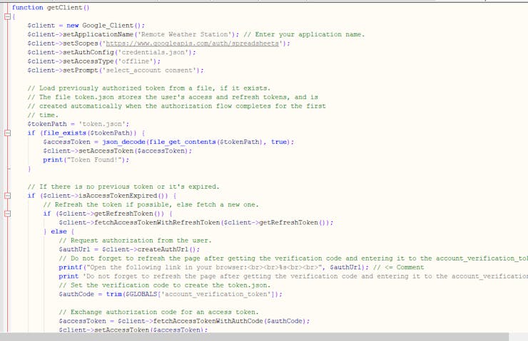

⭐ Connect to the Google Developer Console application named Remote Weather Station by using the credentials.json file (Step 2.1).
$client = new Google_Client();    $client->setApplicationName('Remote Weather Station'); // Enter your application name.    $client->setScopes('https://www.googleapis.com/auth/spreadsheets');    $client->setAuthConfig('credentials.json');    $client->setAccessType('offline');    $client->setPrompt('select_account consent');
⭐ Load previously authorized token from a file (token.json), if it exists.
$tokenPath = 'token.json';    if (file_exists($tokenPath)) {        $accessToken = json_decode(file_get_contents($tokenPath), true);        $client->setAccessToken($accessToken);		print("Token Found!");    }
⭐ If there is no previous token or expired, request authorization from the user and set the verification code to create the token.json file with the file_put_contents() function.
if ($client->isAccessTokenExpired()) {        // Refresh the token if possible, else fetch a new one.        if ($client->getRefreshToken()) {            $client->fetchAccessTokenWithRefreshToken($client->getRefreshToken());        } else {            // Request authorization from the user.            $authUrl = $client->createAuthUrl();						...            // Set the verification code to create the token.json.			$authCode = trim($GLOBALS['account_verification_token']);						...            // Check to see if there was an error and the account_verification_token is entered.            if (array_key_exists('error', $accessToken)) {                throw new Exception(join(', ', $accessToken));            }else{				print("Successful! Refresh the page.");			}        }        // Save the token to a file.        if (!file_exists(dirname($tokenPath))) {            mkdir(dirname($tokenPath), 0700, true);        }        file_put_contents($tokenPath, json_encode($client->getAccessToken()));    }
⭐ Enter the spreadsheet ID and range to append recent findings from the weather station to the spreadsheet.
https://docs.google.com/spreadsheets/d/spreadsheetId/edit#gid=0
// Enter your spreadsheetId:$spreadsheetId = '<spreadsheet_ID>';// Enter the range (the first row) under which new values will be appended (8 rows):$range = 'A1:H1';// Append recent findings from the weather station to the spreadsheet.$values = [    [$variables_from_module["wd"], $variables_from_module["a_ws"], $variables_from_module["m_ws"], $variables_from_module["1_rf"], $variables_from_module["24_rf"], $variables_from_module["tem"], $variables_from_module["hum"], $variables_from_module["b_pr"]]];$body = new Google_Service_Sheets_ValueRange([    'values' => $values]);$params = [    'valueInputOption' => "RAW"];...    $result = $service->spreadsheets_values->append($spreadsheetId, $range, $body, $params);    printf("<br><br>%d cells appended.", $result->getUpdates()->getUpdatedCells());

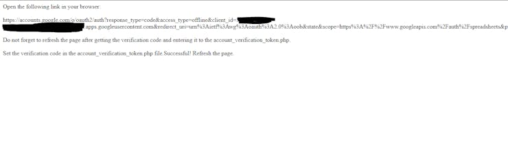

💻 account_verification_token.php

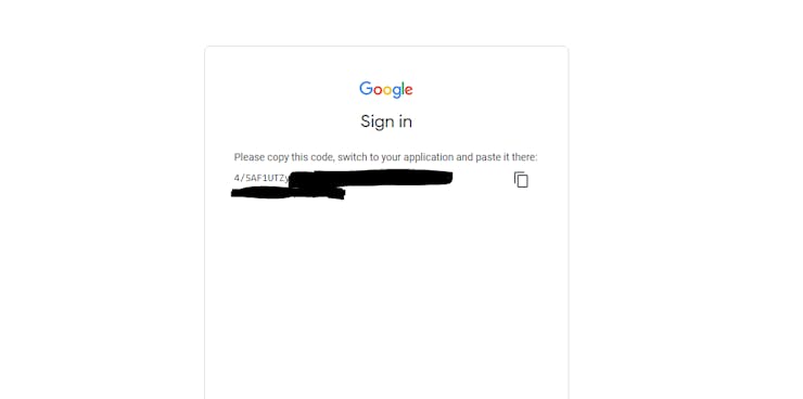

⭐ After authorizing the web application by the created AuthUrl, enter the given verification code to set an access token.
$account_verification_token = "<Enter Token>"; // Enter the verification code after authorization.

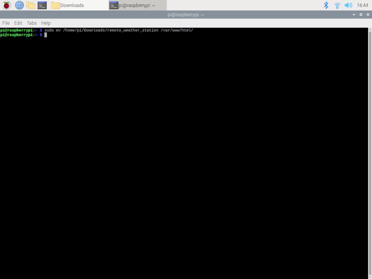

Step 3.1: Setting up the web application on Raspberry Pi (or any server)
After creating the PHP web application, I decided to run it on my Raspberry Pi, but you can run the application on any server as long as it is a PHP server.
If you want to use Raspberry Pi but do not know how to set up a LAMP web server on Raspberry Pi, you can inspect this tutorial.
⭐ First of all, move the application folder (remote_weather_station) to the apache server (/var/www/html) by using the terminal since the apache server is a protected location.
sudo mv /home/pi/Downloads/remote_weather_station /var/www/html/

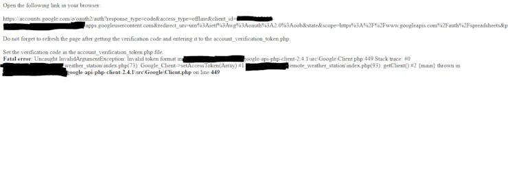

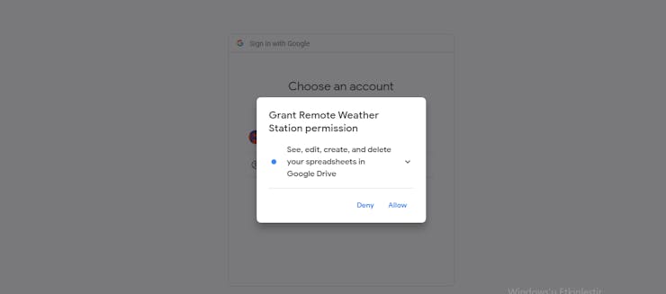

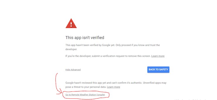

⭐ The web application throws an error when opened for the first time due to the missing verification code. To obtain the verification code, go to the generated authorization link by the application.
⭐ Then, click to Go to Remote Weather Station (unsafe).
⭐ Grant the application with the required permissions.
⭐ Now, copy the verification code and paste it into account_verification_token.php.
⭐ Return to the web application. It should display the confirmation message: Successful! Refresh the page.
⭐ After refreshing the page, the web application uses the verification code to get an access token and saves the access token in a file named token.json. Thus, it does not throw an error again.

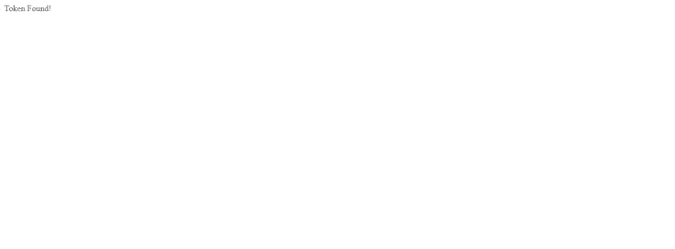

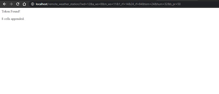

⭐ To test whether the PHP web application is appending new data to the given spreadsheet accurately:
http://localhost/remote_weather_station/?wd=12&a_ws=8&m_ws=11&1_rf=14&24_rf=84&tem=24&hum=32&b_pr=57

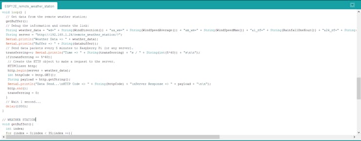

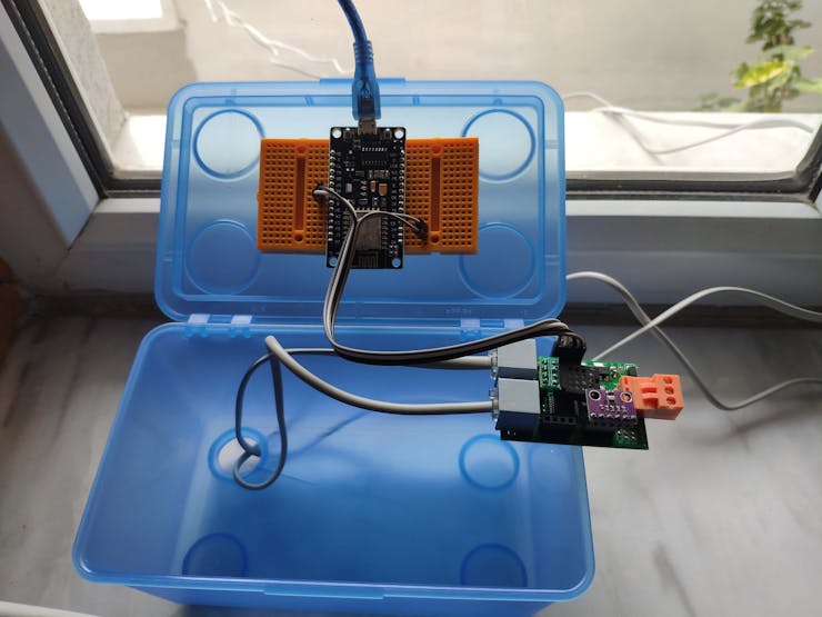

Step 4: Reading and sending weather data with ESP8266 (WiFi)
To collect weather data at my balcony, I used a NodeMCU ESP-12E (ESP8266) development board with the weather station.
I programmed it to send weather data to the PHP web application every five minutes.
⭐ Include required libraries and define the WiFi settings.
#include <ESP8266WiFi.h>#include <WiFiClient.h> #include <ESP8266WebServer.h>#include <ESP8266HTTPClient.h>#include <SoftwareSerial.h>// Define your WiFi settings.const char *ssid = "<SSID>";const char *password = "<PASSWORD>";
⭐ Define weather station settings and the serial connection pins - D6, D5.
// Define weather station settings:char databuffer[35];double temp;int transferring = 0;// Define the serial connection pins - RX and TX.SoftwareSerial Serial_1(D6, D5); // (Rx, Tx)
⭐ In the getBuffer() function, get data from the weather station.
void getBuffer(){  int index;  for (index = 0;index < 35;index ++){    if(Serial_1.available()){      databuffer[index] = Serial_1.read();      if (databuffer[0] != 'c'){        index = -1;      }    }    else{      index --;    }  }}
⭐ Debug the weather data and create the link.
String weather_data = "wd=" + String(WindDirection()) + "&a_ws=" + String(WindSpeedAverage()) + "&m_ws=" + String(WindSpeedMax()) + "&1_rf=" + String(RainfallOneHour()) + "&24_rf=" + String(RainfallOneDay()) + "&tem=" + String(Temperature()) + "&hum=" + String(Humidity()) + "&b_pr=" + String(BarPressure());String server = "http://192.168.1.24/remote_weather_station/?";...int WindDirection(){ return transCharToInt(databuffer,1,3); } // Wind Direction (deg)float WindSpeedAverage(){ temp = 0.44704 * transCharToInt(databuffer,5,7); return temp; } // Average Air Speed (1 minute)float WindSpeedMax(){ temp = 0.44704 * transCharToInt(databuffer,9,11); return temp; } //Max Air Speed (5 minutes)float Temperature(){ temp = (transCharToInt(databuffer,13,15) - 32.00) * 5.00 / 9.00; return temp; } // Temperature ("C")float RainfallOneHour(){ temp = transCharToInt(databuffer,17,19) * 25.40 * 0.01; return temp; } // Rainfall (1 hour)float RainfallOneDay(){ temp = transCharToInt(databuffer,21,23) * 25.40 * 0.01; return temp; } // Rainfall (24 hours)int Humidity(){ return transCharToInt(databuffer,25,26); } // Humidity (%)float BarPressure(){ temp = transCharToInt(databuffer,28,32); return temp / 10.00; } // Barometric Pressure (hPA)
⭐ Send data packets every 5 minutes to Raspberry Pi (or any server).
transferring++; Serial.println("Time => " + String(transferring) + "s / " + String(int(5*60)) + "s\n\n");  if(transferring == 5*60){   // Create the HTTP object to make a request to the server.    HTTPClient http;    http.begin(server + weather_data);   int httpCode = http.GET();              String payload = http.getString();       Serial.println("Data Send...\nHTTP Code => " + String(httpCode) + "\nServer Response => " + payload + "\n\n");    http.end();   transferring = 0;    }  // Wait 1 second...  delay(1000);

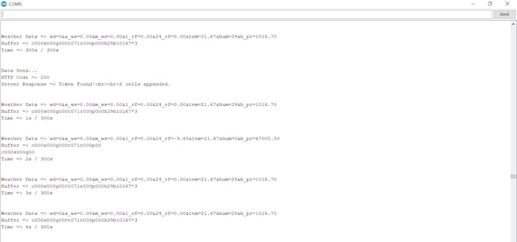

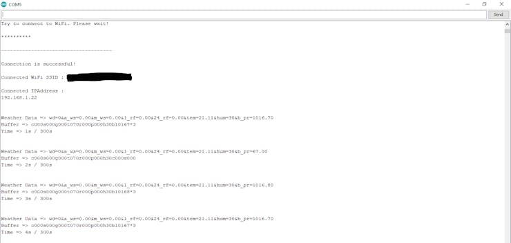

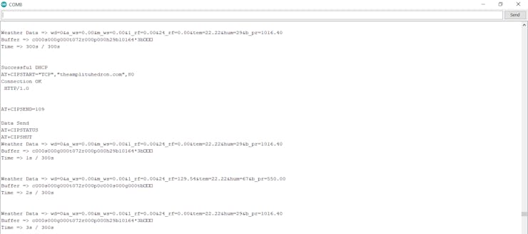

⭐ After uploading the code to the NodeMCU ESP-12E (ESP8266) development board, it displays weather data every second on the serial monitor and sends data packets every five minutes (300 seconds) to the PHP web application.
Connection is successful!...Weather Data => wd=0&a_ws=0.00&m_ws=0.00&1_rf=0.00&24_rf=0.00&tem=21.67&hum=29&b_pr=1016.70Buffer => c000s000g000t071r000p000h29b10167*3Time => 299s / 300sWeather Data => wd=0&a_ws=0.00&m_ws=0.00&1_rf=0.00&24_rf=0.00&tem=21.67&hum=29&b_pr=1016.70Buffer => c000s000g000t071r000p000h29b10167*3Time => 300s / 300s...
⭐ Then, it shows the response from the server.
...Data Send...HTTP Code => 200Server Response => Token Found!8 cells appended....

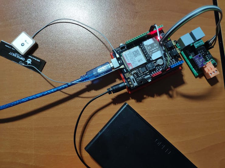

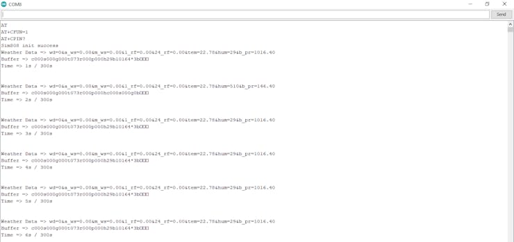

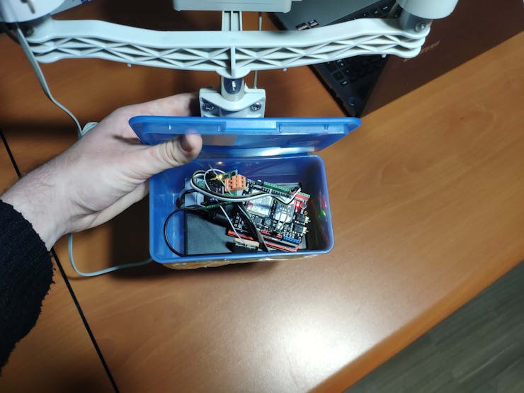

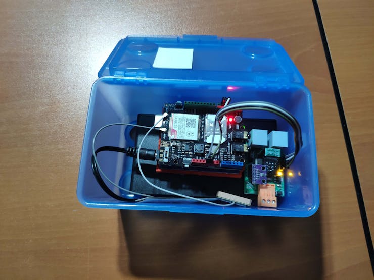

Step 4.1: Reading and sending weather data with SIM808 (GPRS)
To collect weather data in my backyard, I used a SIM808 shield for Arduino Uno if the distance between the weather station and my router is too far away.
Most of the code is the same and covered in the previous step aside from the parts below.
⭐ Include required libraries and define the sim808 object.
For SIM808 GPS/GPRS/GSM Shield | Download
#include <DFRobot_sim808.h>#include <SoftwareSerial.h>// Define the sim808.DFRobot_SIM808 sim808(&Serial);
⭐ Initialize the SIM808 module and continue if it is working accurately.
//******** Initialize sim808 module *************  while(!sim808.init()) {     delay(1000);     Serial.print("Sim808 init error\r\n");  }  delay(2000);  // Continue if the SIM808 Module is working accurately.  Serial.println("Sim808 init success");  delay(5000);

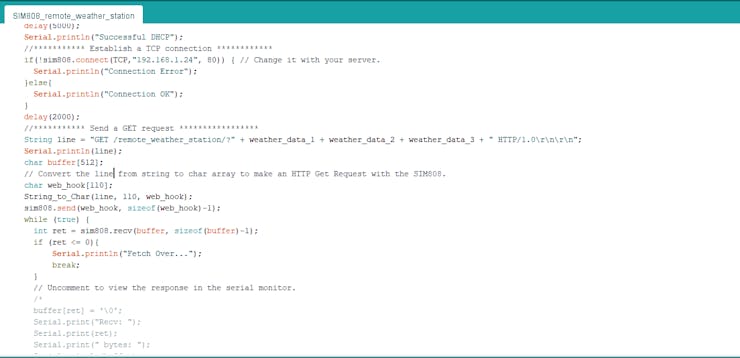

⭐ Send data packets every 5 minutes to the server by establishing a TCP connection to make a GET request.
transferring++; Serial.println("Time => " + String(transferring) + "s / " + String(int(5*60)) + "s\n\n");  if(transferring == 5*60){    //*********** Attempt DHCP *******************    while(!sim808.join(F("cmnet"))) {      Serial.println("Sim808 join network error!");      delay(2000);    }    //************ Successful DHCP ****************    delay(5000);    Serial.println("Successful DHCP");    //*********** Establish a TCP connection ************    if(!sim808.connect(TCP,"192.168.1.24", 80)) { // Change it with your server.      Serial.println("Connection Error");    }else{      Serial.println("Connection OK");    }    delay(2000);		...
⭐ After creating the line string, convert it from string to char array to make an HTTP Get Request with the SIM808.
...	    String line = "GET /remote_weather_station/?" + weather_data_1 + weather_data_2 + weather_data_3 + " HTTP/1.0\r\n\r\n";    Serial.println(line);    char buffer[512];    // Convert the line from string to char array to make an HTTP Get Request with the SIM808.    char web_hook[110];    String_to_Char(line, 110, web_hook);    sim808.send(web_hook, sizeof(web_hook)-1);    while (true) {      int ret = sim808.recv(buffer, sizeof(buffer)-1);      if (ret <= 0){          Serial.println("Fetch Over...");          break;       }	  	  ...
⭐ After uploading the code to the SIM808 shield, it displays weather data every second on the serial monitor and sends data packets every five minutes (300 seconds) to the PHP web application.

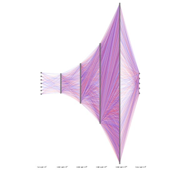

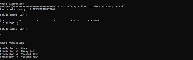

Step 5: Building an Artificial Neural Network (ANN) with TensorFlow
When I completed collating my preliminary local weather data set, I started to work on my artificial neural network (ANN) model to make predictions on the rainfall intensity.
I decided to create my neural network model with TensorFlow in Python. So, first of all, I followed the steps below to grasp a better understanding of the weather data:
After applying these steps, I decided to use my neural network model to classify different rainfall intensity classes theoretically assigned as labels (outputs) for each input (row). I created my classes according to the rate of precipitation, which depends on the considered time.
The following categories are used to classify rainfall intensity by the rate of precipitation (rainfall):
According to the precipitation (rainfall) rates, I preprocessed the weather data to assign one of these five classes for each input as its label:
After scaling (normalizing) and preprocessing the weather data, I elicited seven input variables and one label for each reading, classified with the five mentioned classes. Then, I built an artificial neural network model with TensorFlow to obtain the best possible results and predictions with my preliminary data set.
Layers:

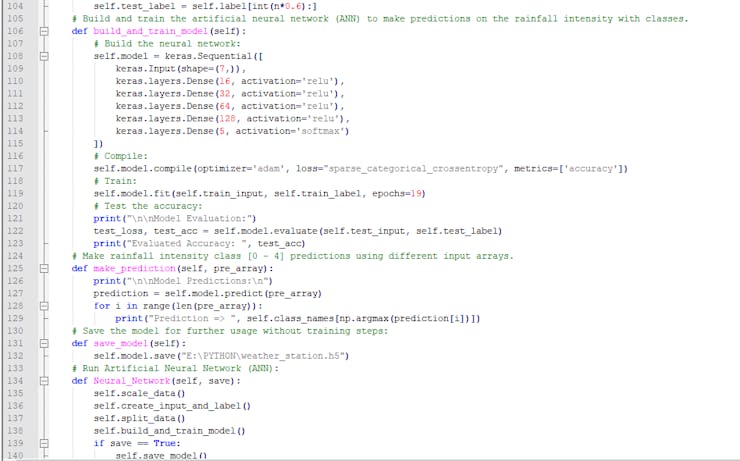

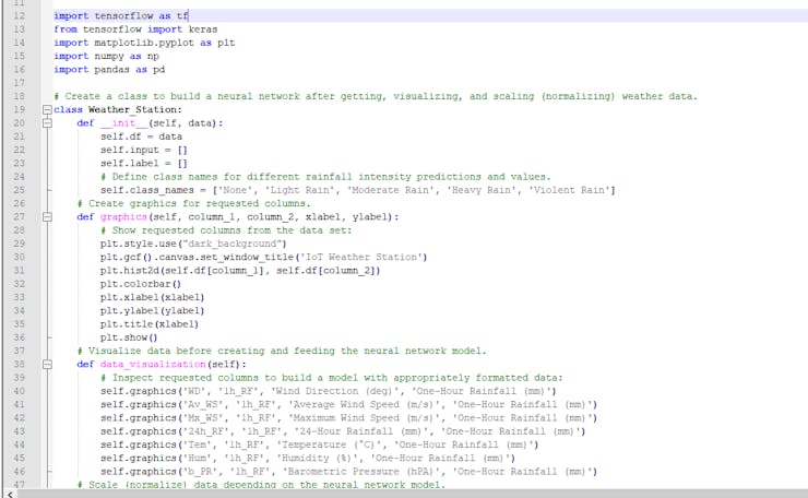

To execute all steps above, I created a class named Weather_Station in Python after including the required libraries:
import tensorflow as tffrom tensorflow import kerasimport matplotlib.pyplot as pltimport numpy as npimport pandas as pd
Subsequently, I will discuss coding in Python for each step I mentioned above.
Also, you can download IoT_weather_station_neural_network.py to inspect coding.
Step 5.1: Visualizing and scaling (normalizing) the weather data
Before diving in to build a model, it is important to understand the weather data to pass the model appropriately formatted data.
So, in this step, I will show you how to visualize weather data and scale (normalize) in Python.
⭐ First of all, read the weather data from Remote Weather Station.csv.
csv_path = "E:\PYTHON\Remote Weather Station.csv"df = pd.read_csv(csv_path)

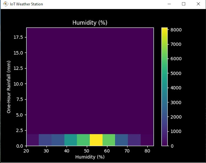

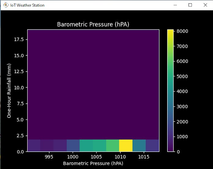

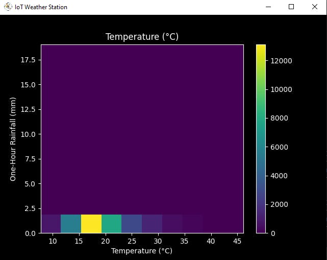

⭐ In the graphics() function, visualize the requested columns from the weather data set by using the Matplotlib library.
def graphics(self, column_1, column_2, xlabel, ylabel):        # Show requested columns from the data set:        plt.style.use("dark_background")        plt.gcf().canvas.set_window_title('IoT Weather Station')        plt.hist2d(self.df[column_1], self.df[column_2])        plt.colorbar()        plt.xlabel(xlabel)        plt.ylabel(ylabel)        plt.title(xlabel)        plt.show()
⭐ In the data_visualization() function, inspect all columns before scaling weather data to build a model with appropriately formatted data.
def data_visualization(self):        # Inspect requested columns to build a model with appropriately formatted data:        self.graphics('WD', '1h_RF', 'Wind Direction (deg)', 'One-Hour Rainfall (mm)')        self.graphics('Av_WS', '1h_RF', 'Average Wind Speed (m/s)', 'One-Hour Rainfall (mm)')        self.graphics('Mx_WS', '1h_RF', 'Maximum Wind Speed (m/s)', 'One-Hour Rainfall (mm)')        self.graphics('24h_RF', '1h_RF', '24-Hour Rainfall (mm)', 'One-Hour Rainfall (mm)')        self.graphics('Tem', '1h_RF', 'Temperature (°C)', 'One-Hour Rainfall (mm)')        self.graphics('Hum', '1h_RF', 'Humidity (%)', 'One-Hour Rainfall (mm)')        self.graphics('b_PR', '1h_RF', 'Barometric Pressure (hPA)', 'One-Hour Rainfall (mm)')

Step 5.2: Training the model (ANN) on the rainfall intensity classes
Before building and training a neural network model in TensorFlow, I needed to create the input array and the label array by preprocessing the scaled and normalized weather data set.
⭐ In the create_input_and_label() function:
⭐ Firstly, append each input element as a NumPy array to the input array and convert it to a NumPy array by using the asarray() function.
⭐ Each input element includes seven variables [shape=(7, )]:
def create_input_and_label(self):        n = len(self.df)        # Create the input array using the scaled variables:        for i in range(n):            self.input.append(np.array([self.df['scaled_WX'][i], self.df['scaled_WY'][i], self.df['scaled_max_WX'][i], self.df['scaled_max_WY'][i], self.df['scaled_Tem'][i], self.df['scaled_Hum'][i], self.df['scaled_bPR'][i]]))        self.input = np.asarray(self.input)				...
⭐ Then, evaluate the approximate rainfall (precipitation) rate for each reading (row).
approx_RF_rate = (1h_RF + scaled_24h_RF) * 100
⭐ According to the rainfall rate, assign a class [0 - 4] for each input element and append them to the label array.
...		        for i in range(n):            _class = 0            # Evaluate the approximate rainfall rate:            approx_RF_rate = (self.df['1h_RF'][i] + self.df['scaled_24h_RF'][i]) * 100            # As labels, assign classes of rainfall intensity according to the approximate rainfall rate (mm):            if approx_RF_rate == 0:                _class = 0            elif approx_RF_rate < 2.5:                _class = 1            elif 2.5 < approx_RF_rate and approx_RF_rate < 7.6:                _class = 2            elif 7.6 < approx_RF_rate and approx_RF_rate < 50:                _class = 3            else:                _class = 4            self.label.append(_class)        self.label = np.asarray(self.label)
After preprocessing the scaled weather data to create input and label arrays, I split them as training (60%) and test (40%) data sets:
def split_data(self):        n = len(self.df)        # (60%, 40%) - (training, test)        self.train_input = self.input[0:int(n*0.6)]        self.test_input = self.input[int(n*0.6):]        self.train_label = self.label[0:int(n*0.6)]        self.test_label = self.label[int(n*0.6):]
Then, I built my artificial neural network (ANN) model by using Keras and trained it with the training data set for nineteen epochs.
You can inspect these tutorials to learn about activation functions, loss functions, epochs, etc.
def build_and_train_model(self):        # Build the neural network:        self.model = keras.Sequential([            keras.Input(shape=(7,)),            keras.layers.Dense(16, activation='relu'),            keras.layers.Dense(32, activation='relu'),            keras.layers.Dense(64, activation='relu'),            keras.layers.Dense(128, activation='relu'),            keras.layers.Dense(5, activation='softmax')        ])        # Compile:        self.model.compile(optimizer='adam', loss="sparse_categorical_crossentropy", metrics=['accuracy'])        # Train:        self.model.fit(self.train_input, self.train_label, epochs=19)				...
After training with the preliminary training data set, the accuracy of the model is between 0.83 and 0.85.
Step 5.3: Evaluating the model and making predictions on the rainfall intensity
After building and training my artificial neural network model, I tested its accuracy by using the preliminary testing data set.
For now, the evaluated accuracy of the model is between 0.72 and 0.73 due to inadequate testing data set overfitting the model. However, I am still collecting weather data to improve the model accuracy.
...			# Test the accuracy:        print("\n\nModel Evaluation:")        test_loss, test_acc = self.model.evaluate(self.test_input, self.test_label)         print("Evaluated Accuracy: ", test_acc)
Then, I used my neural network model to make predictions on the rainfall intensity with a given prediction array consisting of readings from the weather station after the training of the model. As a starting point, the model works fine :)
The model predicts possibilities of labels for each input element as an array of 5 numbers. They represent the model's "confidence" that the given input element corresponds to each of the five different classes of rainfall intensity [0 - 4].
⭐ In the make_prediction() function, make a prediction for each input element in a given array and get the most accurate label [0 - 4] by using the argmax() function to display its class name.
def make_prediction(self, pre_array):        print("\n\nModel Predictions:\n")        prediction = self.model.predict(pre_array)        for i in range(len(pre_array)):            print("Prediction => ", self.class_names[np.argmax(prediction[i])])
Prediction Inputs:
Prediction Outputs:
Connections and Adjustments (ESP8266)
// Connections// NodeMCU ESP-12E (ESP8266) :           //                                Weather Station// VV  --------------------------- 5V// D5  --------------------------- RX// D6  --------------------------- TX// G   --------------------------- GND
I connected the sensor (converter) board to the NodeMCU ESP-12E (ESP8266) development board and fastened them to a plastic box while collecting weather data at my balcony.
Connections and Adjustments (SIM808)
// Connections// Arduino Uno:           //                                SIM808 GPS/GPRS/GSM Shield For Arduino// D0  --------------------------- RX// D1  --------------------------- TX// D12 --------------------------- POWER          //                                Weather Station// 5V  --------------------------- 5V// D5  --------------------------- RX// D6  --------------------------- TX// GND --------------------------- GND
⭐ Note: D0, D1, D12 pins are occupied by the SIM808 GPS/GPRS/GSM Shield.
⭐ Connect an external battery (7-23V) for the SIM808 module to work properly.
⭐ Attach the GPS antenna and the GSM antenna to the SIM808 shield.
⭐ Insert a SIM card into the SIM slot on the SIM808 shield.
⭐ Before uploading the code, set the function switch on the shield to None (1).
⭐ Upload the code.
⭐ Then, set the function switch to Arduino (3).
⭐ Press the Boot button on the shield until seeing the Net indicator LED flashing every 1 second and wait for the SIM card to register the network - the Net indicator LED will slowly flash every 3 seconds.
⭐ Click here to get more information about the SIM808 GSM/GPS/GPRS Shield.
After setting up the SIM808 shield with Arduino Uno, I connected the sensor (converter) board to it.
I placed all components into a plastic box to collect weather data outside, even in extreme weather conditions, since the sensor board is not weather-proof.
Then, I fastened the plastic box to the weather station.

After completing coding and assembling the weather station, I collated local weather data for more than three months every five minutes to build my neural network model successfully.
I am still collecting weather data at my balcony and backyard to improve my neural network model and its accuracy :)
