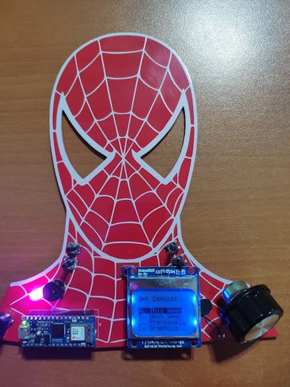

Then, I used an Arduino Nano 33 IoT to get comics release lists transferred by the PHP web application and display them with a Nokia 5110 Screen.

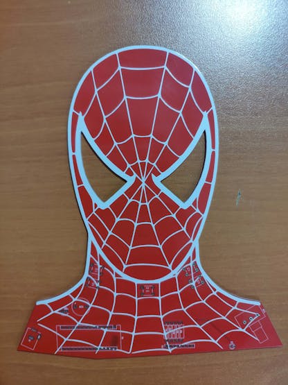

After completing wiring on a breadboard and testing the code, I designed a PCB (Comics Release List Tracker) inspired by one of my favorite comic book heroes: Spider-Man. It became a stylish and suitable addition to my comic book collection as an efficient new comics release list tracker with some spectacular features :)
The device shows the comics release list of:
  • This Week
  • Next Week
  • Previous Week
Also, it has these unnecessary yet funny additional features 😃
  • Plays the Spider-Man theme song (1967) before showing a list.
  • Displays graphics adjusted by a potentiometer.

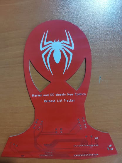

Step 1: Designing and soldering the Comics Release List Tracker PCB
Before prototyping my PCB design, I tested all connections and wiring with the Arduino Nano 33 IoT on the breadboard.
Then, I designed the Comics Release List Tracker PCB by using KiCad. I attached the Gerber file of the PCB below, so if you want, you can order this PCB from PCBWay to create a stylish and fully-functional weekly new comics release list tracker inspired by Spider-Man :)
Click here to inspect and order this PCB directly on PCBWay.
First of all, by using a soldering iron, I attached headers (female), buzzer, potentiometer, vibration motor, 5mm common cathode RGB LED, 6x6 pushbuttons, 1K resistors, and the power jack.

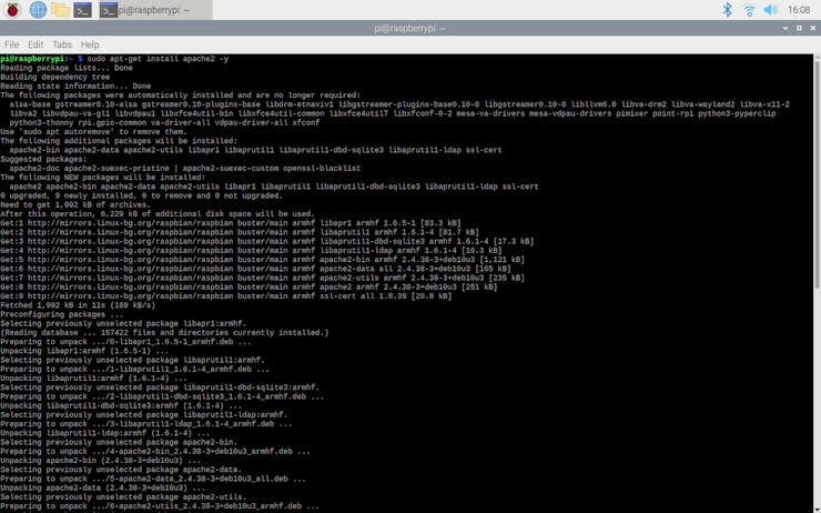

Step 2: Setting up a LAMP web server on Raspberry Pi
If you are a novice in programming with Raspberry Pi, you can inspect well-explained instructions and tutorials on the official Raspberry Pi website.
To go to the official Raspberry Pi setting up tutorial, click here.
⭐ Open a terminal window by selecting Accessories > Terminal from the menu.
⭐ Install the apache2 package by typing the following command into the terminal and pressing Enter:
sudo apt-get install apache2 -y

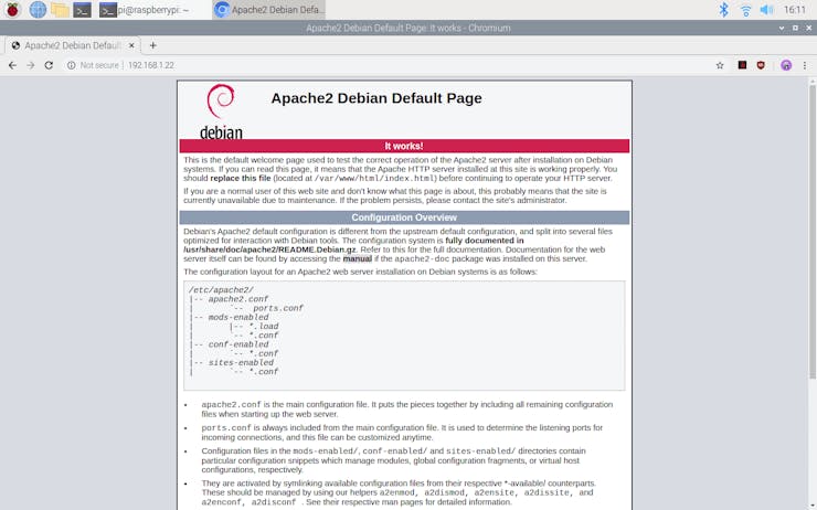

⭐ To test the server, open Chromium by selecting Internet > Chromium Web Browser from the menu and enter http://localhost.
⭐ If you want, you can use the IP address of your Raspberry Pi as well.
hostname -I

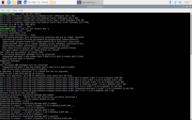

⭐ Install the PHP package with the following command:
⭐ Do not forget to update the Pi.
sudo apt-get update
sudo apt-get install php -y
⭐ To be able to utilize the ShortBoxed comics API, install the php-curl package:
sudo apt-get install php-curl
