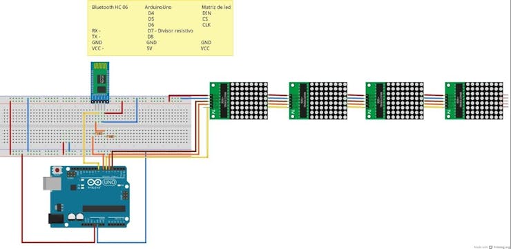

The project circuit with the LED matrix is shown in Figure 1.
Figure 1 - Schematic circuit with the Bluetooth module connections and the LED arrays to the Arduino Uno.
In this circuit the Bluetooth module is powered with a voltage of 5 V at the VCC terminal, however, its logic level is 3.3 V.
For this reason, the RX terminal of the Bluetooth module requires a resistive divider to attenuate the 5V voltage, which comes from the Arduino Nano.
If you do not use the resistive divider, the module will burn over time.
To calculate the resistive divisor, equation 1 is used:
Vout = ( R2 / R1 + R2) x Vin
3.3 = (10.000 / R1 + 10000) x 5
3.3 R1 + 33000 = 50000
3.3 R1 = 50000 – 33000
3.3 R1 = 17.000
R1 = 17.000 / 3.3
R1 = 5 KΩ
Therefore, we will use a 5k resistor and a 10k resistor in our resistive divider with the assembled circuit.

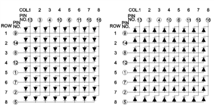

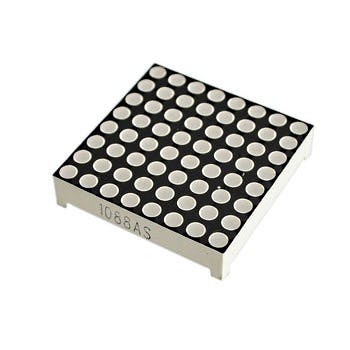

The Matrix Structure of 8x8 LEDs
The led matrix is a component that has 64 interconnected leds and distributed in 8 rows and 8 columns. The LED matrix is presented below.
Figure 2 - The LED Matrix.
It is made in order to facilitate the individual activation of each led.
So instead of 65 pins, it has only 16 pins.
This solution is achieved by interconnecting the LEDs by rows and columns. The LEDs of each column have the anodes interconnected and the LEDs of each line have the cathodes interconnected. But this configuration can change depending on the type of matrix used.
Currently, there are two types of the matrix on the market: common anode and common cathode.
In figure 3 we have the scheme of the two possible connections in a led matrix.
Figure 3 - Possible connections in a led matrix.
The figure on the left is a common cathode matrix and the other is a common anode.
Performing the matrix drive in this way would use many uC pins, so it is not very feasible.

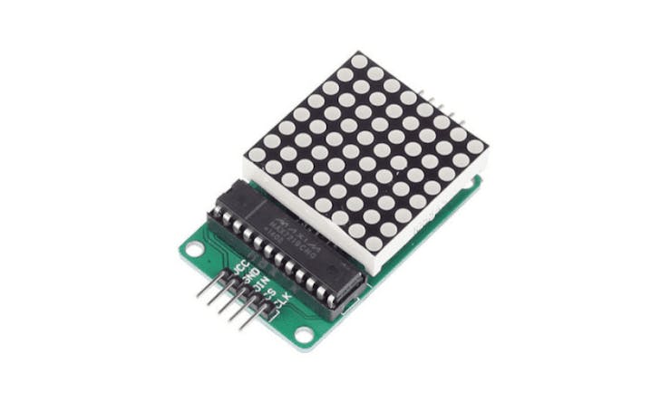

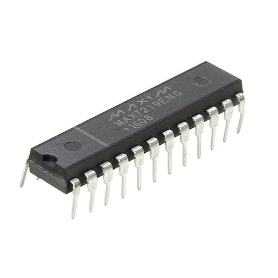

That way we will use a ready-made module that has a Ci Max 7219. It is dedicated to controlling this matrix using only 3 pins: Din, CS, CLK.
Using this ci we can control the 4 LED arrays using only 3 pins of the Arduino board. It, too, can be used to control 7-segment displays. For this, it receives and sends the received data serially to the led matrix or the 7-segment display.
In figure 5 we have the led matrix module with CI Max 7219.
Figure 5 - 8 x8 led matrix module with ci MAX 7219.

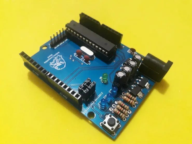

This project was developed with our Arduino-based board. You can download all the files and build your own Arduino-based board.
For this project, we'll use the JLCPCB Arduino Compatible printed circuit board presented below.

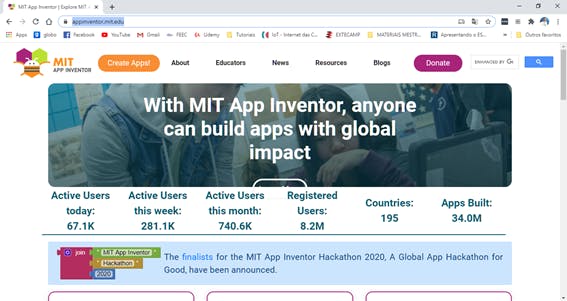

The MIT app inventor is a block programming platform for developing mobile applications and it can be accessed through the website https://appinventor.mit.edu/.
Figure 6 - AppInventor Website.

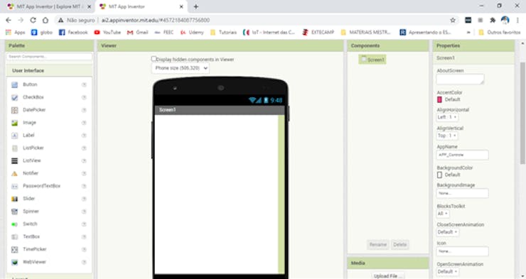

Create a google account, access the platform, and click on Create apps.

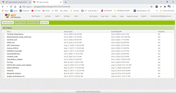

Figure 7 - App Inventor home screen.

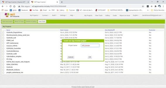

Click Start new projects to start creating a new project.
 Figura 8 – Criando um novo projeto no App Inventor

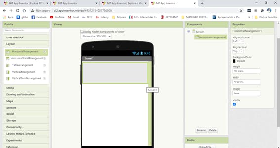

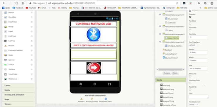

The App Inventor is divided into two parts: graphics and blocks. The graphic part, as shown in figure 9, creates screens with buttons, different colors, communication modes, and other features. This is seen in figure 9.
Figure 9 - Graphic part of APP Inventor.
The block part is where we carry out the programming of our application.
Figure 9 - App Inventor block programming part.

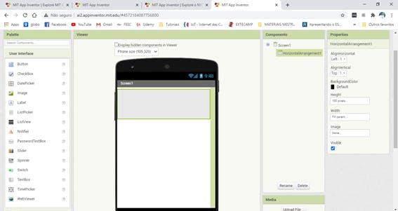

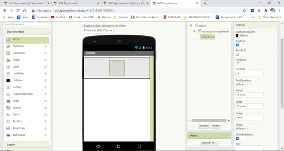

After starting a new project, we will use the component in a horizontal organization layout.
Figure 10 - Creating a new app.

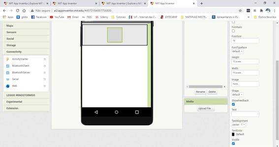

It is possible to change the size of the horizontal organization, color, position. In the user interface, we will choose a button.
Figure 11 - Choosing a button in APP Inventor
You can choose the properties of the size button, add an image, and enlarge the font.
Figure 12 - Button in APP Inventor.

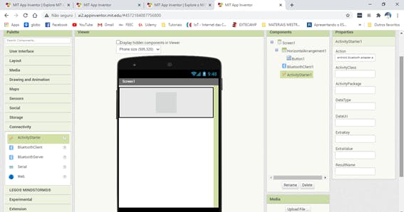

In connectivity, we will choose Bluetooth client.
Figure 13 - Bluetooth client.
Clicking on Active Starter in action put the instruction presented below.
android.bluetooth.adapter.action.REQUEST_ENABLE
 Figurae 14 – Active Starter.

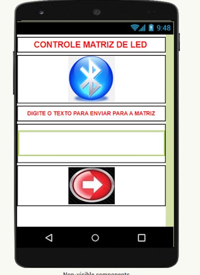

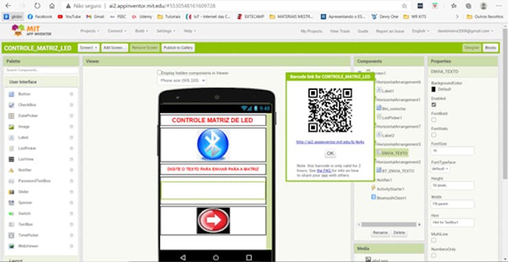

We will use the textbox component to write a text that will be sent to the LED matrix. The application screen layout will be as shown in figure 15.
Figure 15 - Screen App.

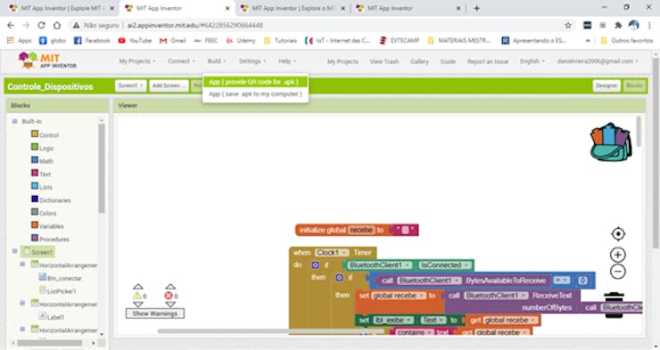

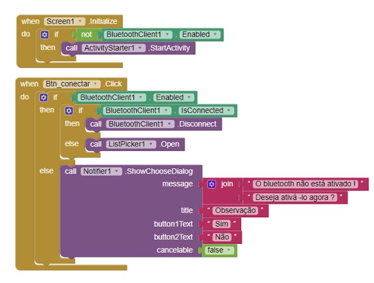

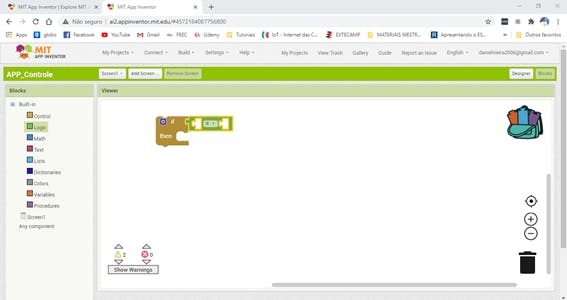

After finishing the aesthetic part of the application, we go to the application programming using the APP Inventor block language.
When the application is opened, the application checks whether Bluetooth is enabled, if not, it asks to enable as shown in figure 16.
When the connect button is pressed it performs a series of checks, opens a list of paired devices, and allows the user to choose which device to connect to and connects to Bluetooth.
Figure 16 - Logic programming.

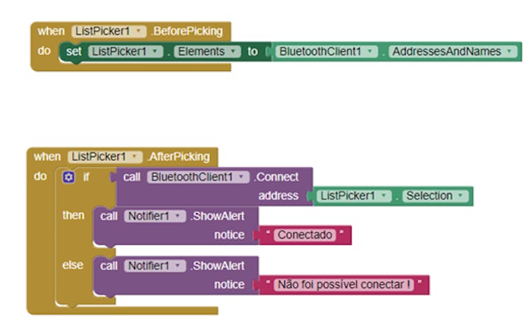

Before connecting, set up to display the paired devices. The logic is shown in figure 17.
Then the notification appears after connecting to the device.
Figure 17 - Code of the list of paired devices

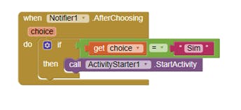

Notification that enables Bluetooth if it is disabled when the application is opened.
Figure 18 - Code to enable bluetooth if it is disabled.

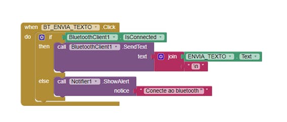

When the button sends text is pressed, the APP checks if the Bluetooth is connected if there is no notification asking you to connect to Bluetooth.
If connected, Bluetooth sends the text in the text box and then sends the character \ n that indicates the end of the message as explained in the Arduino code.
Figure 19 - Code for when the button sends text is pressed

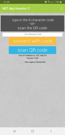

To use this application on your phone, you need to install the MIT AI2 Companion application available on the Playstore on your phone.
With this app, we will scan the QR code generated by our app and install our app developed on the phone.
Figure 20 - Mit AI2 Companion application.
With this application, we will scan the QR code of our application generated by the platform.
On the website click on build and QR Code.
Figure 21 - Generating QR code of the developed application.
Figure 22 - QR code of the developed application

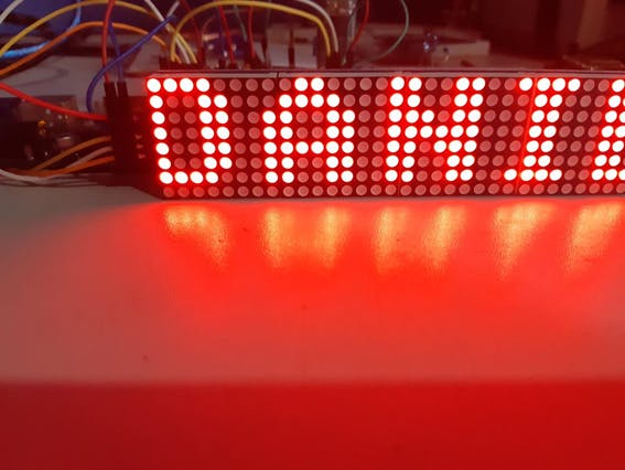

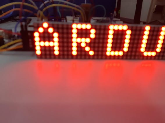

With the application installed on the phone and the Arduino programmed we will test the project.
Now, let's look at the outcome of the project.
Project results
When opening the application it connects to the Bluetooth connection to the Arduino.
With the Bluetooth connection, we will type the text in the field and click on the arrow to send the text to the Arduino write on the led matrix.
Figure 23 - Application developed.
Figure 24 - Text being displayed in the matrix.
Figure 25 - Text being displayed in the matrix.
