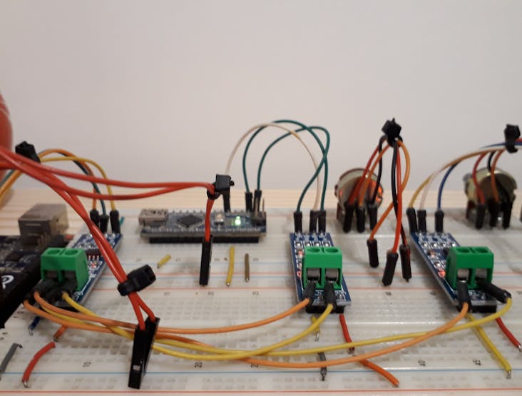

The project consists of 3 Arduino's. We have an Arduino UNO, a Nano, and a MEGA. The Arduino UNO will control the other 2 and send commands to receive the reading of the analog signal from the potentiometer connected to each Arduino.
He will receive the signal and present it on the LCD screen.
This communication will be developed through the use of RS-485 modules. See the circuit below.

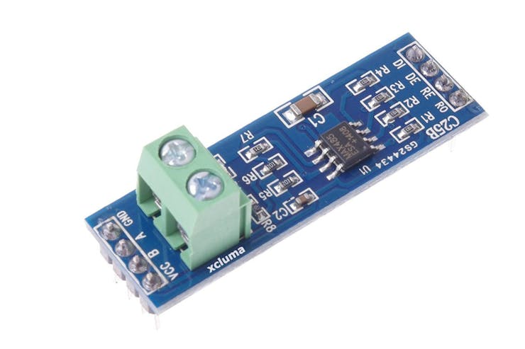

To make this communication we use the Arduino MAX485 module. This module will allow us to interconnect the devices and carry out our communication. See the photo of the module.
The board presents the complete circuit for you to transfer and receive data between the boards. The connecting pins are quite easy for you to learn.
Observe the figure and see that it is formed by 8 pins: DI, DE, RE,R0,VCC, A, B, and GND.
Shall we understand the function of each of them?
Pins DI and R0 are used to transmit data (DI - Data Input) and receive data (RO - Received Output). Connect the TX pin to the DI and the RX to the RO.
The configuration of the data transfer or reception mode is done through the DE and RE pins. The first thing you must do is connect the pins with a jumper.
Then, you must apply 5V to put the circuit in transfer mode and 0V to receive data. See the circuit in the figure and analyze the connection on the DE and RE pins.
In addition to these pins, we have VCC, A, B, and GND. The VCC and GND are used to supply the module circuit, while A and B will be responsible for transmitting information from one module to another with RS-485 voltage levels.
All pins of Letter A must connect to each other. This rule also applies to B.

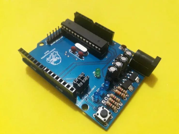

For this project, we'll use the JLCPCB Arduino Compatible printed circuit board presented below.
You can obtain the Arduino JLCPCB compatible PCB for your projects for $2 in your first order with the link: Earn my PCBs Arduino Compatible.
Use the JLC-RECE coupon,earn a $2 off discount, and earn FREE5 PCBs.
Access the link and download the Gerber files of the JLCPCB Arduino Compatible Printed Circuit Board.

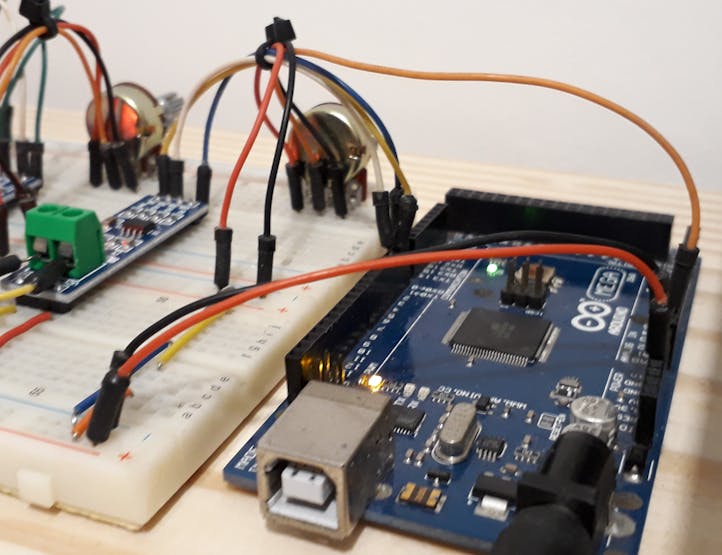

The master Arduino is responsible for the communication control, that is, only he can initiate communication with the slaves. In our project, Arduino UNO is the master of this communication.

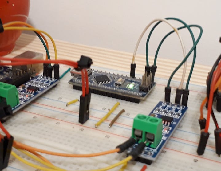

Slave Arduino's only obey commands sent by the master. Arduino NANO and MEGA are Arduino's slaves.

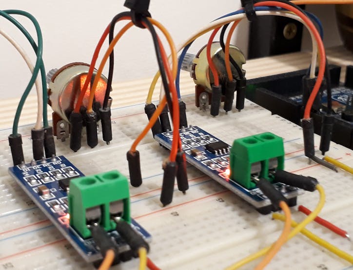

See the figure below. We present 2 potentiometers. Each one is connected to each slave.

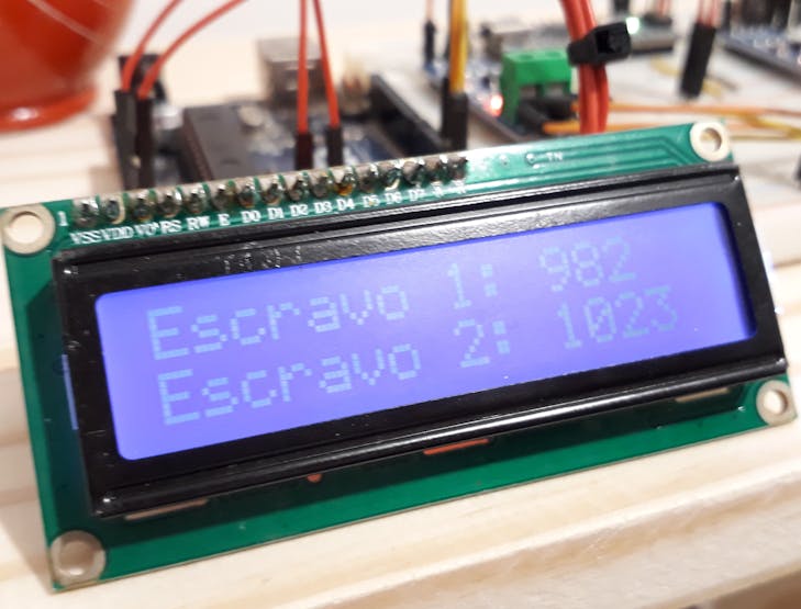

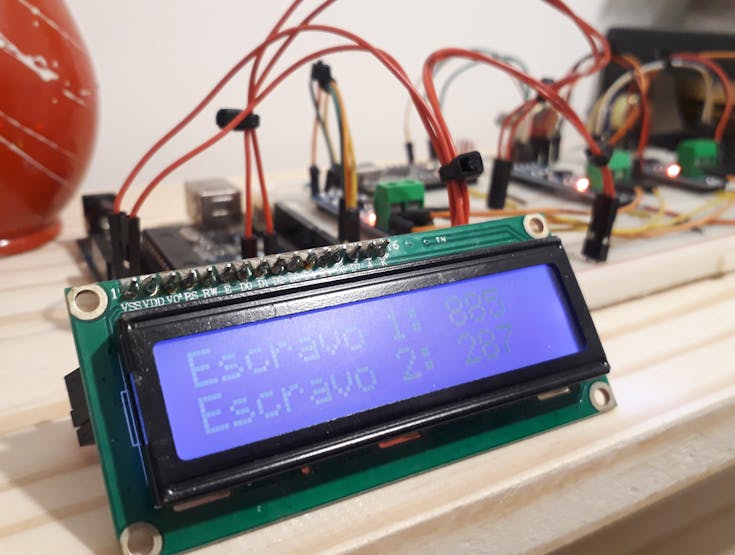

If the information received is from slave 1, the condition will be true and the Arduino will present the information received on line 1 of the LCD. See the image below.
The image below shows the result of the reading of slave 1 and slave 2 presented by the master.

After sending this message, the Arduino master waits for the response from slave 2 and shows the value on the LCD screen. The result can be seen in the figure below.

The slave Arduino code was built to receive and recognize the command sent by the master Arduino. The slave code is simple and is used for slave 1 and 2. See below.
const int Enable =  2; const int SlaveNumber = 1;void setup() {   Serial.begin(9600);    Serial.setTimeout(250);  pinMode(Enable, OUTPUT);  digitalWrite(Enable, LOW);  pinMode(13, OUTPUT);  pinMode(A0, INPUT);} void loop() {   if(Serial.available())  {    if(Serial.read()=='I')    {           int Slave = Serial.parseInt();        if(Slave == SlaveNumber)        {               char command = Serial.read();                                 if(command == 'L')             {                if(Serial.read()=='F')                 {                   int AnalogValue = analogRead(0);                                           digitalWrite(Enable, HIGH);                                      Serial.print("i");                   Serial.print(SlaveNumber);                      Serial.print(AnalogValue);                   Serial.print("f");                   Serial.flush();                                      digitalWrite(Enable, LOW);                            }             }                     }    }  }  delay(10);}
The first thing you define is a constant for the communication configuration pin for the RS-485 Module. After that, we inform the number of our slave. The code was used for slave 1. See the code below.

This is how the communication and message exchange process between the master and the network of slaves works. See the connection circuit below.
This code is the same for any other slave. Change the number to add new slaves to your network.
