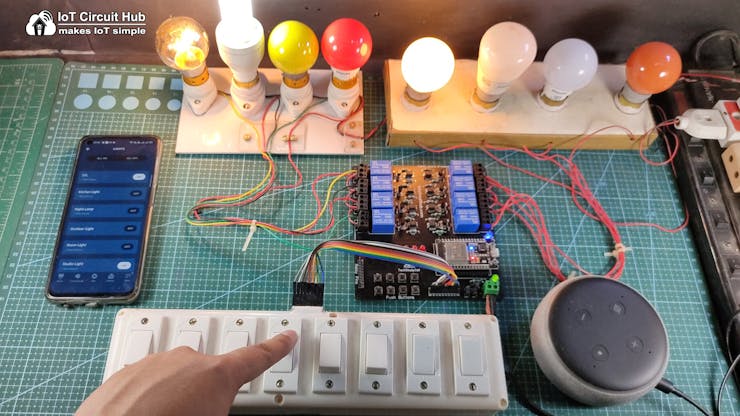

In this IoT project, I have shown how to make an IoT-based ESP32 Alexa Smart Home System to control 8 home appliances from the manual switch & Amazon Alexa App. If the internet is not available, then you can control the home appliances from manual switches. During the article, I have shown all the steps to make this home automation system.
This ESP32 control smart relay has the following features:
- 1. Control home appliances with voice commands using Alexa
- 2. Control home appliances with manual switches.
- 3. Monitor real-time feedback in the Alexa App.
- 4. Control home appliances manually without internet.
- 5. Just need Echo Dot. No third-party app required.

The circuit is very simple, I have used the GPIO pins D23, D22, D21, D19, D18, D5, D25 & D26 to control the 8 relays.
And the GPIO pins D13, D12, D14, D27, D33, D32, D15 & D4 connected with switches to control the 8 relays manually.
I have used the INPUT_PULLUP function in Arduino IDE instead of using the pull-up resistors.
I have used a 5V mobile charger to supply the smart relay module.
Testing the Circuit Before Designing the PCB:
If the ESP32 module is connected with the WiFi, then you can control the home appliances from Amazon Alexa App and also from the manual switches.
You can control, monitor the real-time status of the relays in the Alexa App. The ESP32, Amazon Echo Dot should be connected to the same WiFi network.
Control Relays Manually With Switches:
If the WiFi is not available, you can control the relays from the manual switches.
The ESP32 will check for the WiFi after every 3 seconds. When the WiFi is available, the ESP32 will automatically connect with the WiFi.
Please refer to the circuit diagram to connect the manual switches.
