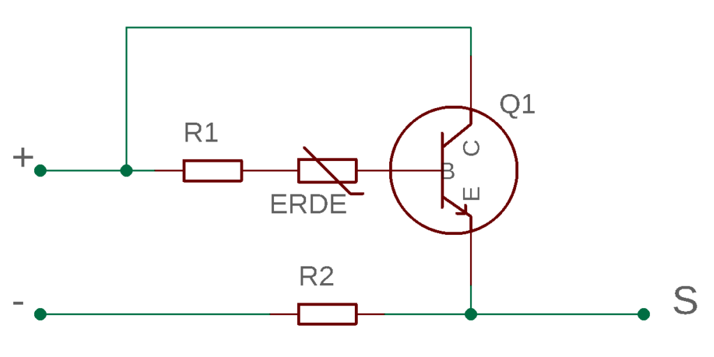

Either one of the following sensor types can be used for the moisture measurement (sensor output here connected to ADC0/GP26):
  • Capacitive type sensor HW-390 (also referred to as v2.0)
  • Resistive type sensor ME110
An initialization routine identifies the connected sensor type (see MicroPython code in my github repo). The capacitive probe should be preferred though since that is the durable sensor that won't corrode - the anode metal of the ME110 will have vanished after a few hours of operation.

The schematic for the most recent prototype.
