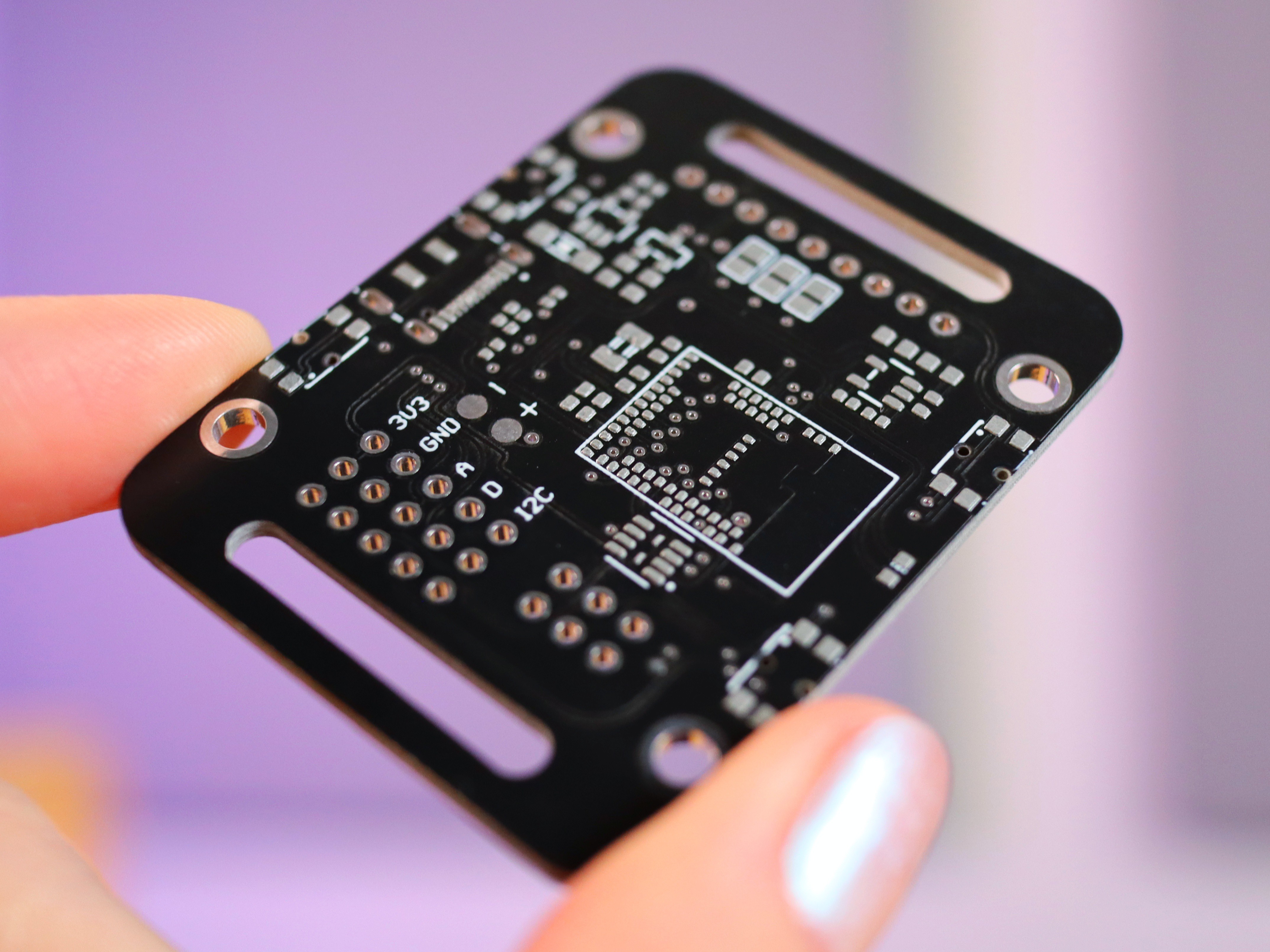

PCB Design
For the PCB format, we went for the smartwatch shape, since we want to use it as a wearable, but it can also be enclosed in a case, as we did for our first field test when we needed a small remote for a RaspberryPi prototype.
We've also added mounting holes for the display and our logo on the back:
PCB Assembly
We've ordered the PCBs from JLCPCB in matte black, along with a custom-sized stencil, which is smaller and easier to use than the default sized one.

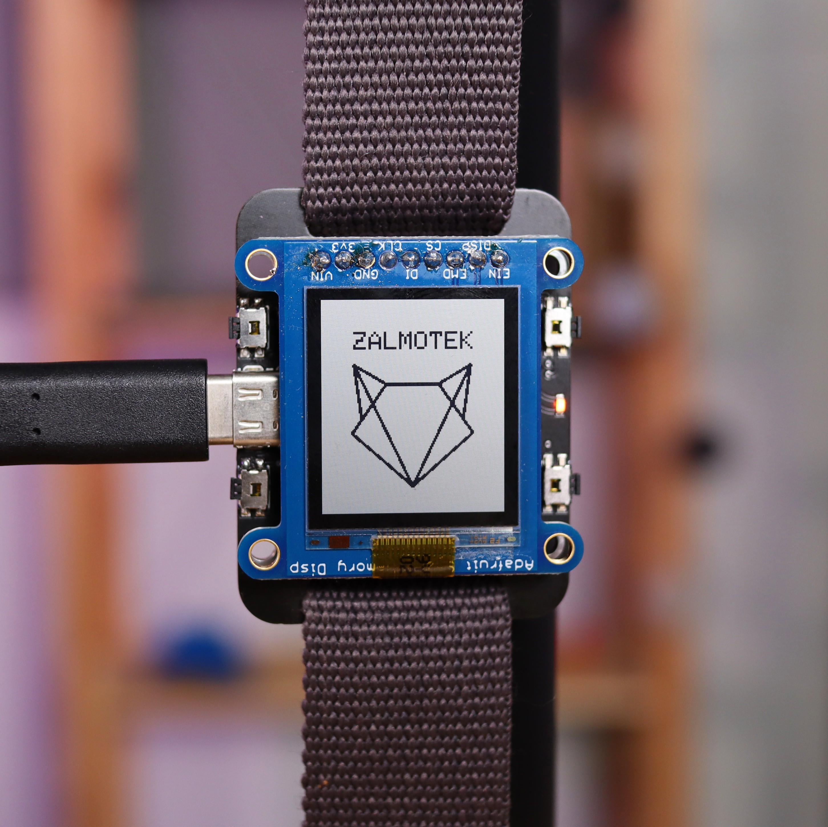

First prototype
And here's the assembled wearable, we managed to convert our logo to a bitmap array using this handy tool and we printed it on the display! :D
