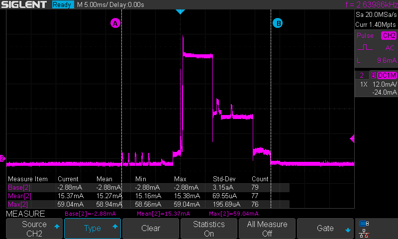

In the lowest TX power setting, measuring/transmitting takes about 30ms and consumes 11.6 mA on average. In the hightest TX power setting (see image below) the 30ms stay unchanged but the average consumption goes up to 18.2mA. The image shows the current drawn from a 1.25V lab power supply - using a uCurrent in mA setting.
On the image you can see the different stages after wakeup:
  1. Sensor measurement
  2. Encryption
  3. TX @ 13dBm
  4. RX of acknowledgment
  5. Decryption

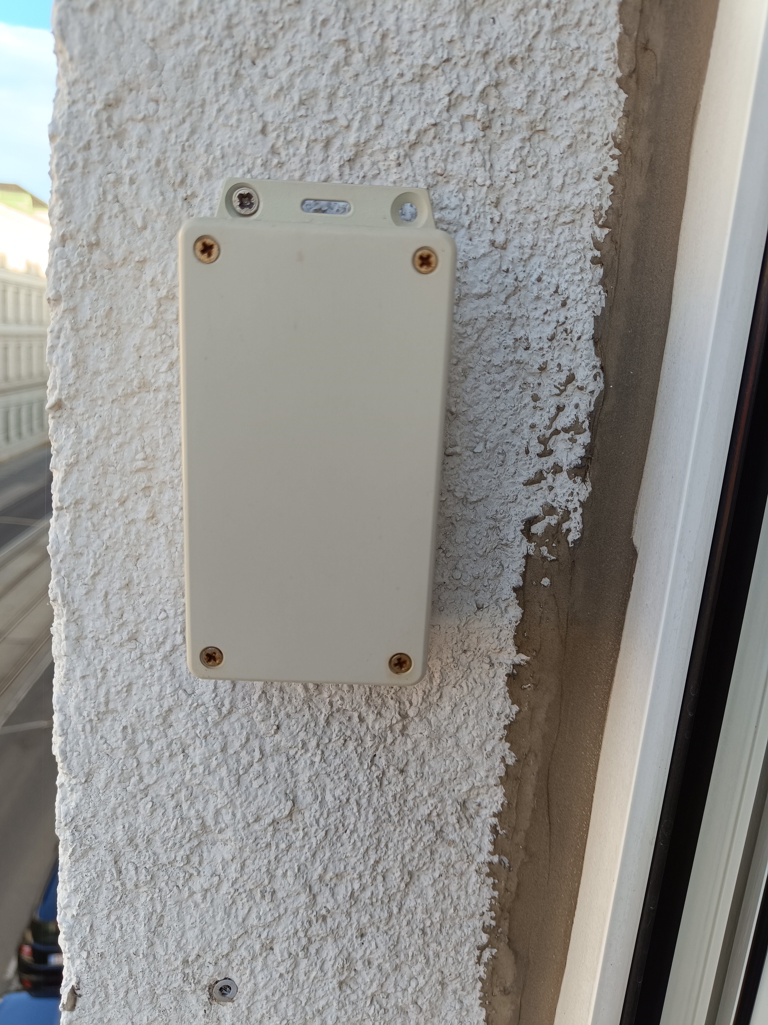

  • This is how rev 0.4 looks like after 5 years
    canique • 04/05/2026 at 16:07 • 0 comments
    The ABS enclosure has gotten a bit yellowish, but it's still working after 5 years with battery voltage showing around 1.39V
