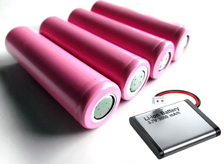

We are going to use 18650 3.7v Li-ion rechargeable battery pack for this project, this batteries are getting charged when the sunlight is available and give power to LEDs during charge or at night time.
*Note- Li-ion batteries have high current rating, may be the short circuit caused the fire so stay safe during work.
