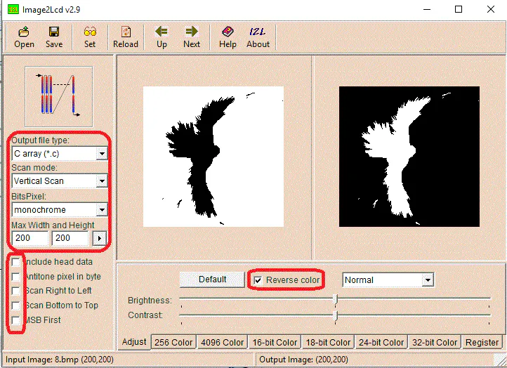

Image to Code Conversion
Monochromatic Bitmap images of 200 x 200 pixels are converted to code with Image2Lcd program according to following settings.
Image 2 LCD
These settings are critical, any deviation from these settings (marked in red polygon) might corrupt/mirror/rotate image output.
Placing image data in code imagedata.cpp
Each image/frame of 200 x 200 pixels is converted to hex data and copied to arduino IDE for flashing in the xmc1100 mcu.
Updating the header file imagedata.h is also required.
Updating imagedata.h header file
