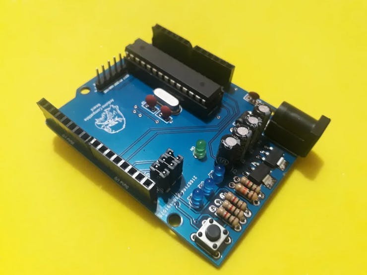

The Arduino is the control board that is responsible for controlling the motors and reading the signal from the ultrasonic sensor of the mobile robot.
It was positioned in the rear region of the robot, to facilitate the programming of the robot and changes in the code. This prevents the user from removing the Arduino.
Figure 8 shows the Arduino installed in the autonomous mobile robot.
The control board is shown below and has the Arduino UNO format. All sensors and drive drivers will be connected in their structure.
The control board is responsible for receiving control commands via Bluetooth or sensors. Based on the information received, it will activate the drivers so that the motors can move the robot in a certain direction.
