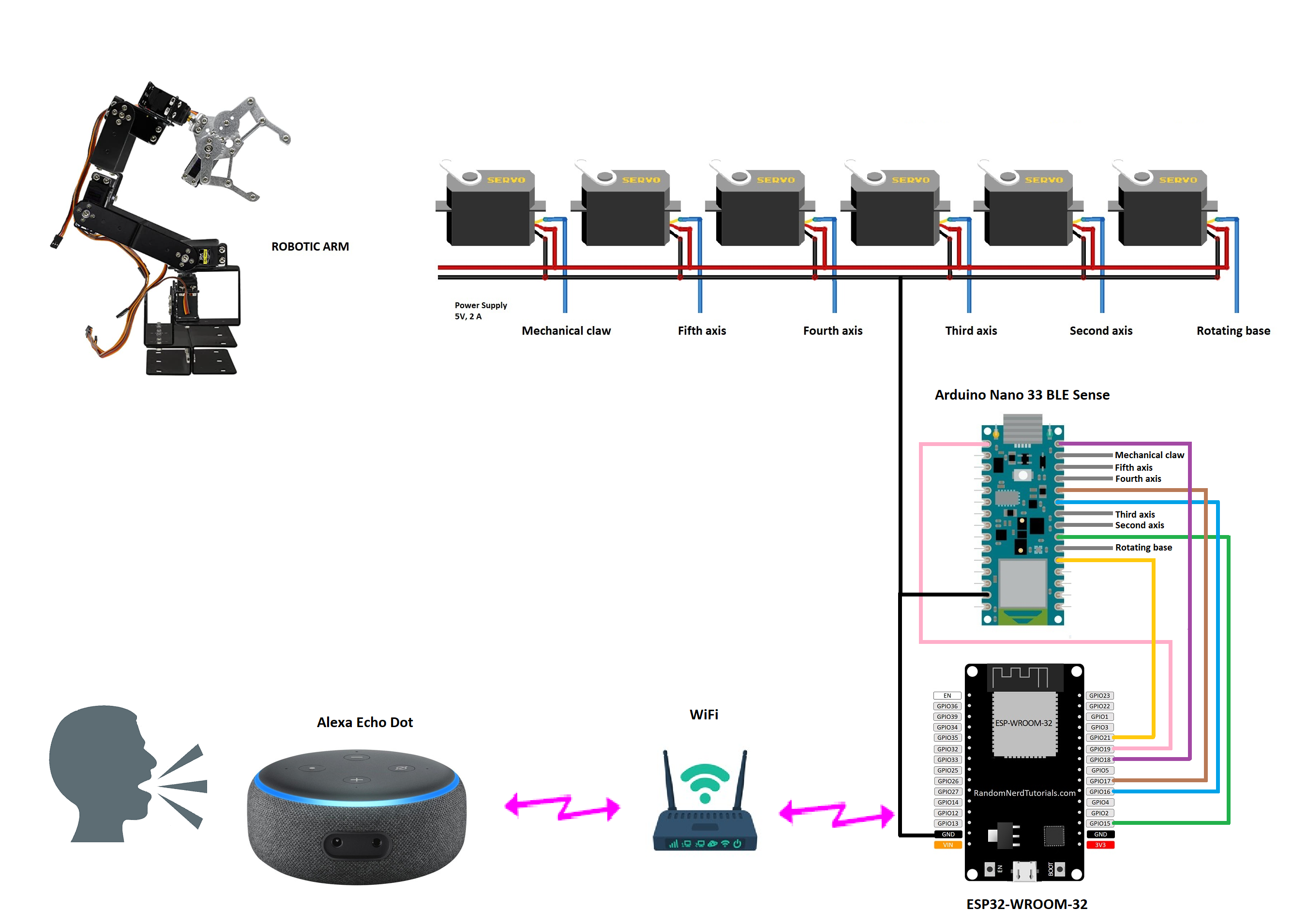

As part of the continuous improvements, in this prototype I experimented with different hardware and software and using free open source tools as shown below.
HARDWARE
The schematic diagram below shows the electrical connections of the electronic components.
How does it work?
  1. We use voice commands to perform three functions: 1) controlling a bottle; 2) controlling a plate; and 3) controlling a box.
  2. The voice commands are activated through Alexa Echo Dot, and they reach the ESP32-WROOM-32 board via WiFi.
  3. Finally, these voice commands are transmitted to the Arduino Nano 33 BLE Sense board, which controls the robot arm.
