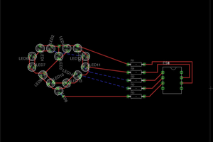

A daughter board that mounts on a 3D printer hotend assembly to enable all wiring over RJ45
Rather than wiring all devices directly from the 3D printer electronics panel to the hotend assembly, this board allows you to connect two simple RJ45 wires between the boards, and then wire the devices directly using the JST-XH and JST-VH connectors. One board mounts to the hotend, the other mounts on the electronics panel. It then makes it simple to swap out a hotend without rewiring everything. It significantly cleans up the wiring and reduces maintenance and upgrading headache. Note: this board was originally designed to lay flat with 40x40mm dimensions, but a similar project by "Minty Trebor" on The RatRig Discord chat inspired me to alter the design.
This board is designed specifically as an addon for the EVA 2 3D project which enables modular 3D printer hotend assemblies using standard adapters and 3D printed parts.
The v2 of this board is designed to route wiring for the hotend heater cartridge or the hotend thermistor.
Board design notes
  • PCB traces to RJ45 and JST-XH connectors (small) are 0.500mm and should handle 1A of current on each pin
  • PCB traces to JST-VH connectors (large) are 3mm and should handle 3.9A of current on each pin (2A tested), but could possibly handle more since the traces are duplicated on both sides
  • GND is connected to the M3 mounting holes and shared with other pins labeled GND
  • JST-XH/JST-VH connectors are recommended, but other connectors/pin headers may be used
  • RJ45 connectors are shielded but don't contain LEDs, so the board draws 0mA current.
  • The board is mounted using 2 screws and sits between the universal_cable_mount  and cable_holder -- it doesn't require 3D printing additional parts.

    Here's a view of the final front and back of the PCB:
    A few things to note:
    • I labeled the high-current pins with letters instead of numbers, since they don't map to the RJ45 numbered pins. With this information, it should be quite obvious how to correctly crimp the JST-VH cable assemblies.
    • I added some openings to separate the high-current connectors from the low-current connectors, as a way to isolate the signals and provide a way for heat to escape (probably overkill haha).
    • On the front of the PCB, I labeled where I think the thermistor, parts fan, and heater should be wired, but those are completely optional.
    • The JST-VH connectors do not share GND, which provides additional wiring and voltage flexibility (ex: a 5V parts fan can be used and powered by a totally separate 5V power supply).
    • There are actually two (2) connectors labeled "PARTS FAN", that's to allow for either 1) wiring a 3-pin or 4-pin fan (ex: GND, PWR, PWM, SPEED) or 2) wiring a third non-PWM (2-pin) fan or other device. If a PWM fan is used, I recommend wiring GND and PWR through the high-current connectors (even if it's a low-current fan), and using pin 2 on the JST-XH for the PWM signal (and not wiring the GND on the JST-XH connector).
