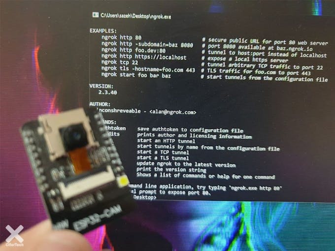

  • ESP32-CAM module

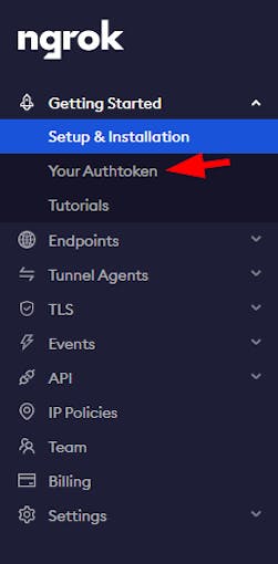

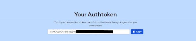

After completing the previous steps, such as uploading the code and receiving the local ip, we must go to the startup of ngrok prerequisites and send the images to the cloud using the relevant commands. First, from the left tab on the ngrok site, click on Your Authtoken option.
In this section, you will encounter a multi-character code that consists of a sum of several letters and numbers. This code is for your account only and should not be passed on to anyone else, in which case you can reset it from the settings.

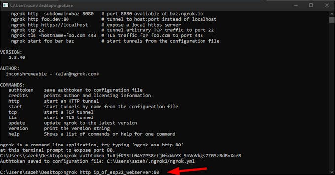

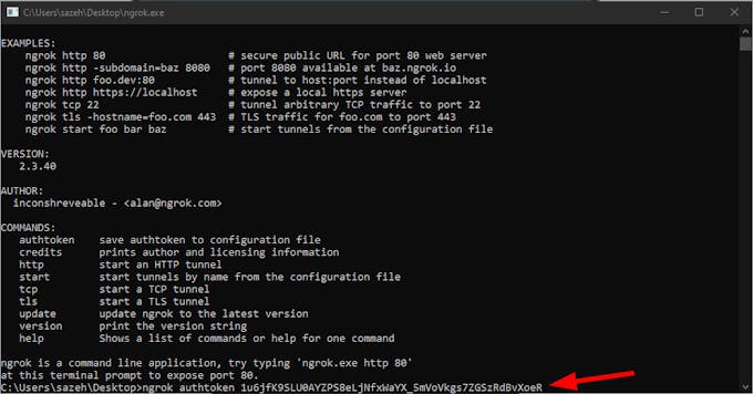

In the next step, run the terminal that we downloaded and enter the following command along with the Authtoken that you received.
Then in the next line, enter the following command with the local ip that you received, in the part that is written ip_of_esp32 then press enter.

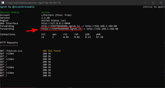

1ngrok http 192.168.1.103:80
In the following, you will encounter the following information with a new window that gives you links to access the web server via the cloud. You will be able to access your web server by searching for the link specified in the image from anywhere and with any device.

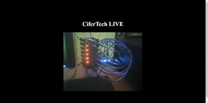

Finally, by searching for the link in the browser, you will receive the image instantly.
