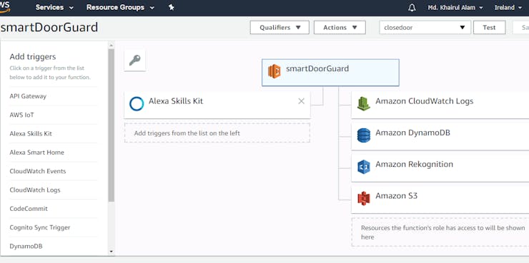

Alexa triggers a Lambda function and the Lambda function does the following jobs:
  • Read the image uploaded to the S3 Bucket.
  • Sends a face search request for the image to AWS Rekognition.
  • After getting the face matches, the result is returned by Rekognition, Lambda search for the name to AWS DynamoDB and returns the name to the Alexa if found.
Alexa provides the name to the house owner and the house owner again calls Alexa to open the door for the guest. In this case, Lambda sends an open door command to AWS IoT to a specific topic. Raspberry Pi receives this command and sends it to Arduino using the serial port. Arduino controls the lock accordingly. The following block diagram can help for better understanding.

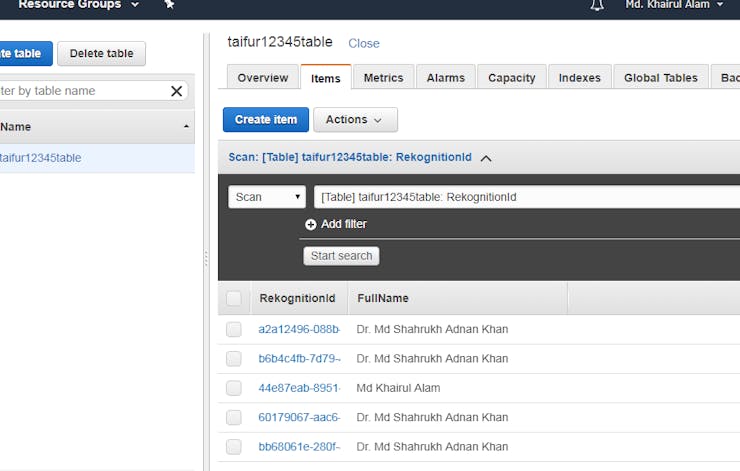

    Next, we create an Amazon DynamoDB table. DynamoDB is a fully managed cloud database that supports both document and key-value store models. In our example, we’ll create a DynamoDB table and use it as a simple key-value store to maintain a reference of the FaceId returned from Amazon Rekognition and the full name of the person.
    You can use either the AWS Management Console, the API, or the AWS CLI to create the table. For the AWS CLI, use the following command:
    aws dynamodb create-table --table-name guest_collection \
    --attribute-definitions AttributeName=RekognitionId,AttributeType=S \
    --key-schema AttributeName=RekognitionId,KeyType=HASH \
    --provisioned-throughput ReadCapacityUnits=1,WriteCapacityUnits=1 \
    --region eu-west-1

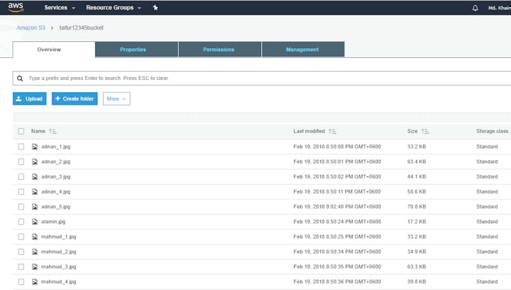

    For the IndexFaces operation, you can provide the images as bytes or make them available to Amazon Rekognition inside an Amazon S3 bucket. In our example, we upload the images (images of the known guest) to an Amazon S3 bucket.
    Again, you can create a bucket either from the AWS Management Console or from the AWS CLI. Use the following command:
    aws s3 mb s3://guest-images --region eu-west-1
    Although all the preparation steps were performed from the AWS CLI, we need to create an IAM role that grants our function the rights to access the objects from Amazon S3, initiates the IndexFaces function of Amazon Rekognition, and create multiple entries within our Amazon DynamoDB key-value store for a mapping between the face and the person’s full name.
    To get the access use the file: access-policy.json
        "Version": "2012-10-17",
        "Statement": [
                 "Effect": "Allow",
                 "Action": [
                    "logs:CreateLogGroup",
                    "logs:CreateLogStream",
                    "logs:PutLogEvents"
                    "Resource": "arn:aws:logs:*:*:*"
                 "Effect": "Allow",
                 "Action": [
                    "s3:GetObject"
                    "Resource": [
                         "arn:aws:s3:::bucket-name/*"
                "Effect": "Allow",
                "Action": [
                     "dynamodb:PutItem"
                "Resource": [
                    "arn:aws:dynamodb:aws-region:account-id:table/family_collection"
                "Effect": "Allow",
                "Action": [
                    "rekognition:IndexFaces"
                "Resource": "*"
    For the access policy, ensure you replace aws-region, account-id, and the actual name of the resources (e.g., bucket-name and family_collection) with the name of the resources in your environment.
    Now, attach the access policy to the role using the following command.
    aws iam put-role-policy --role-name LambdaRekognitionRole --policy-name \ LambdaPermissions --policy-document file://access-policy.json
    We can almost configure our AWS environment. We can now upload our images to Amazon S3 to seed the face collection. For this example, we again use a small piece of Python code that iterates through a list of items that contain the file location and the name of the person within the image.
    Before running the code you need to install Boto3. Boto3 is the Amazon Web Services (AWS) Software Development Kit (SDK) for Python, which allows Python developers to write software that makes use of services like Amazon S3 and Amazon EC2. You can find the latest, most up to date, documentation at Read the Docs, including a list of services that are supported.
    Install the Boto3 library using the following command:
    sudo pip install boto3
    Now, run the following python code to upload the images into S3 Bucket. Before running the code be sure that you keep all the images and the python file in the same directory.
    import boto3
    s3 = boto3.resource('s3')
    # Get list of objects for indexing
    images=[('afridi.jpg','Shahid Afridi'),
           ('sakib.jpg','Sakib Al Hasan'),
           ('kohli.jpg','Birat Kohli'),
           ('masrafi.jpg','Mashrafe Bin Mortaza'),
           ('ganguli.jpg','Sourav Ganguly')
    # Iterate through list to upload objects to S3
    for image in images:
       file = open(image[0],'rb')
       object = s3.Object('taifur12345bucket',image[0])
       ret = object.put(Body=file,
                       Metadata={'FullName':image[1]}
    #print(image[0])
    #print(image[1])
    Now, add the Face Index to AWS DynamoDB with full name for every image using the following python code.
    import boto3
    from decimal import Decimal
    import json
    import urllib
    BUCKET = "taifur12345bucket"
    KEY = "sample.jpg"
    IMAGE_ID = KEY  # S3 key as ImageId
    COLLECTION = "family_collection"
    dynamodb = boto3.client('dynamodb', "eu-west-1")
    s3 = boto3.client('s3')
    # Note: you have to create the collection first!
    # rekognition.create_collection(CollectionId=COLLECTION)
    def update_index(tableName,faceId, fullName):
        response = dynamodb.put_item(
        TableName=tableName,
        Item={
            'RekognitionId': {'S': faceId},
            'FullName': {'S': fullName}
        #print(response)
    def index_faces(bucket, key, collection_id, image_id=None, attributes=(), region="eu-west-1"):
        rekognition = boto3.client("rekognition", region)
        response = rekognition.index_faces(
            Image={
                "S3Object": {
                    "Bucket": bucket,
                    "Name": key,
            CollectionId=collection_id,
            ExternalImageId="taifur",
            DetectionAttributes=attributes,
        if response['ResponseMetadata']['HTTPStatusCode'] == 200:
            faceId = response['FaceRecords'][0]['Face']['FaceId']
            print(faceId)
            ret = s3.head_object(Bucket=bucket,Key=key)
            personFullName = ret['Metadata']['fullname']
            #print(ret)
            print(personFullName)
            update_index('taifur12345table',faceId,personFullName)
        # Print response to console.
        #print(response)
        return response['FaceRecords']
    for record in index_faces(BUCKET, KEY, COLLECTION, IMAGE_ID):
        face = record['Face']
        # details = record['FaceDetail']
        print "Face ({}%)".format(face['Confidence'])
        print "  FaceId: {}".format(face['FaceId'])
        print "  ImageId: {}".format(face['ImageId'])
