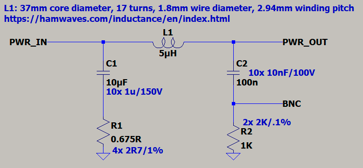

Schematic is deceptively simple. Basically CISPR25 circuit with exception of input capacitor capacitance which is 10uF ceramic capacitor in series with resistance 0.5 to 1 Ohm instead of just 1uF capacitor. This is helps to prevent "output impedance out of limits" issue when wiring inductance between power supply and LISN is above 0.1uH. This issue and its solution has been proposed somewhere in the mentioned EEVblog forum threads.
All capacitors consist from multiple units of same capacitance and package to enhance their high frequency properties (less parasitic equivalent series inductance, prevention of resonances and anti-resonances of the capacitors).
R1 actually consists from four 0805 resistors in parallel to achieve above 1W power dissipation rating. Its final exact resistance does not matter while in range from 0.5 to 1 Ohm.
All components (except L1) should be surface mount type to lower their parasitic properties impact to high frequency response.

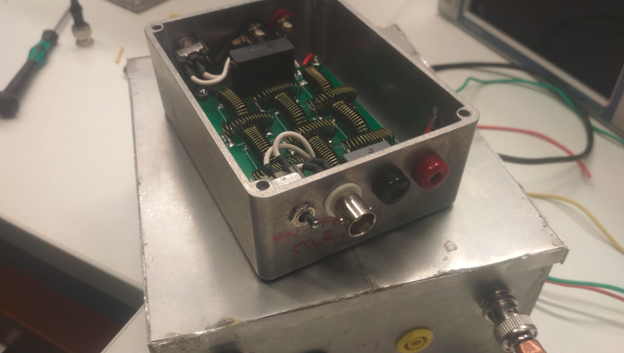

    My colleague lent me his DIY version of 5uH CISPR-25 LISN to measure and compare its performance – unit in smaller housing with many inductors in series to form total 5uH inductance.
    Output impedance measurement reveals CISPR-25 incompliance below 200kHz as well as earlier occurring incompliance above 30MHz. Due to its 1uF input capacitance it would be also impacted by power supply harness inductance issue as described in simulation project log.
    Insertion losses measurement reveals true weakness of this design. Its response is rather unpredictable. Instead of flat response above 1MHz, there are many depression peaks. I don’t think the measurement could be calibrated reliably for this behavior. Complex PCB with many inductors, that are coupled, is definitely not a good idea if you consider this.
    Channel isolation measurement on the other hand reveals how great idea is to have two separate units instead of one multi-channel. Low frequency cross-talk does not occur at all. Between 20 – 40MHz there is still a cross-talk above noise floor, which was not present on my unit. This could be caused by the same design issue as described in insertion losses measurement above.
    Overall, without tuning insertion losses to be flatter above 1MHz I would consider this construction as not reliable.

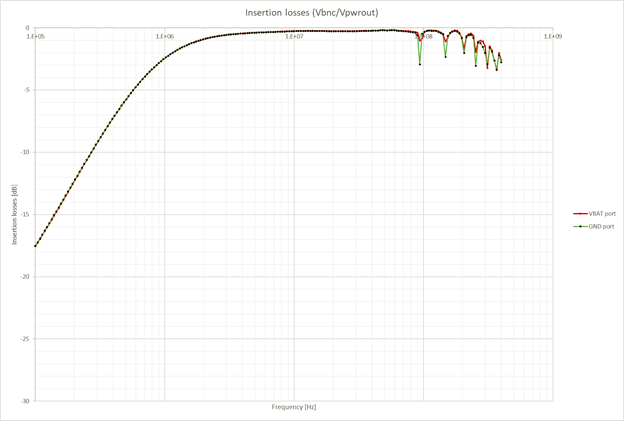

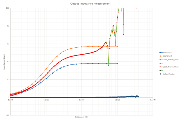

  • Validation measurement
    kevarek08/19/2021 at 19:31 0 comments

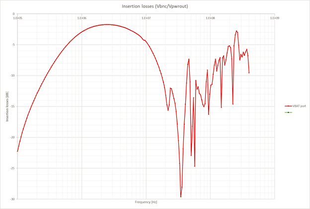

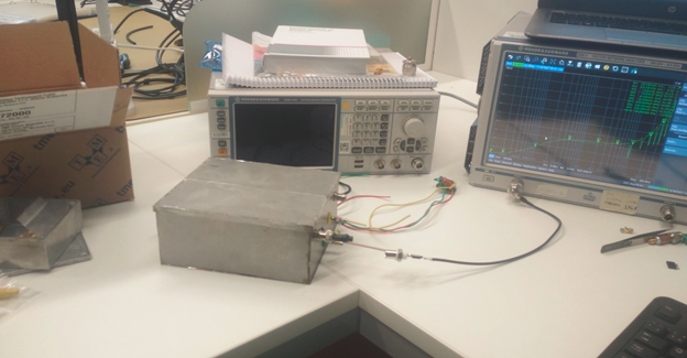

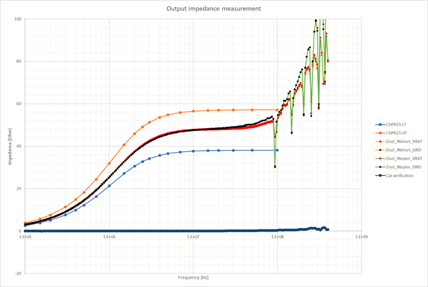

    Validation measurements were performed using Vector network analyzer (VNA) Rohde&Schwarz ZNB 8, 100kHz to 8.5GHz. This is my first VNA measurement so please be tolerant. Should I evaluate measurement validity and error sources my guess is that any measurement above 100MHz is invalid due to banana plugs being used. Actually I think that propper LISN manufacturers cheat their validations a bit by having SMA connectors directly in the units and connecting measurement equipment there. For test setups see simulation project log.
    Output impedance measurement confirmed that LISN is compliant to CISPR-25 requirements. I’m fairly confident that impedance drop between 90-10MHz is caused by banana connectors. Matches the simulation nicely.
    Measurement setup
    Insertion losses measurement again looks very nice and flat. Measurement below 10MHz does not match the simulation and I have no clue why. I believe there is some issue with units VNA vs LTSpice. This is my homework to explain. Measurement above 90MHz again affected by banana plugs.

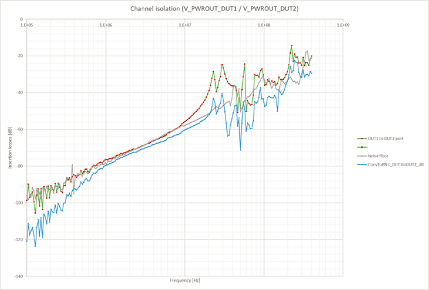

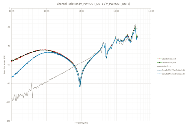

    Inter channel isolation measurement explains why it is a bad idea to place two channels into same box and why all respected manufacturers don’t do it. There is quite a high amount of crosstalk below 10MHz. This is caused by magnetic coupling of inductors through thin internal wall separating the channels. CISPR-16 requires less than -40dB though, so I consider this unit as fine.
    Long story short, after performance validation I consider this home-made CISPR-25 5uH LISN as success and based on measurement results, I release it for hobby use pre-compliance measurements 😊

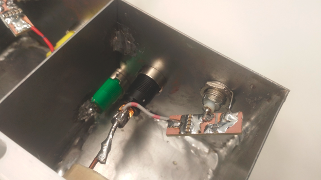

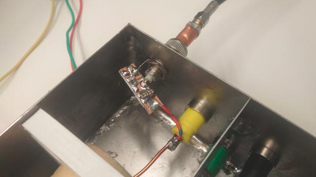

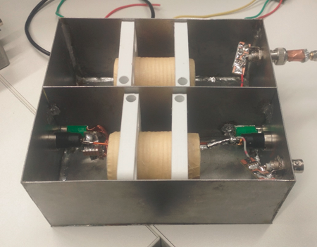

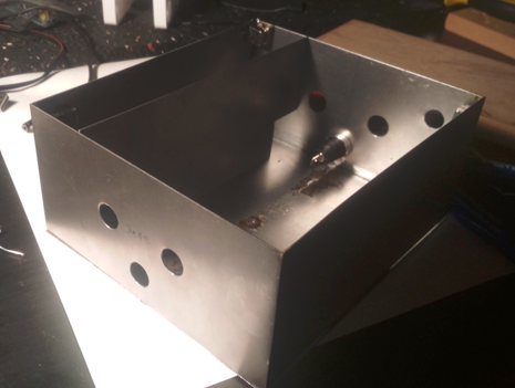

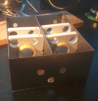

  • Assembly
    kevarek08/19/2021 at 18:17 0 comments

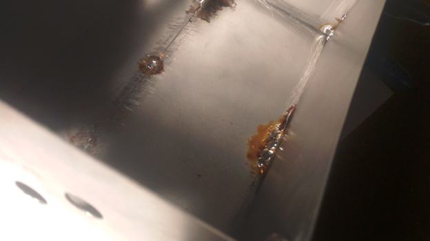

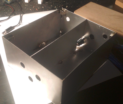

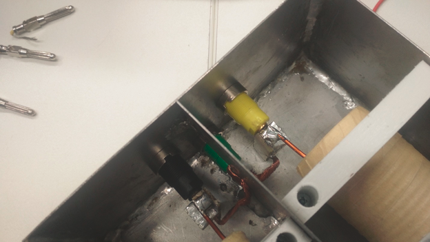

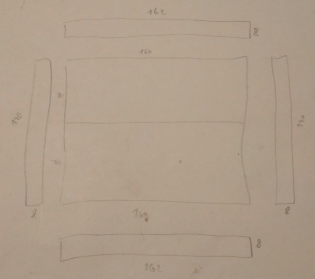

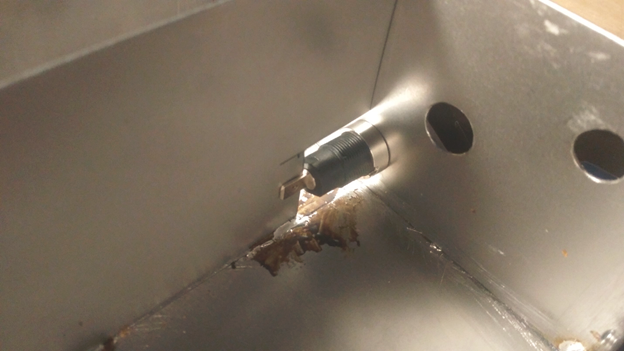

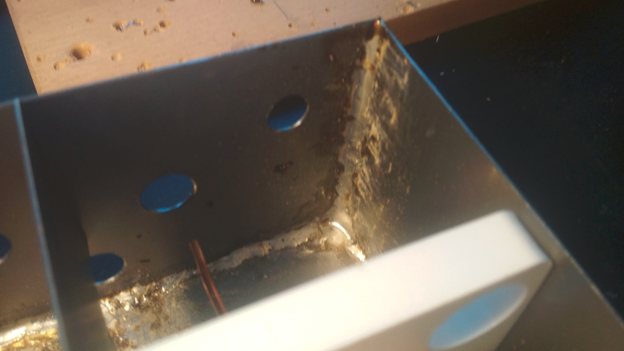

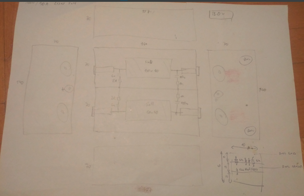

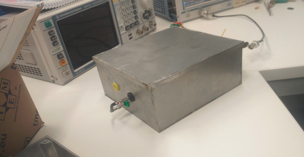

    Whole LISN was assembled into DIY metal box from solderable metal sheets 1mm thick, 70mm high and 1000mm long (rather permeable and very soft iron). I would recommend to make the box at least 50% bigger to allow greater inductor separation from walls. Reason for this will be clear after validation measurements. Should I build it again, I would create separate housing for each LISN as all the manufacturers do. There is a great reason for it!
    Sorry for very bad dimension drawings… this is what is available.
    Housing body
    Housing cover

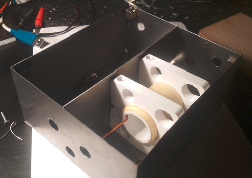

    All the parts were cut from sheet using bench scissors and soldered together. This took quite a lot of patience from my wife as quite a lot of solder flux smoke was released across our flat 😊

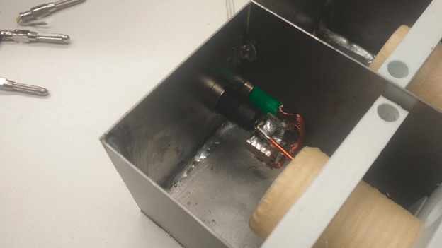

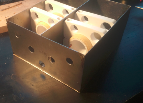

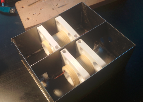

    Inductors were clamped into their spacers and mounted into the housing.

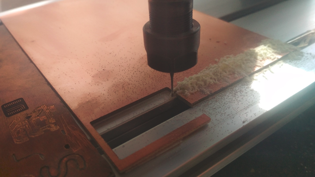

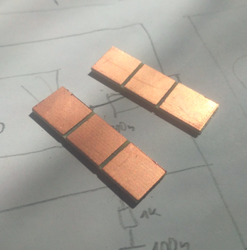

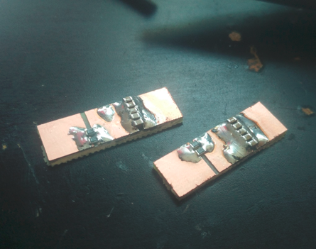

    Small PCBs for input and output capacitors and resistors were milled out of standard single layer PCB.
    Output side PCB with 100nF capacitor bank and 1K resistor.

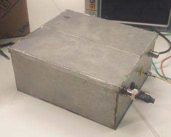

    Everything assembled
    Detail of output side PCB. Every centimeter of wire adds significant amount of undesired behavior above ~50MHz.
    Final product ready to be tested

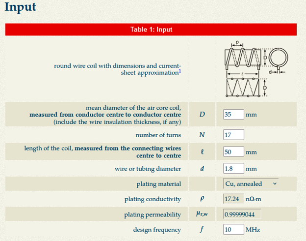

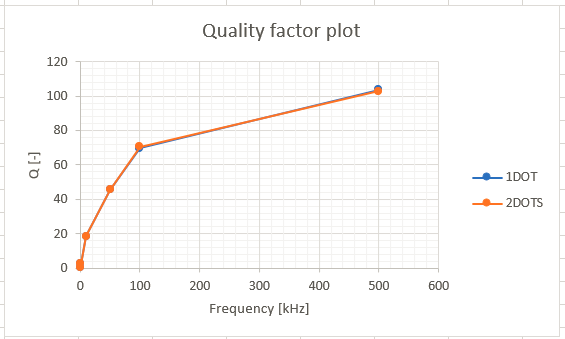

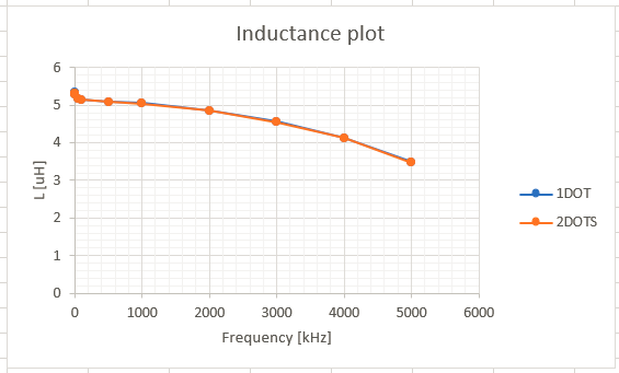

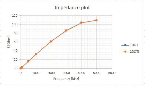

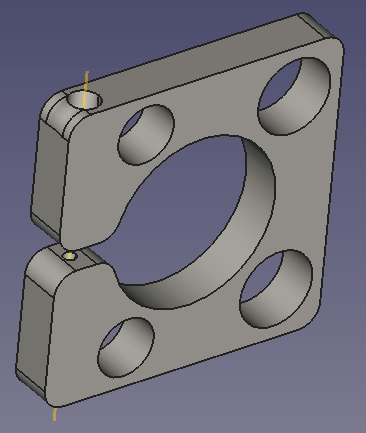

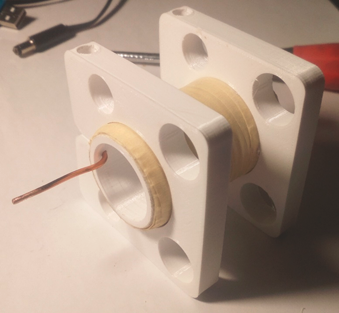

  • Air core 5uH inductors
    kevarek08/19/2021 at 17:32 0 comments

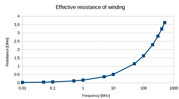

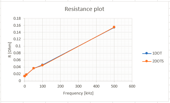

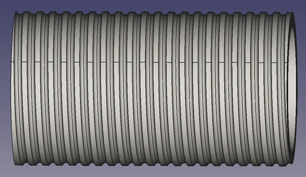

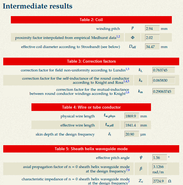

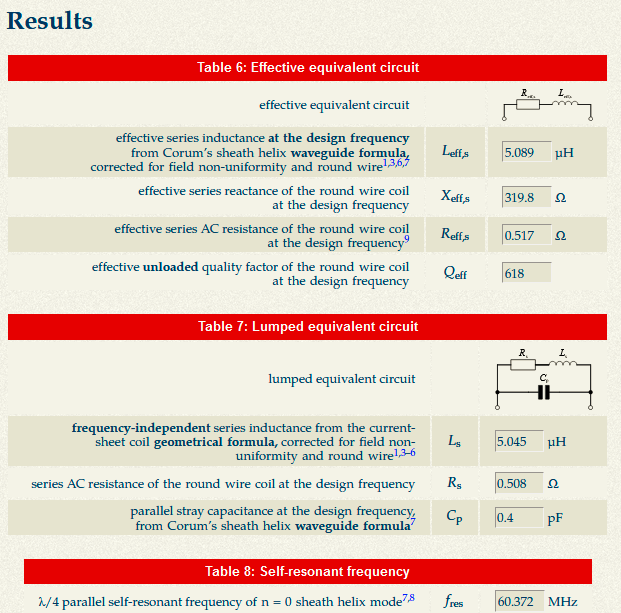

    Inductor L1 has been designed with following online calculator: https://hamwaves.com/inductance/en/index.html#input
    Aim was to achieve up to use copper wire thick enough to allow 30A RMS. Rule of thumb for the design is to keep its diameter D somewhat comparable to its length. Below is the calculator output that was used to model its plastic core for support.
    Just for fun I have plotted the windings effective series resistance considering also skin effect.
    Plastic core support to allow easy winding and good tolerances for both wound inductors.
    Plastic spacer and holder that keeps the coils centered within the housing.
    Assembled inductors were marked as 1DOT and 2DOTS and measured using LCR meter Kust LM1050A. Both seem to have almost identical parameters and good enough to be used for CISPR-25 5uH LISN.

  • Schematic
    kevarek08/19/2021 at 15:18 0 comments
    I decided not to implement standard 10dB attenuator to keep it simple, but plan is to build is as external unit later. This also helps to keep the validation and root cause analysis of possible issues simpler.
