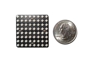

    Solder NeoPixel
    These pcb NeoPixels have pads on their underside, therefore making it impossible to solder them to the flat service of the badge. To circumvent this solder some metal rods to the pads. Make wires a little longer to cut to size later for easier placement.
    Place the NeoPixel on the SMD part of the badge so it is as much center as possible. Though this also doesn't need to be perfect since the bubble goes on top and will diffuse the light anyway.
