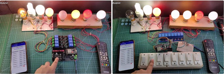

Testing the Circuit Before Designing the PCB:

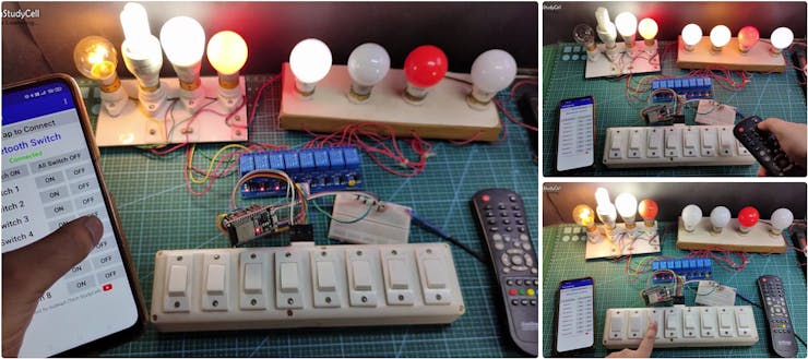

Before designing the PCB, I have made the complete circuit using ESP32, an 8-channel relay module, and manual switches.
As you can see, the relays can be controlled from the Bluetooth app, IR remote, and manual switches. You don't need any WiFi for this ESP32 project.

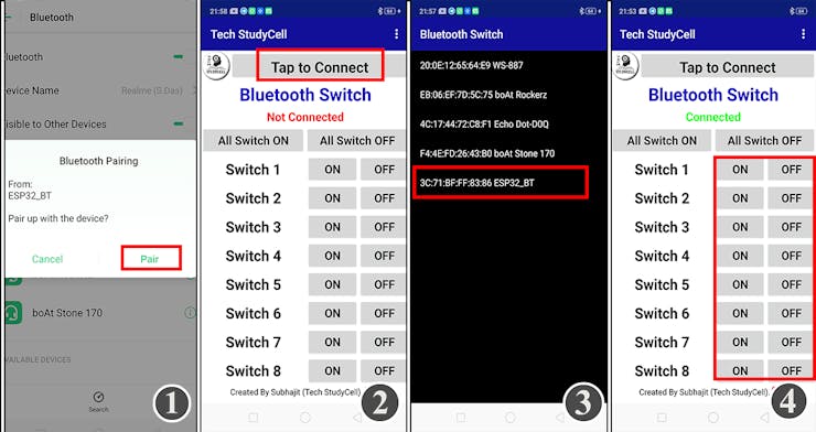

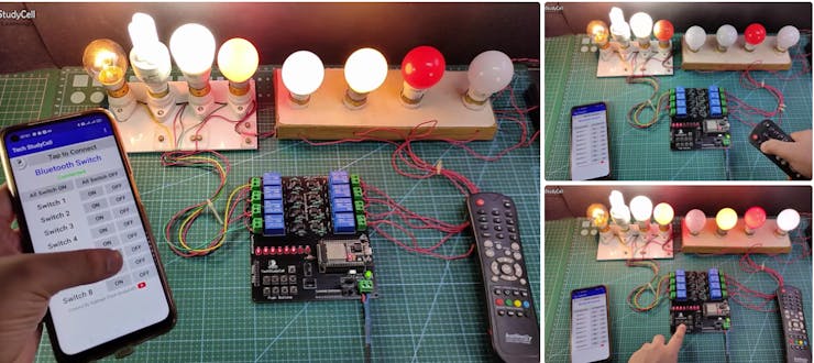

Control Relays Using Bluetooth App:
After pairing the ESP32 with mobile Bluetooth, you can easily control the relays from the Bluetooth App.
I have made this Bluetooth app in MIT app inventor. The app is simple and easy to use.
You can download the app from the following link.
https://github.com/techstudycell/ESP32-Bluetooth-Home-Automation-with-IR-Remote-Control-Relay/tree/main/Bluetooth_Switch_V1_App
ESP32 Control Relay With IR Remote:
You can always control the relays from the IR remote. For this project, you can use any IR remote.
I will explain how to get the IR codes (HEX codes) from any remote in the following steps.
Control Relays Manually With Switches:
For this project, you can use both switches or push buttons.
If you want to use switch (latched), then upload the source code for switches.
And for the push button upload the source code for the manual button.
Both source codes are shared in this article.

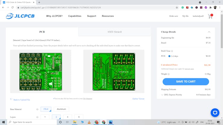

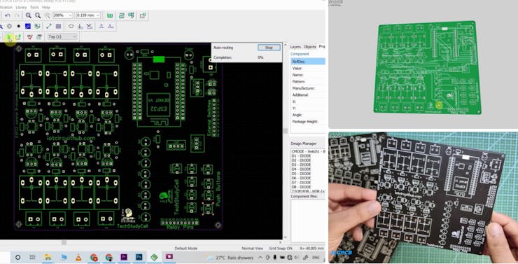

Designing the PCB for ESP32 Projects:
To make the circuit compact and give a professional look, I have designed the PCB after testing all the features of the smart relay module on the breadboard.
You can download the PCB Gerber file of this home automation project from the following link:
Download the PCB Gerber File

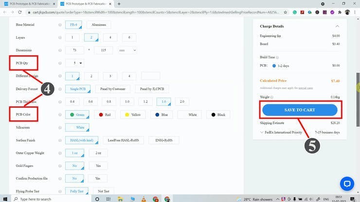

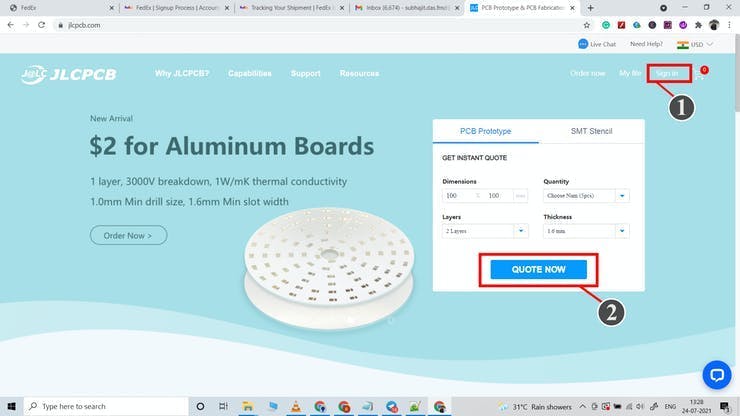

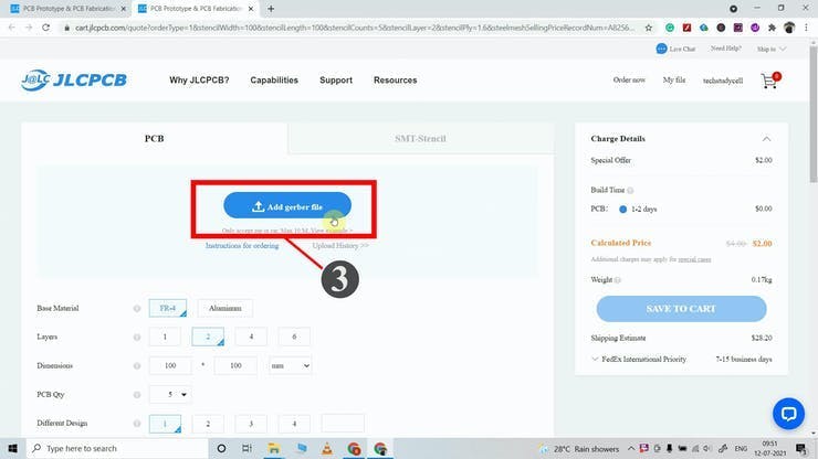

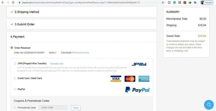

Order the PCB from JLCPCB:
After downloading the Garber file you can easily order the PCB
1. Visit https://jlcpcb.com and Sign in / Sign up
2. Click on the QUOTE NOW button.
3. Click on the "Add Gerber file" button. Then browse and select the Gerber file you have downloaded.
Uploading the Gerber File and Set the Parameters
4. Set the required parameter like Quantity, PCB masking color, etc.
5. After selecting all the Parameters for PCB click on SAVE TO CART button.
Select Shipping Address and Payment Mode
6. Type the Shipping Address.
7. Select the Shipping Method suitable for you.
8. Submit the order and proceed with the payment.
You can also track your order from the JLCPCB.com

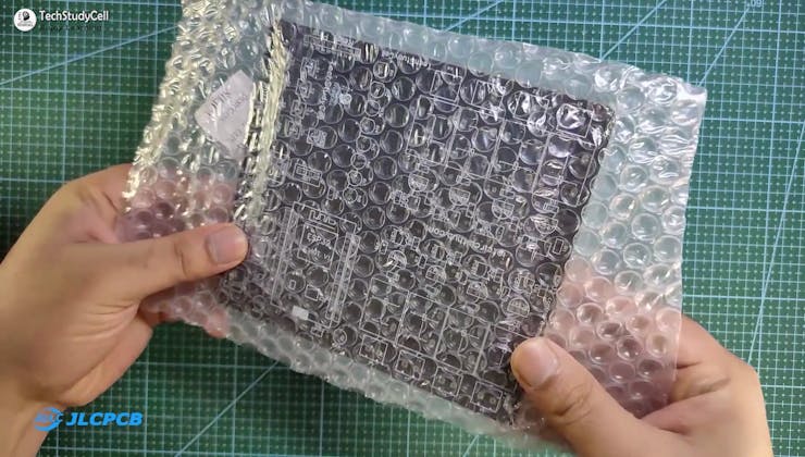

My PCBs took 2 days to get manufactured and arrived within a week using the DHL delivery option.
PCBs were well packed and the quality was really good at this affordable price.

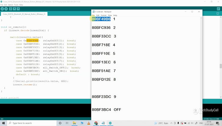

Get the IR Codes (HEX Code) From Remote:
Now, to get the HEX codes from the remote, first, we have to connect the IR receiver output pin with GPIO D35.
And give the 5V across the VCC and GND. The IR receiver must have a metallic casing, otherwise, you may face issues.
Download the code for getting the HEX codes:
https://drive.google.com/file/d/1MLJ96CQN3wOuu6iWArsMq9rKsKR5Z3Xi/view?usp=sharing
Then follow the following steps to get the HEX codes
Save all the HEX codes in a text file.

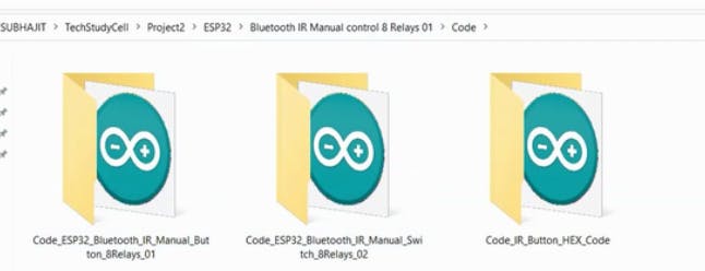

Codes for the ESP32 (Bluetooth + IR) Home Automation:
If you use switch (Latched) then refer to the code for Switch, and for momentary switch please use the code for the pushbutton.
Download and install the following libraries in Arduino IDE
AceButton Library: https://github.com/bxparks/AceButton
IRremote library: https://github.com/Arduino-IRremote/Arduino-IRremote

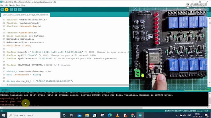

Program the ESP32 With Arduino IDE:
Here, I have given the ESP32 Bluetooth name as "ESP32_BT". To change the name update the following line in void setup().
SerialBT.begin("ESP32_BT"); //Bluetooth device name
Then update the HEX code in the ir_remote function as shown in the tutorial video.
After that, select the DOIT ESP32 DEVKIT V1 board and proper PORT.
Then upload the code to ESP32 Board.
While uploading the code to ESP32, if you see the "Connecting....___" text, then press the BOOT button of the ESP32.

Connect the Bluetooth App With ESP32:
I have designed the Bluetooth Switch App in MIT App Inventor for this ESP32 Bluetooth project.
Please download and install the Bluetooth App (APK file attached), then you have to connect the Bluetooth App with ESP32.
Download Bluetooth App for the ESP32 Bluetooth project
https://drive.google.com/file/d/1IpKthi5wDD9kDJduudfDiAPXp15MMDYo/view?usp=sharing

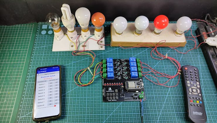

Finally!! the ESP32 Home Automation System Is Ready:
Now you can control your home appliances in a smart way.
I hope you have liked this ESP32 Bluetooth home automation project. I have shared all the required information for this project.
