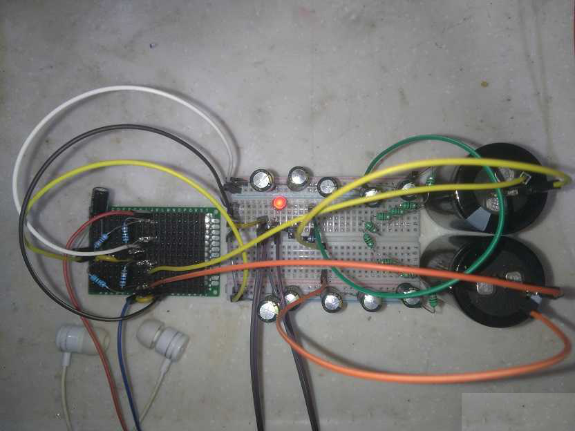

β is the magnification, r_be is the base-emitter internal resistance, and R_L is the load resistance. Use this formula to get the value of collector resistance Rc. Here Rc is 180Ω. It should be reminded: circuit production requires patience to adjust the value. However, the best value of each component is still traceable. Under normal circumstances, most components can be fixed, and only one or a few component values can be adjusted at a time. Because it needs to be adjusted all the time, it is not suitable for soldering. You can use breadboard or Tianzi circuit board.
1. Use a multimeter. It is possible to measure the current and voltage changes at various positions of the circuit during component adjustment. First, ensure that the voltage of the BE pole starts to oscillate, and then ensure that the voltage across C1 starts to oscillate.
2. Use LED light-emitting diodes. The LED must have a certain turn-on voltage, so it should be connected in parallel with C1 at both ends of C1 as a load. The LED can display continuous changes in voltage, which is reflected in the gradual brightening and gradual dimming of the LED. A 10Ω resistor can be connected in series to adjust the average brightness to make the brightness obvious.
3. Use the earphone speaker. A small resistor in series with the earphone speaker is also connected as a load at both ends of C1 and connected in parallel with C1. You can hear a "plop" sound like a heartbeat. A 100Ω resistor should be connected in series to prevent excessive current. For small oscillations, the LED cannot display it. At this time, the small sound of the oscillation can be heard with the horn. In addition, the speaker can more easily hear the frequency change. This is especially useful when replacing the multimeter with an LED and speaker load, and when adjusting the bypass capacitor Ce. It is possible to hear the meter pen or Ce end before and after taking it out. , Even after taking it out, the oscillating frequency changes when the distance gradually increases or decreases. This phenomenon helps to find the value of components with stable oscillation frequency.
The base resistances Rb1 and Rb2 should be larger in order to ensure a smaller base current. Here are 75KΩ and 200KΩ respectively.
The emitter resistance Re can be a smaller value under normal circumstances, such as 10Ω.
For the coupling capacitor C3, for 1Hz oscillation, a larger value, such as 220μF, should be selected to pass the AC component close to DC.
The function of the bypass capacitor Ce is to quickly bypass the AC component to the ground. Therefore, for the 1Hz oscillation, a large value should be selected in the same way. What is used here is a capacitor formed by connecting two large 10mF capacitors in series. One end is connected to the E pole, and the other end is grounded. 6. 1Hz oscillation circuit!
Add sound and light load (speaker beats, LED flashing)!
