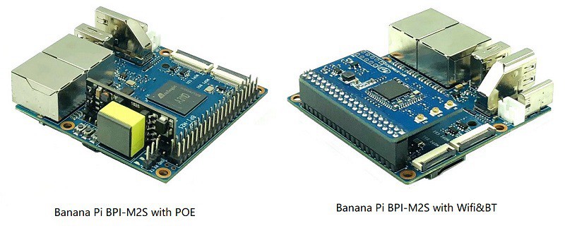

hardware inerface:
![BPI-F2S%20interface|653x499](upload://fFer5Ngoqi26wg9senMvlDY1GXS.jpeg)
PoE  Wifi&BT support
