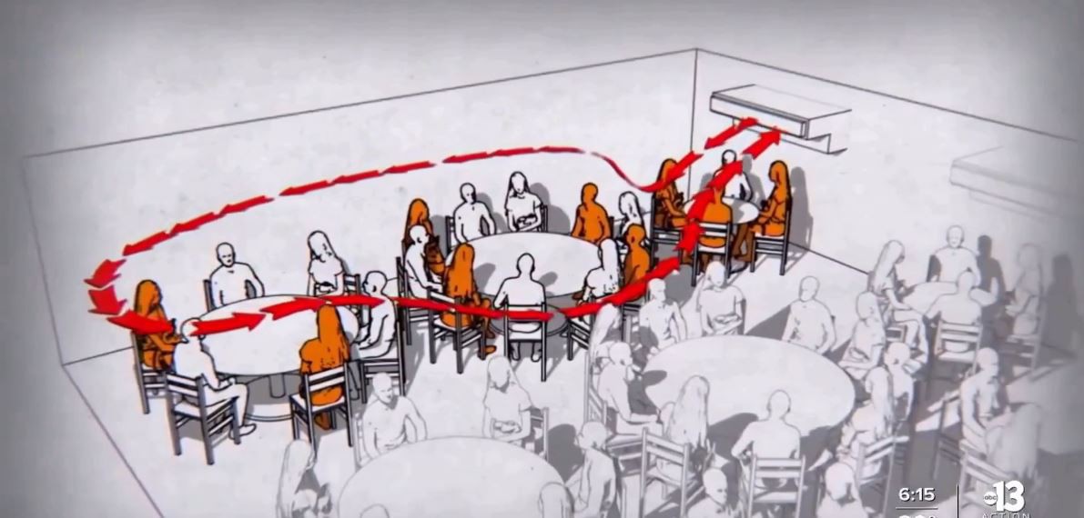

 Ventilators are very important equipments in an indoor environment. They help us stay cool, warm and breathe filtered air. But the very device we relay up on to keep us safe from air bourn pandemic have become the major liability because indoor air filtration system before filtering the air will help the virus move from one place to another on the process of air circulation. In an indoor café, restaurant, school or office, people sit in rows and columns separated by desks or tables. If one person sitting on the last bench has the COVID-19 virus and the air filtration inlet is on the other side of the person infected with the COVID19, the ventilation system will make the COVID-19 virus found on the exhaled air of the infected person travel all over the room because of the inevitable circulation characteristics of the system. This problem has been found and reported in many indoors in many countries of the world during this short period of time.

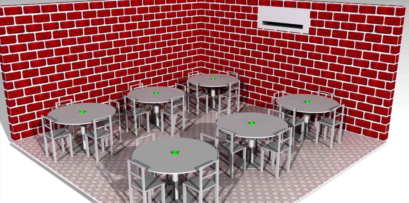

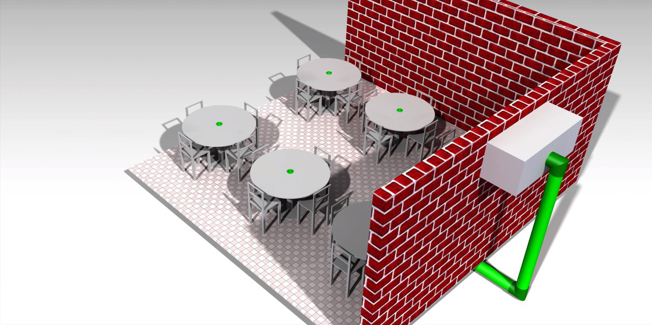

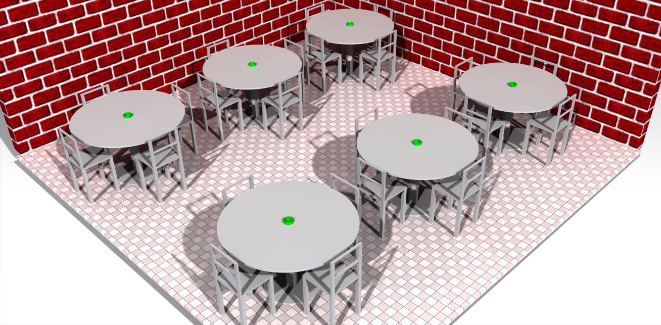

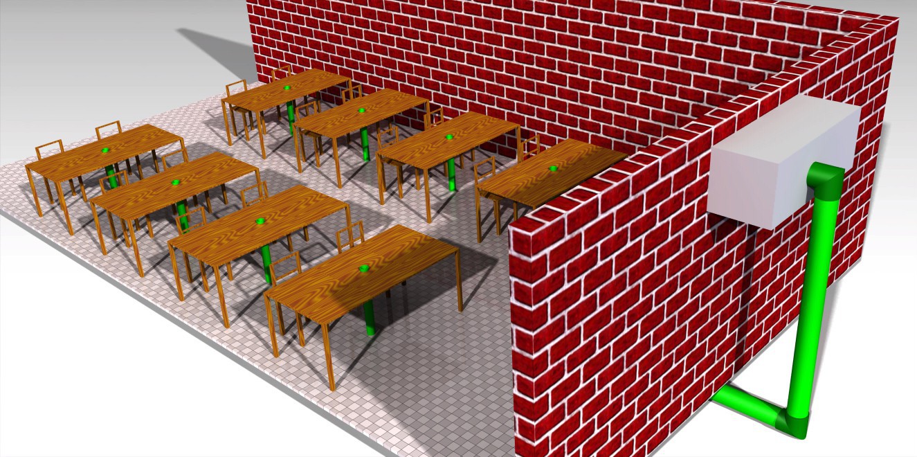

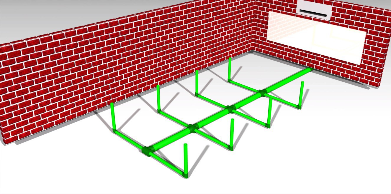

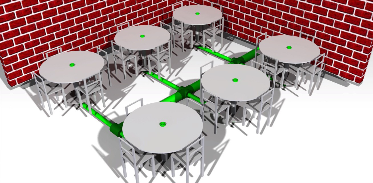

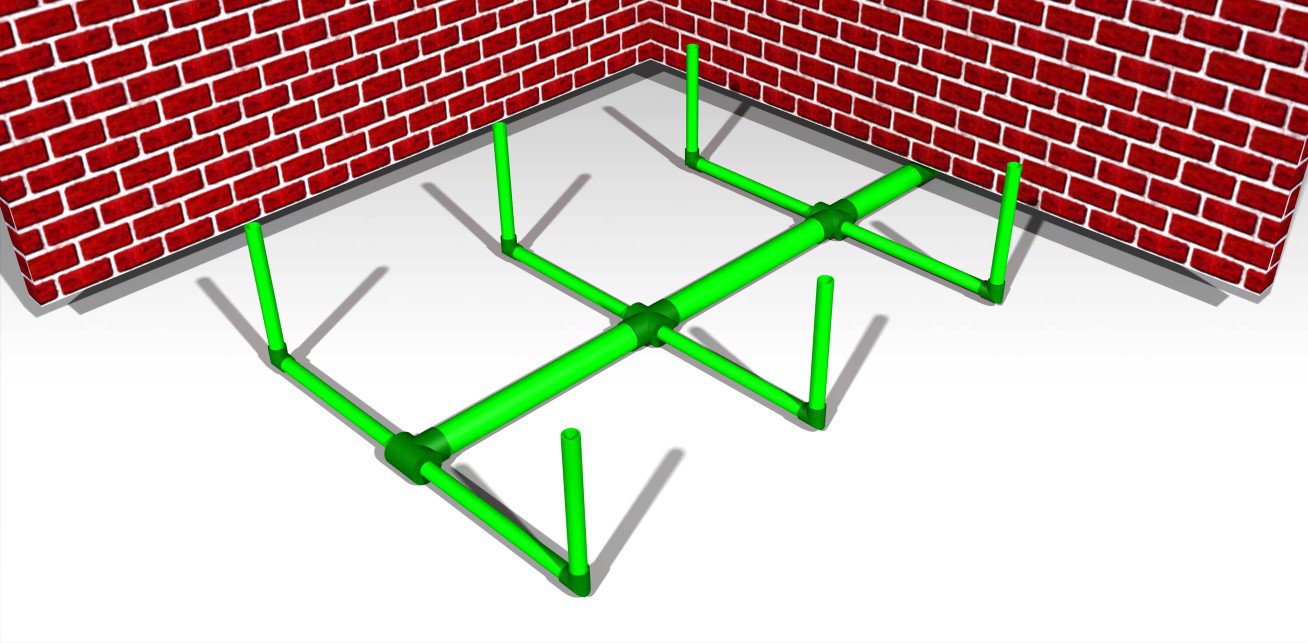

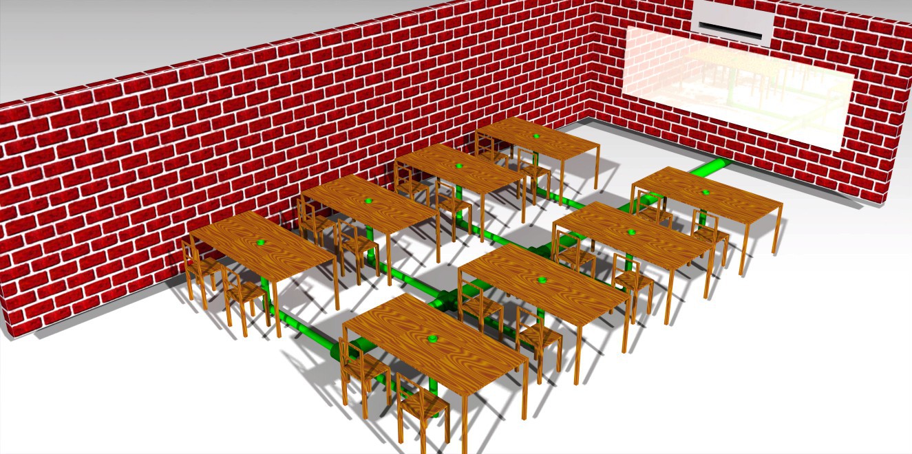

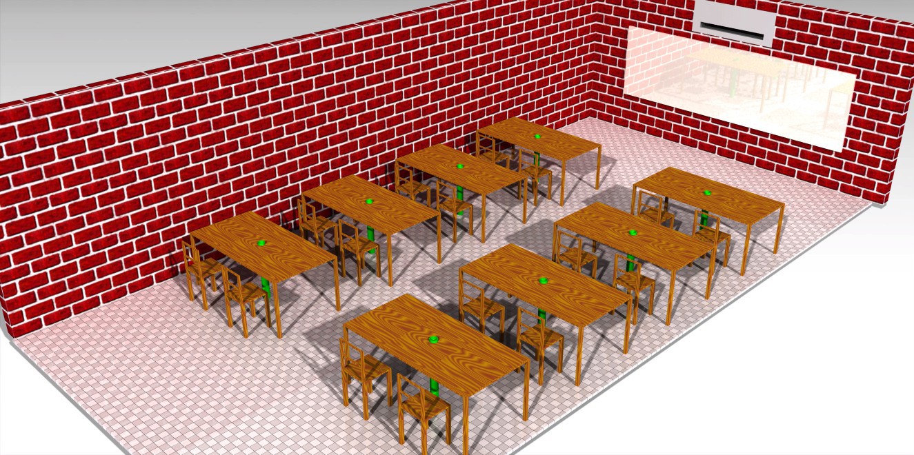

I have built new kind of ventilation system for indoor that prevents transmission of COVID through air circulation due to ventilation equipments that help us stay cool. This is done by separating the circulation process of air filtration by taking out exhaled air through different path from the path it originally came after it is filtered by using multiple small suction hoses or pipes installed at different positions which will prevent the exhaled air travel from one side of the room to another spreading the COVID virus before it is filtered in ventilation system. We install one suction pipe in each desk or table in gathering indoor places like café, restaurant, school and office. Each suction pipes are connected to each other to be directed in to a header. The header will be connected to an exhaust fan which will be connected to the room air filtration system. When a person sitting in a specific table breaths out, the exhaled air will be sucked into the suction pipe on that specific table preventing any chance of infection to the person sitting on the next table who is in the way of the air circulation path to the ventilation equipment.
When one or multiple desks or tables with installed suction hose or pipe are not being used because no one is sitting in that spot, there is a valve that closes the pipe or hose opening. This will save power consumption and it will increase the suction capacity of the other tables because the closed pipes will be vacuumed.

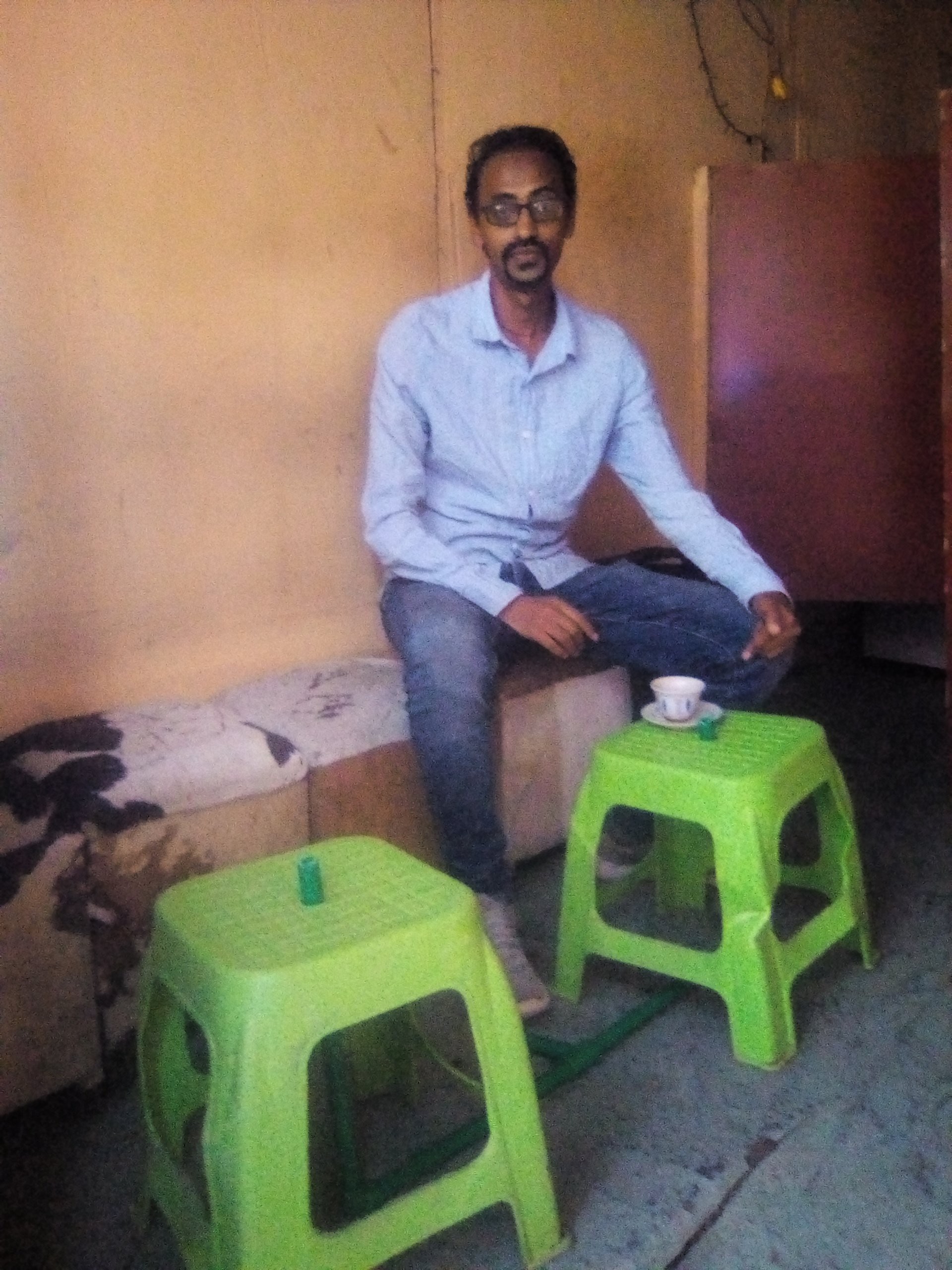

    Anteneh Gashaw10/24/2021 at 08:16 0 comments

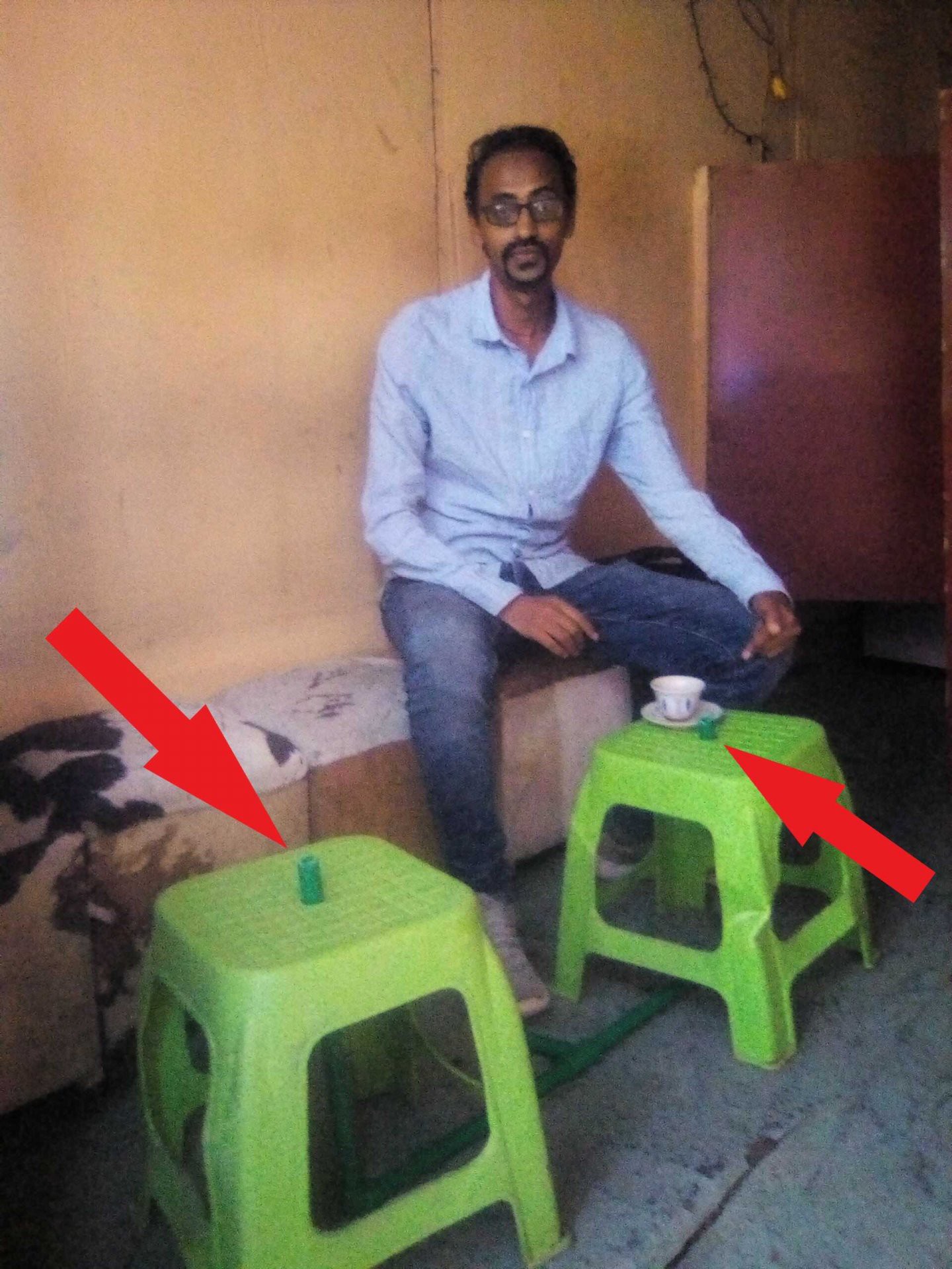

    In phase two of this project the second prototype of Anteneh's Ventilation against COVID-19 will be implemented in medium cafe or school room. The air suction capacity will be seen visually because a distinctive different colored smokes will be released from each table so that any one can see each smokes released from each table will be sucked completely in their respective table through the suction mechanism installed. This will be very important step to prove the mechanism efficiency via a visual means.
