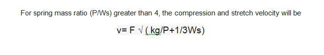

This project is about building new kind of building stairs that is very accessible for wheelchair users in case of emergency to evacuate the premises. This is done by combining a ramp with spring system to continuously adjust the slope of the stairs. The main impossible challenge of building a ramp in building stairs is because the slope will be too high and adjusting to the right angle will not be possible because of distance limitation. But this simple mechanism will solve this problem by using a mass spring system to adjust the slope of the ramp at all times. Meaning, the maximum slope for a ramp is 18 degrees which this mechanism has and a person with a wheelchair will go down in case of emergency without any problem or a need of additional evacuation equipment by themselves. As the wheelchair user reaches to the end of the 18 degree slope he/she will be at the top of a mass spring that compresses when a load F is applied on it with lower velocity V. This will enable them to reach the final tread of the stair completing the floor riser. As they step off the ramp, the spring will stretch attaining its original height for others to do the same task. All the wheelchair users have to do it repeat the same process until the ground level evacuating without any help of any kind.  The ramps can also be used by for all people including physically normal people and all kind of physically disabled people because in case of emergencies running in the stairs is a bit dangerous if one is not careful and slope grounds are better that stairs when travelling at fast pace. When the ramp is not being used for emergency it can be attached to the hand rail of the stairs.
The main design calculations are focused on the spring load system and the joints. The calculation of spring rate is linear on extension and compression springs; unlike torsion springs where the force is radial. Knowing our spring rate will determine if our spring will function correctly under your working loads. The formulas shown below will explain just how to calculate our compression and extension spring rate.

Frederico Klopffleisch wrote 10/26/2021 at 11:46 point
hey Anteneh,
Nice ideia, having wheelchair users in my family i know this is always a concern. But two questions came to my mind while reading:
1 - How you intend to prevent the user being catapulted or receiving a blow in the back when leaving the ramp? Those will bem some powerfull springs
2 - How do you compensate for horizontal displacement when lowering?
Anteneh Gashaw wrote 10/26/2021 at 13:23 point
@Frederico Klopffleisch  great questions.
1. I am planning to use a hydraulic system instead of the spring because it's way better to control. A hydraulic system will provide a smoother system than a standard spring system, but it won't be as smooth as air. Basically, the hydraulic system is right in the middle between the two. The only real benefit to a hydraulic system is that it is customizable.
2. I am planning to use slider at some point of the ramp to compensate the horizontal displacement.
