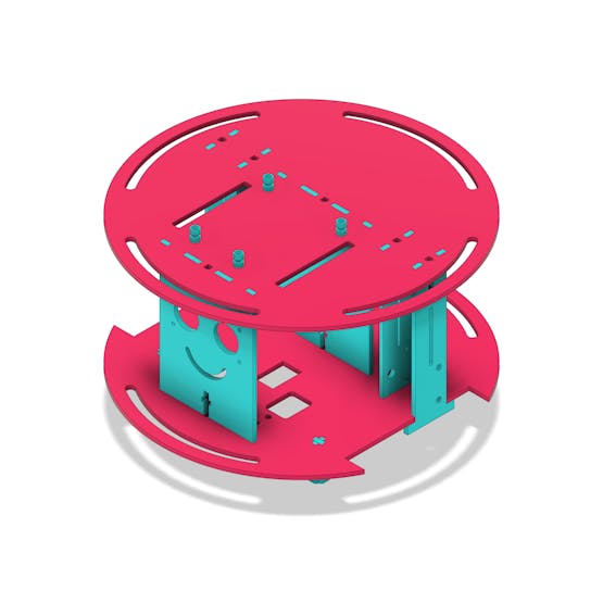

Figure 3A - 2-Wheel Mobile Robot Chassis complete frame.
Figure 3b - Mobile Robot Chassis with electronic elements.Figure 3C - Part of the base of the 2-wheel mobile robot.Figura 3D - Part from the upper region of the mobile robot.Figura 3E - Part for fixing the Mobile Robot ultrasonic sensor.Figure 3F - Part for fixing the motor drive driver.Figure 3G - Spacers for fixing the parts of the base and top cover of the mobile robot.
The chassis structure of the mobile robot is formed by a set of 14 pieces. Next, we will discuss the purpose of each.
  • Figure 3A shows the complete chassis structure of the 2-wheel mobile robot.
  • Figure 3B shows the structure of the 2-wheel mobile robot chassis with all peripheral devices installed.

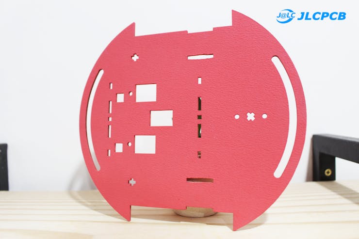

  • Figure 3C is the base piece of the mobile robot. It is used for fixing various elements. These elements will be presented in the next topics.
  • Figure 3D is the top cover piece of the mobile robot. The Arduino UNO will be installed in it.
  • Figure 3E is the piece for fixing the ultrasonic sensor for detecting obstacles during mobile robot navigation.
  • Figure 3F is the part for fixing the L293D driver, which will be used to drive the robot's wheel motors.
  • Figure 3G are the structures that act as spacers for the base and top cover pieces. In addition, they are used for fixing robot motors.

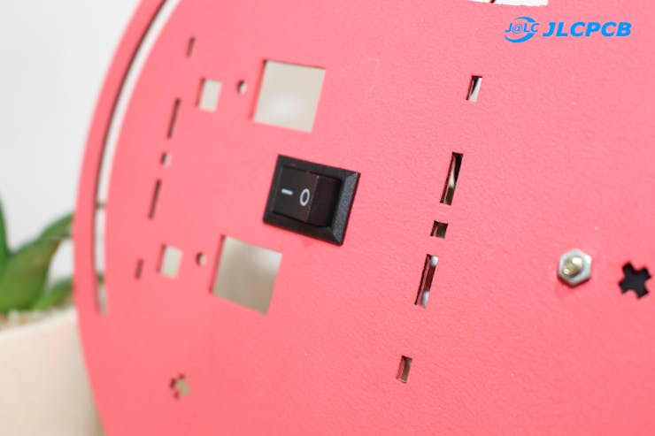

In each part of the structure, several elements were added to add functionalities to the mobile robot. Among them, we have a button to turn the mobile robot on and off.
Button to turn the robot on and off
Most mobile robot chassis do not have a structure for attaching a button. We fixed the button in the base region. Through this button, we can turn our robot on and off.
Figure 4A - View of the button in the lower region of the mobile robot base piece.Figure 4B - Base piece with cutout for fixing the ON/OFF button.
Figure 4C - Top view of base piece with button attached.
In the figure above, it is possible to observe the button fixed at the place where the piece was cut.
