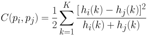

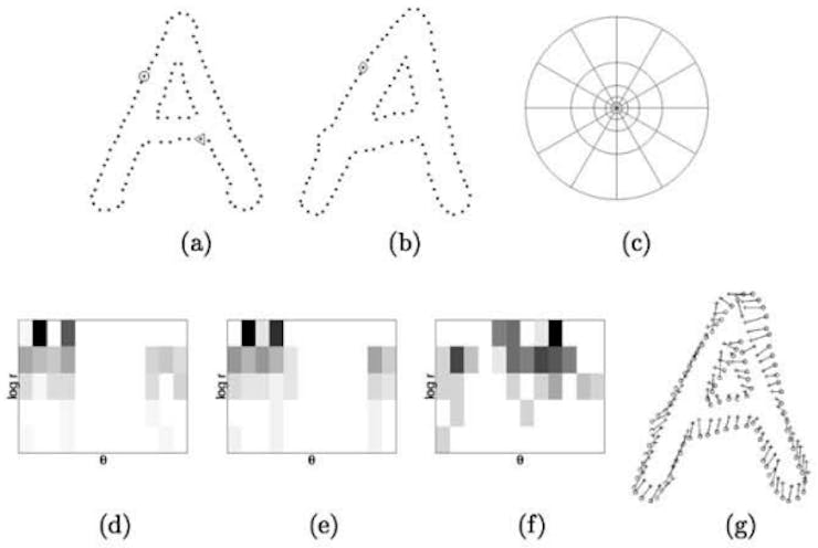

The mathematical descriptor known as Shape Context uses log-polar histograms to encode relative shape information. This can be used to extract alphabet shapes from an image efficiently. The implemented algorithm is as below.
                                                                                             Pearsons Chi-squared Test
                                      (a-b) Sampled Pts (c) Log-Bin Histogram (d-f) Shape Contexts (g) Pointwise Correspondence
  • To identify an alphabet or numeral, find character contours in an image. Filter out the contours based on size and shape to keep the relevant ones.
  • Compare contours with each shape inside the base image. The base image contains all the potential characters, both alphabets, and numerals.
  • Find the character with the lowest histogram match score
  • Do the above for all character contours, to extract the whole text.
